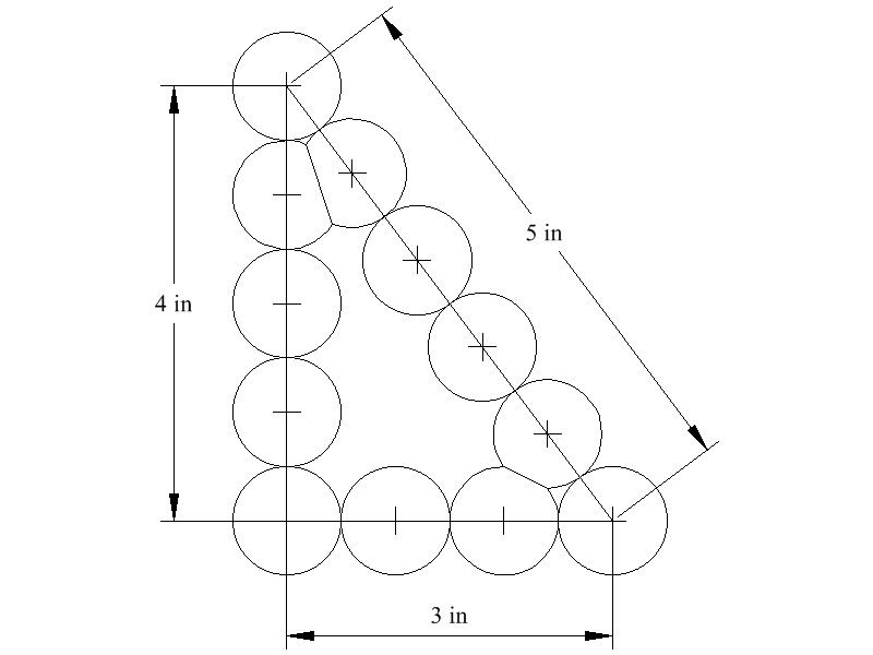

      For Harold Hall and anyone else interested here is a composite of previous postings relating to making accurate reference squares :
      (1) To make a 3-4-5 toolmakers button square :
      Make some identical rollers say 1inch diameter drilled big clearance for cap screws about 6 mm dia .
      On a sutably shaped steel plate mark out and drill holes at 1 inch pitch in the 3-4-5 (nb)configuration . Do the marking and drilling as accurately as possible but final accuracy of the square does not depend on exact accuracy of spacings . Tap each hole 6mm .
      nb : note that rollers are counted on an edge as one more than the number of pitches – so for instance the five side has six rollers to get 5 pitches .
      Position  rollers on the edge with the ' 5 ' edge and arrange them to touch each other and touch a straight edge . Obtain best accuracy and lock down screws . By trial and error position the remaining rollers in the remaining holes so that they touch each other , the end rollers of the '5' row and a straight edge tested along each side . Lock down all remainining screws .
      With all rollers along each side touching and also touching the straight edge(s) an almost exact 3-4-5 triangle is formed and the 90 deg angle is accurate to typically 0.0002 inch in 10 inches .
      Sounds difficult but with the basic parts made beforehand takes about 20 minutes to assemble .
      A developed version of the same basic idea can be used to set out other angles and make master dividing plates .
      The 3-4-5 method of making squares is an a example of an 'absolute' method – that is you don't need to know the exact dimensions of the rollers – only that they are the same .
      When laying out patterns with rollers it is usually nescessary to cut parts of the rollers away so that they don't interfere in unplanned places – other than that it is dead simple to do .
      A non absolute but perfectly practical alternative way of doing the samething is to just use rollers at the corners and separate them with accurately made rectangular bars of calculated length .
      The common sine bar uses essentially the same principle .
      (2) Another absolute method is to make 3 ordinary squares but with hinged blades . By testing them all against each other on a straight edge and adjusting so that they all touch full length on the blades in any combination you end up with three perfect 90 deg squares .
      Its a bit tricky to make three ordinary squares with narrow blades by scraping and testing against each other on a surface plate . More usually three angle plates are made with faces at least 20 mm wide .
      (3) Super precision cylindrical squares are made by turning and grinding the cylinder surface to best accuracy and then dividing the length into numerous zones and hand finishing each zone to be exactly the same diameter . Each zone is usually separated by a cylindrical V groove . Again this is an absolute method – you don't need to know the exact diameter of the cylinder- only that all the zones are the same diameter . Hand finishing is usually done by lapping but for home workshop a fine slip stone would do perfectly well .
      The base seating end of the cylinder is always finished at the same setting as the cylindrical surface and again is usually hand lapped for flatness .
      (4) The cylindrical square has a rarely seen but perfectly practical inverse – basically a faceplate with a smaller diameter true bar coming out from the centre of it . Can be turned from solid or made in two parts . Very easy to make in small sizes .
      A type of precision toolmakers square is similar and uses a precision round bar inserted into a hole in a rectangular bar .
      Michael Williams .

          #112553
          MICHAEL WILLIAMS
            @michaelwilliams41215

                Wow, that's really interesting. The picture helps too. Thanks Michael.
                Now I get the method I can also see how to make a 60 degree 'square' with three buttons and a 30 degree one with four, arranged in a diamond, then removing one button.

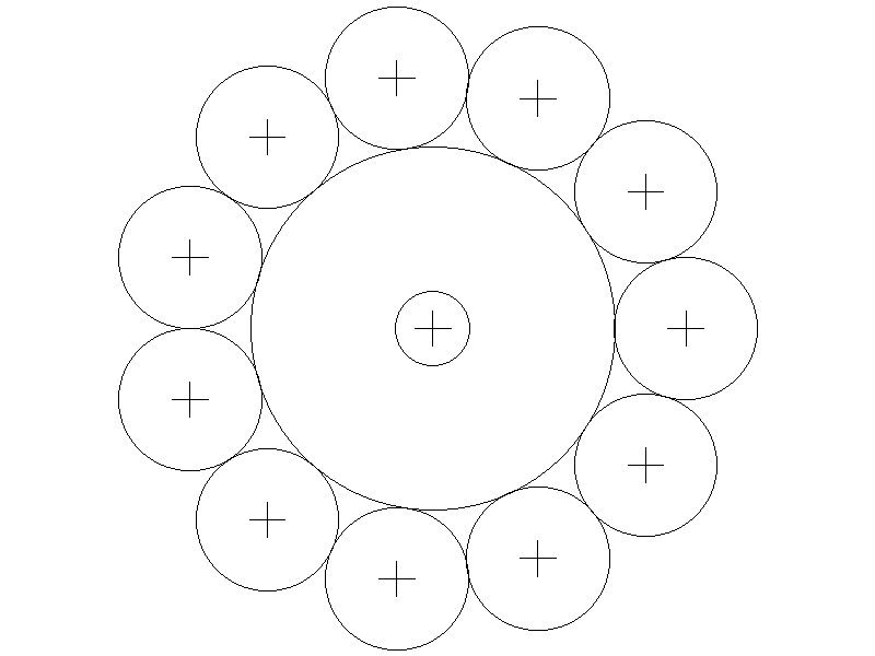

                                          #112773
                                          MICHAEL WILLIAMS
                                            Making master index plates .
                                            General procedure as for the 3-4-5 square but this time a round backplate with ring of holes for the rollers and rollers themselves touch a disc rather than a straightedge .
                                            Arrange means such as centre dowel and few small screws so that centre disc can be aligned with backplate and held in place .
                                            Turn centre disc to calculated diameter plus a few thou over .
                                            Assemble centre disc to backplate and then assemble rollers – bedding each one against the previous and against the centre disc . Lightly do up holding screws .
                                            Between the first and last assembled rollers there will be a gap . Measure gap and calculate how much centre disc has to be skimmed to close gap exactly . Skim centre disc . Best to proceed slowly and have two or three reductions – each one progressively finer .
                                            Feeler gauges and Blue can be useful but often work can be done with nothing more than ' feel ' .
                                            Reassemble with newly sized centre disc and all rollers . Choose a different roller as the last one assembled . All rollers should now be touching each other and centre disc . Test and verify – small corrections are possible but seldom needed . Keep everything very clean – no swarf and no oil for final assembly and check . Light oil afterwards . Centre disc could be removed but usually left in place .
                                            As a final check – clock over all the rollers to make sure that there isn't one standing proud .
                                            Master plates for any number of index positions can be made this way . Can be used for any purpose but particularly useful for prime numbers . Usually master is used to make ordinary working index plates for day to day use ..
                                            Regards ,
                                            Michael Williams .
                                            Here is what a plate for eleven index positions would look like :
                                            Edited By David Clark 1 on 24/02/2013 10:38:24
