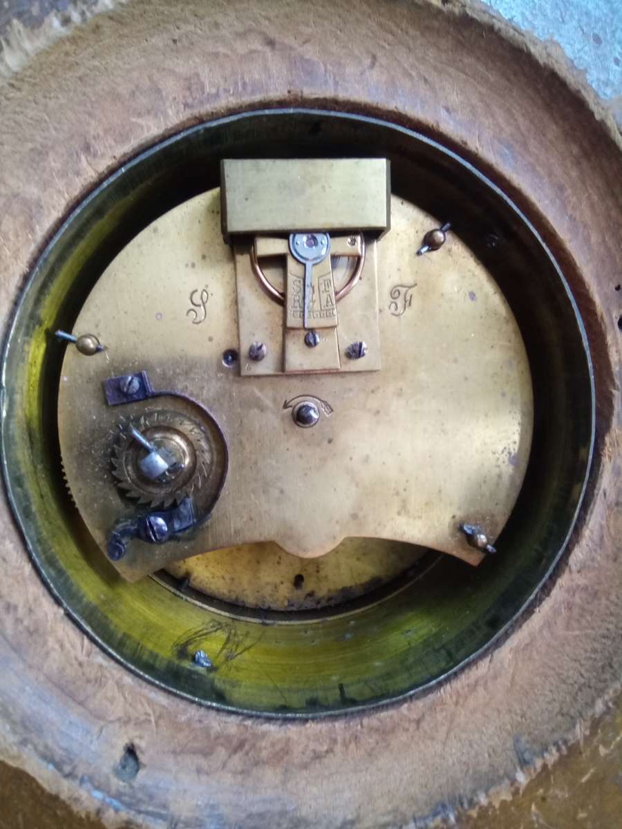

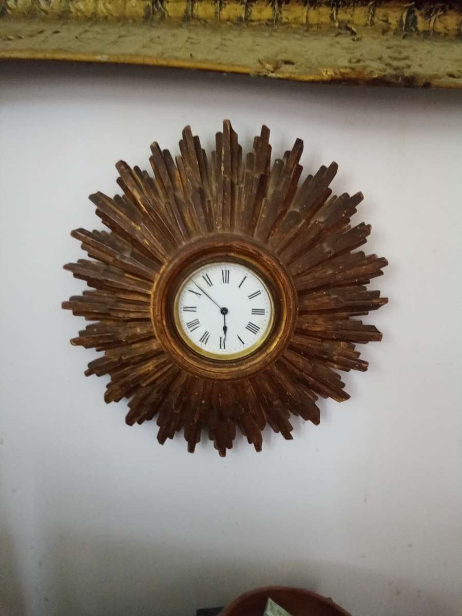

      This evening I was winding an eight day clock i own when there was a bang, the sound of something unravelling, and resistance to turning the key ceased. I guess the mainspring has broken (or maybe come undone somehow).
      Since a chap really should know how to mend a broken clock, does anyone have any suggestions for a book on the subject?
      Here are a couple of pics of the clock in question:
      20250824_18063920250824_180715

            Yes it sounds like the spring has broken. A word of warning platform escapements need careful handling. I think you need to find a friendly clock repairer to advise you. If you live in Dorset I would be happy to look at it with you. There are lots of clock repair books and the one I like is “The Clock Repairers Manual” by Mick Waters.

              Usually when a mainspring breaks or comes off its inner or outer hook it does a lot more damage IE stripped teeth, bent or broken pivots, bent arbors.

                      Where about in Kent are you as I’m in Bexhill, East Sussex and have several books on clock repair. If the mainspring has broken you are best to use a mainspring winding tool which I could lend you. The spring is most likely to fail around the hole in the spring that hooks onto the hook on winding arbor. This is a very high stress point and over time fatigue cracks form in the spring and it lets go. Replacement springs can be purchased but modern spring are a better steel and much stronger so a slightly thinner spring is needed.
