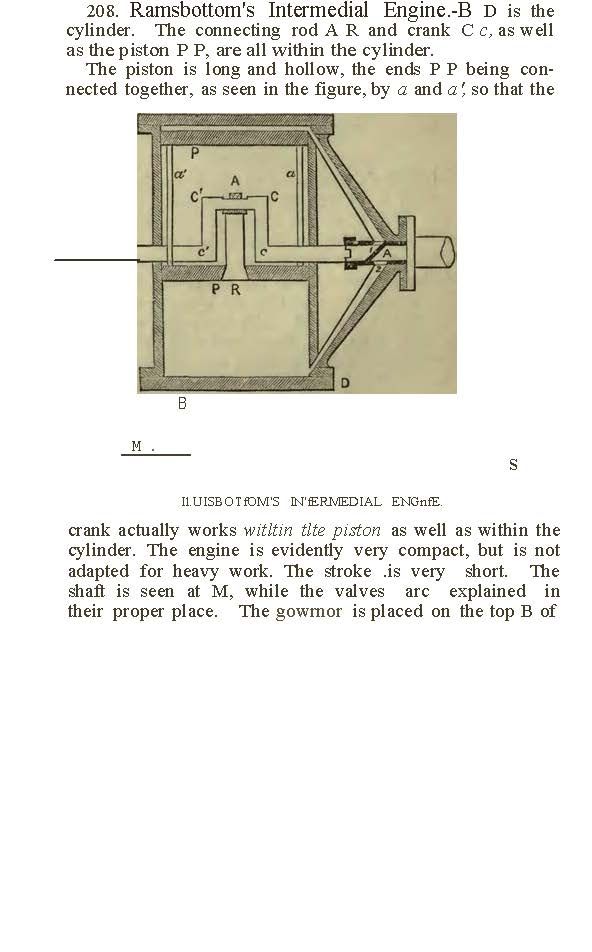

      Has any one got any information on this engine
      #115056
      Stewart Hart
        @stewarthart90345
        Whilst surfing one of the Archive sites I came across a book called Steam and the Steam Engine Printed in 1873, it had brief description of an engine called the Ramsbottom Intermedial Engine. Now I'm a bit of a fan of Ramsbottom, and started to do a bit of research on this engine but drew a blank, the book has one further mention of the engine where it describes its rotary valve. I've sketching out a model of this engine, but would like some further information, etching what it was used for were any built etc, so can any one help

                  #115204
                  Sub Mandrel
                    @submandrel
                    Presumably the crank runs in a scotch yoke inside the piston?
                    #115208
                    Stewart Hart
                      @stewarthart90345
                      Thanks for your interest Neil
                      Yes I think a scotch yolk is what it used, though the American Pinker engine has a connecting rod arrangement.
                      Its got a number of interesting design problems, how to assemble the crank inside the cylinder and piston is one, and how to time the valve event is another, and how to fabricate the cylinder yet another.
                      Unfortunately I think it would build up into quite a boring engine as all the interesting mechanism would be out of view inside the cylinder, but I think adding a governor would add some interest back.

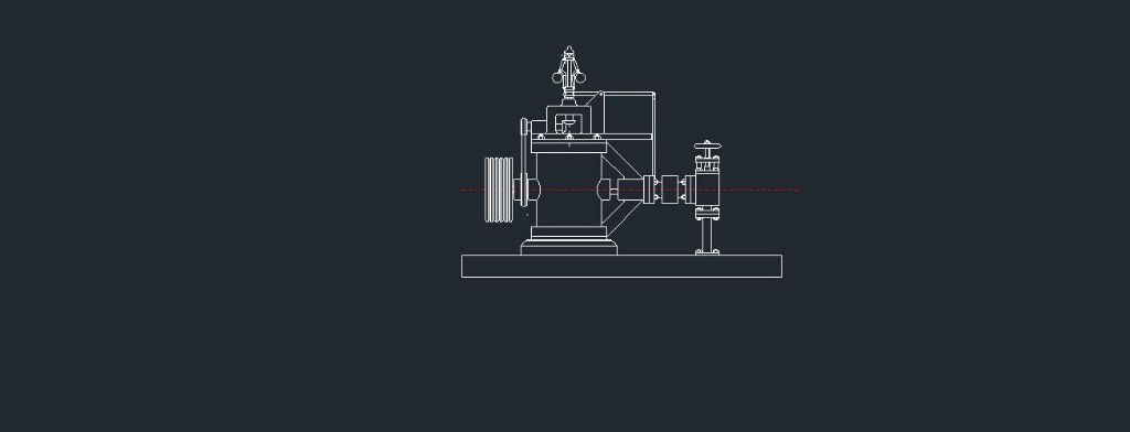

                        #115798
                        Stewart Hart
                          @stewarthart90345
                          Decided to have a go at drawing something up and came up with this
                          When you break it down its quite a simple engine, the hardest part will be in fabricating the cylinder.
                          Stew
