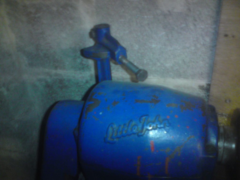

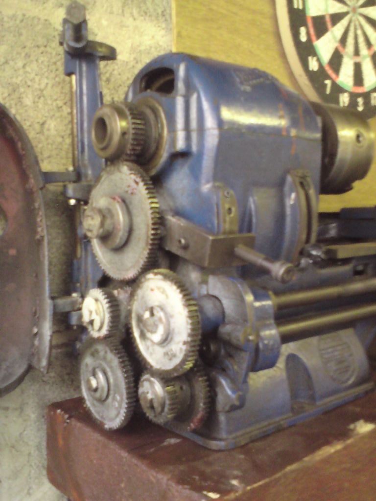

      Here she is. Needs a bit of work but is spinning free by hand,I was told it was working but needs a motor, What do you think?

          Dont let any darts bounce out and hit the lathe bed.

            Not sure what to think… Have you actually purchased it, or are you just contemplating it? How much was/is it? Is the dartboard included?

              These were very like the atlas lathes from the USA, no gap in the bed which was very un-British.
              #72822
              ady
                @ady
                The biggest issue for me would be the headstock.
                Early versions had a bearings held down by bolt caps, changed later to a one-piece headstock casting with the bearings pressing into the bored housing.
                You don’t want  a bolt caps version.

                      I see what you mean about the Atlas lathes being similar, the bolt cap version will be OK for what I want as I’m not too worried about total accuracy at this time, I will not be making anything that needs it. Just spacers and packers for motorbikes ETC.

                        In that case I think it’s a bargain. You will need somewhere around 1/2 to 1 Horsepower of motor to run it, and it’s probably worth locating a manual, so that you can replicate something like what was running it before. And like Ady said, make sure your brother covers the lathe bed with something before playing darts in there.

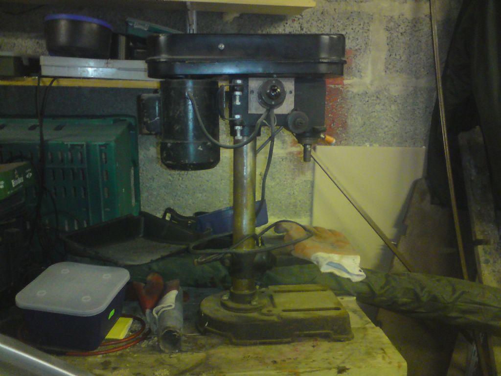

                            Ahh, Its working again, Here,s the pillar drill I hope to use the motor from. It looks a bit small but it has a 350 watt motor so nearly 1/2 HP. so it might just be enough. A mate gave me it as the drill spindle is bent so if it’s not I can always try to true it up and use it as a drill again.
                            It has a 4 v belt drive so I can use that to get close to the recommended speed of 1425 RPM. that the original motor had.

                                I wouldn’t use a more powerful motor until you get some experience with it, so that one looks good for starters.
                                If you’re a total newbie you’re going to make some pretty daft mistakes at the start…then as you move on you make more advanced errors…

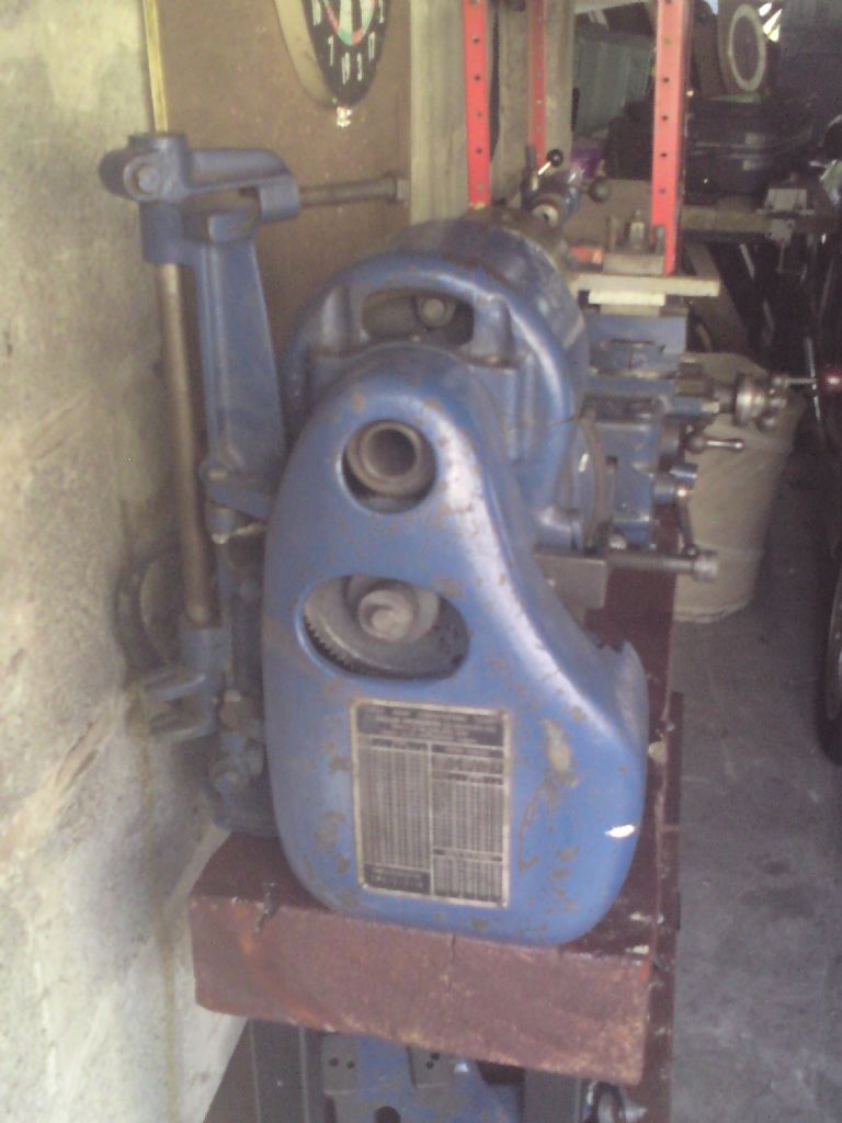

                                    Some more pics.
                                    As you can see there are a few more bits to fix.
