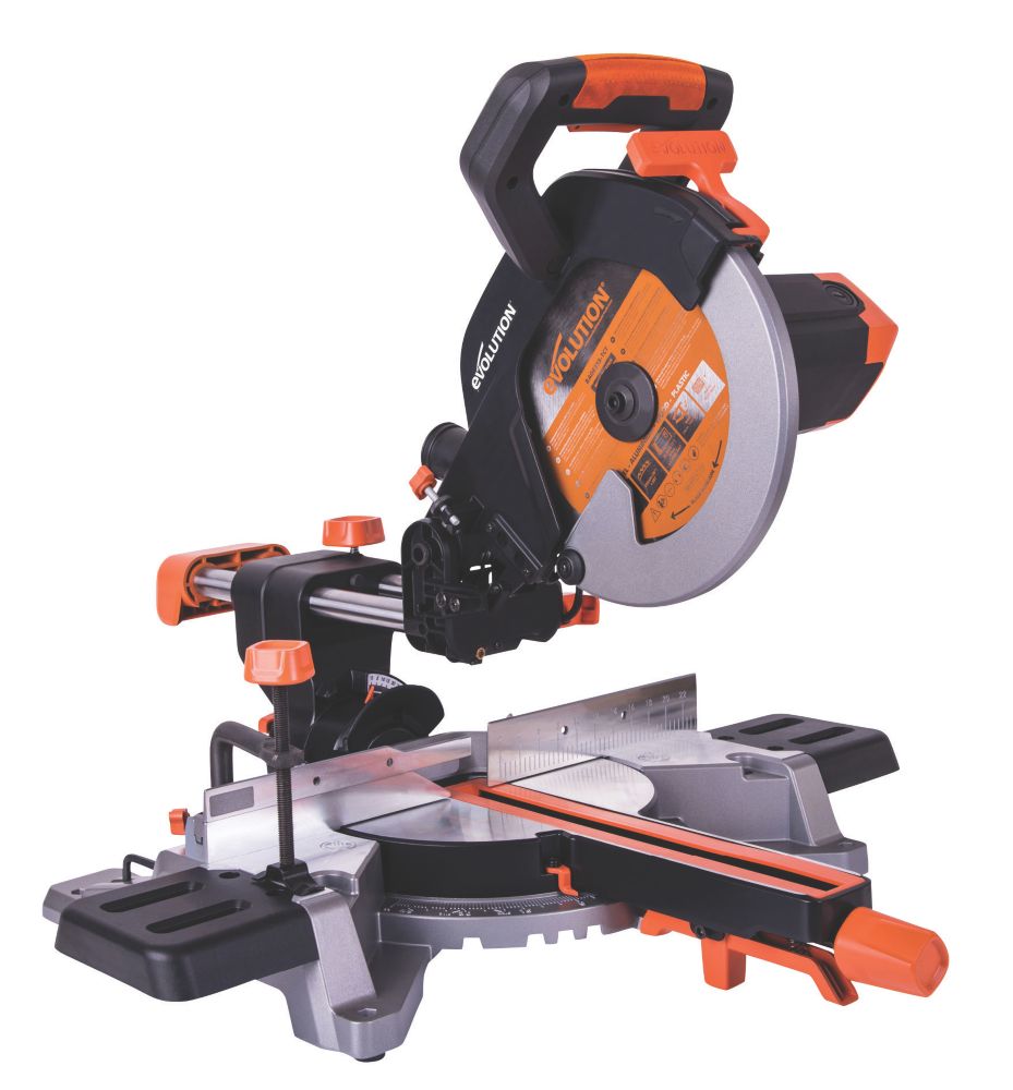

      Can it cut through solid steel?
      #411773
      Iain Downs
        @iaindowns78295
        Regular readers may be aware that my aldi chop saw has burned out and I've been looking for an alternative.
        A couple of posters have recommended the Rage Evolution Range such as this impressive beast .
        However, what I want to cut through is solid steel. Inches of it. the specs and reviews I've seen talk about cutting through 4mm tube of 6mm plate, not 60mm solid bar!
        Will it actually cut through proper solid metal or will it burn out being overloaded?
        I don't want to buy something quite pricey (well I certainly don't have an approved budget), if it's not going to do the job.
        Looking forward to hearing your experience.

          For metal cutting you want slow with coolant along with lots of teeth. Because this is intended for woodwork it runs far too fast.
          My choice would be a horizontal bandsaw, have a look through the ad's in the magazine or click on some of their adverts on this forum.

              Iain, I've got the non-sliding version of this, which I bought a few years ago now. I've used it mostly for timber and only very occasionally for cutting metals (aluminium, brass and thin steel).
              It is not designed to cut through 60mm steel bar routinely, but will cope with the sort of thinner calipers you mention, though even here you must expect the teeth to wear faster than they would if only softer materials are cut with it.
              If I were wanting to cut 60mm steel bar on a regular basis I would probably invest in a good quality powered hacksaw or a dedicated metal-cutting chop saw.

                      Their website is clear 'Cuts mild steel, max 6mm thickness'.

                              Beware of tools that do miracles for tiny money! Although a chop saw can cut metal, they're not ideal. If you need to cut thick metal all day, every day then you need to spend serious dosh on an industrial machine. My local metal emporia's band-saw is a beast. It must weigh well over a ton and, judging from the size, I guess the motor is 3 or 4 HP continuous.
                              Chop saws are powerful, your example 2000W, which means they can cut quickly. But, you can't expect much of a saw costing only £150. The motor has brushes that may not last more than a few hours run time, and it will get hot quickly. Used continually to cut steel, the saw wouldn't last long. Either the brushes would wear out or – more likely – the windings would overheat and melt the insulation. I suspect the blades might wear quickly too, using them on metal is a bit of a bodge.
                              Might still be a good choice for a workshop though. They cut quickly, don't take up much space, and are cheap to replace. Might do a good job for a long time in a hobby workshop where it wasn't pushed too hard. I can also imagine a professional usefully thrashing them as disposable saws; depending on the job it might be cheaper or more convenient than buying a saw built to last.
                              How much metal are you planning to cut? As a light hobbyist I might cut 60mm bar about once a month, usually smaller diameters, and brass and Ali more than steel. It's not unusual to have a week where I don't power saw metal at all. Meanwhile, a professional operation might be producing steel swarf by the ton per day. A chop saw is a reasonable bet if you're like me, but not if you're into a lot of heavy cutting.

                                          Rage saws are (1) not cheap and (2) specifically have TCT tipped blades designed for cutting metal – they do specific mild steel and stainless steel baldes.
                                          Llike a chainsaw blade they have a depth control contour to stop the blade biting off more than it can chew.
                                          The 6mm thickness limitation is, I assume, because the blade could start to clog with chips.

                                              The Rage saws will cut solid metal (not stainless I gather). They are known to cut significantly larger sizes than are specified and to do it reasonably well. The blade will wear quicker of course and it's unlikely to be a happy bunny if you cut 4 inch solid section day in day out.
