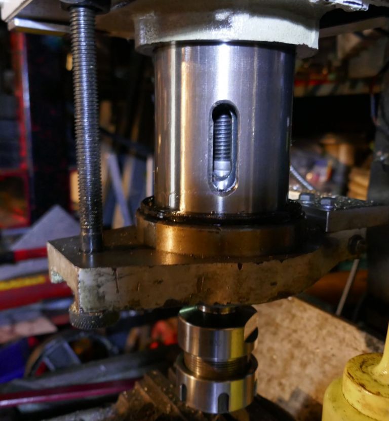

                    Morse Taper Tooling is what you have. The drawbar on morse tapers needs to hold the tool from falling out. Tighten with the correct size spanner. In the distant past my old mentors advice was put your thumb on the jaw of the spanner and tighten with your pinky and a little light assistance with the ring finger.
                    One trap with morse tapers is to insert the Cold tool into a spindle that is running Hot then winching it up tight with the drawbar. Very difficult to remove this shrink fitted tool holder.

                      I have an RF-45 (clone) milling machine which has a MT3 taper and use an ER32 collet holder for most of the milling operations. I do not have any problem ejecting the collet holder.
                      The drawbar only needs a moderate tightening to secure tools in the spindle and releases with a slight tap. If a cutter does not release easily, there is a slot in the side of the spindle for using a wedge. (The same as used on a bench drill). Just extend the spindle and insert a wedge to remove the tool. (photo shown with drawbar still attached)
                      Paul.
