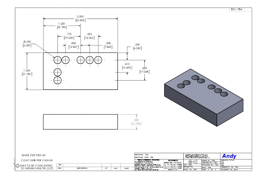

      Has anyone tried making up the Derek Brown Pipe Bender as illustrated in the current MEW No.297? From what I can see there is a serious clash in the positioning of the two 1/4 Diameter holes at the bottom LH corner of Item 1, page 44.

            My apologies, we were redrawing from scans of the original article which itself wasn't very easy to read.
            The 0.583" dimension probably should be 0.683" or 0.663". As the two holes are drawn touching, I suspect 0.663" (0.413" + 0.250&quot is correct but going to be tricky to machine.

                Looking at my copy of MEW 64 page 38, item 1, it is quite clearly 0.683"

                                                Hi, I have found five dimensional errors; item 1 Base, bottom hole centre should read 0.683" below the top five hole centres, item 5 Anchor Posts, from bottom of the shoulder to centre of the radii should read 0.313", item 6 Levers, lever for odd 1/32" sizes, middle hole of the three should read 0.938" from common data point, item 7 Formers, top left hand 1/4" former diameter should read 1.5", bottom left had 3/32" former, notched dimension should read 0.125".
                                                These are all from those published in MEW 64 Feb-March 2000.
                                                Regards Nick.

                                                    I'm just modelling in SolidWorks from my Dad's copy of the magazine and realised there must be an error in the base. I've probably got the original issue in the loft but many thanks for publishing the corrections here and saving me rummaging through those old copies.
