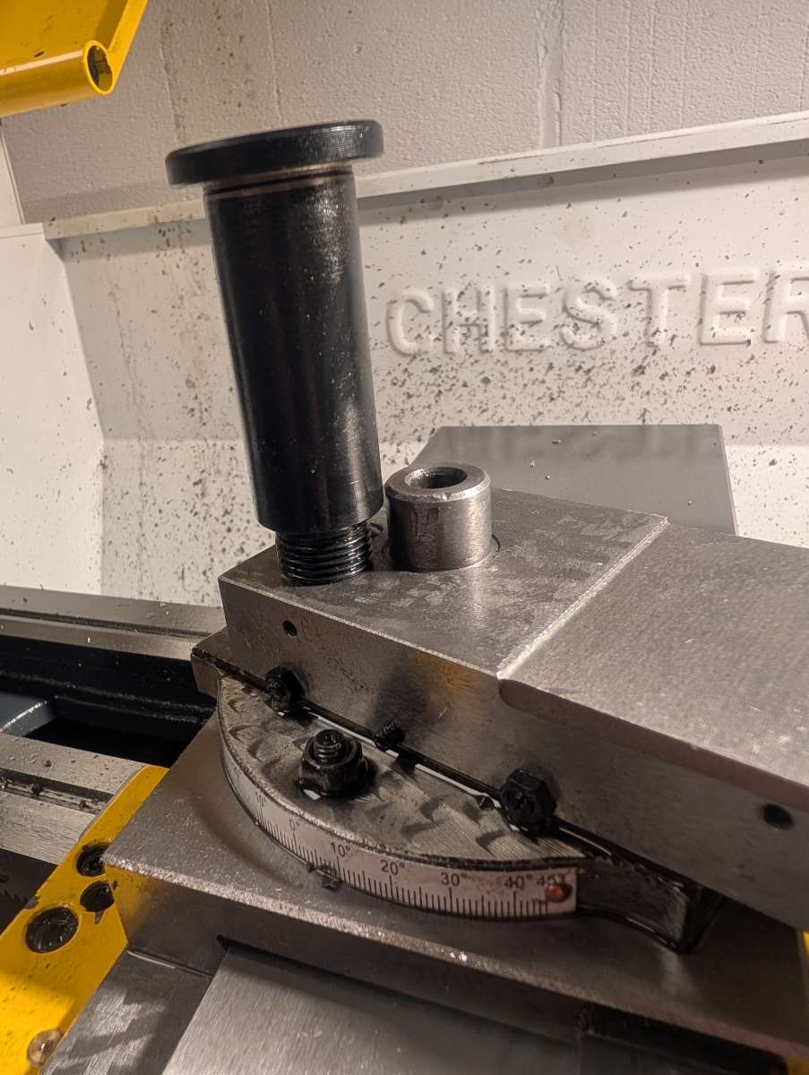

      I bought a chester lathe (DB8VS) and would like to have a QCTP on it. I bought from ARC a wedge type QCTP, however it doesnt fit the machine, as my top slide has a spigot with a diameter bigger than the bore of the QCTP.
      I dont think filling down the spigot is a good idea, as i believe it is here for a good reason (rigidity ?).
      I cannot enlarge the bore of the QCTP, as the spacer (pic below) is where the pressure is applied from the top of the QCTP to the bottom. I machined a replacement one, without the bottom thread, and realized that was not an option.
      So I think this QCTP will simply not work and will have to go.
      Looking at other options, I came accross 2 types :
      – Dickson type
      Soba 5pc Quick Change Toolpost compatible with Myford ML7 etc
      it seems that boring the bottom to accomodate the spigot is an option, however the tool post is hardened, so it might prove tricky.
      – Multifix type
      Multifix Style 40 Position Quick Change Toolpost 150 – 300 Swing
      these have a bore that would readily accept the spigot, so no machining of the QCTP seem necessary. However, this type is very pricey…
      Considering the price, I would rather go the dickson type, with the condition that it can be machined and it performs satisfactorily (i recall reading some negative stuff about it some time ago)
      Any advise or comment are welcome !

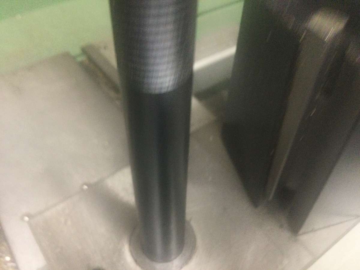

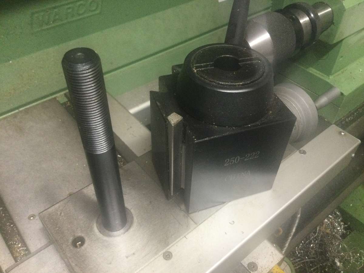

        Stuart Smith 5

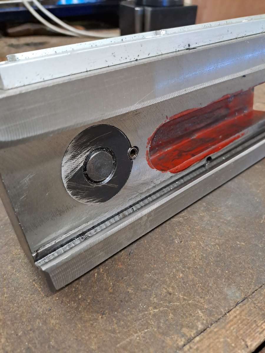

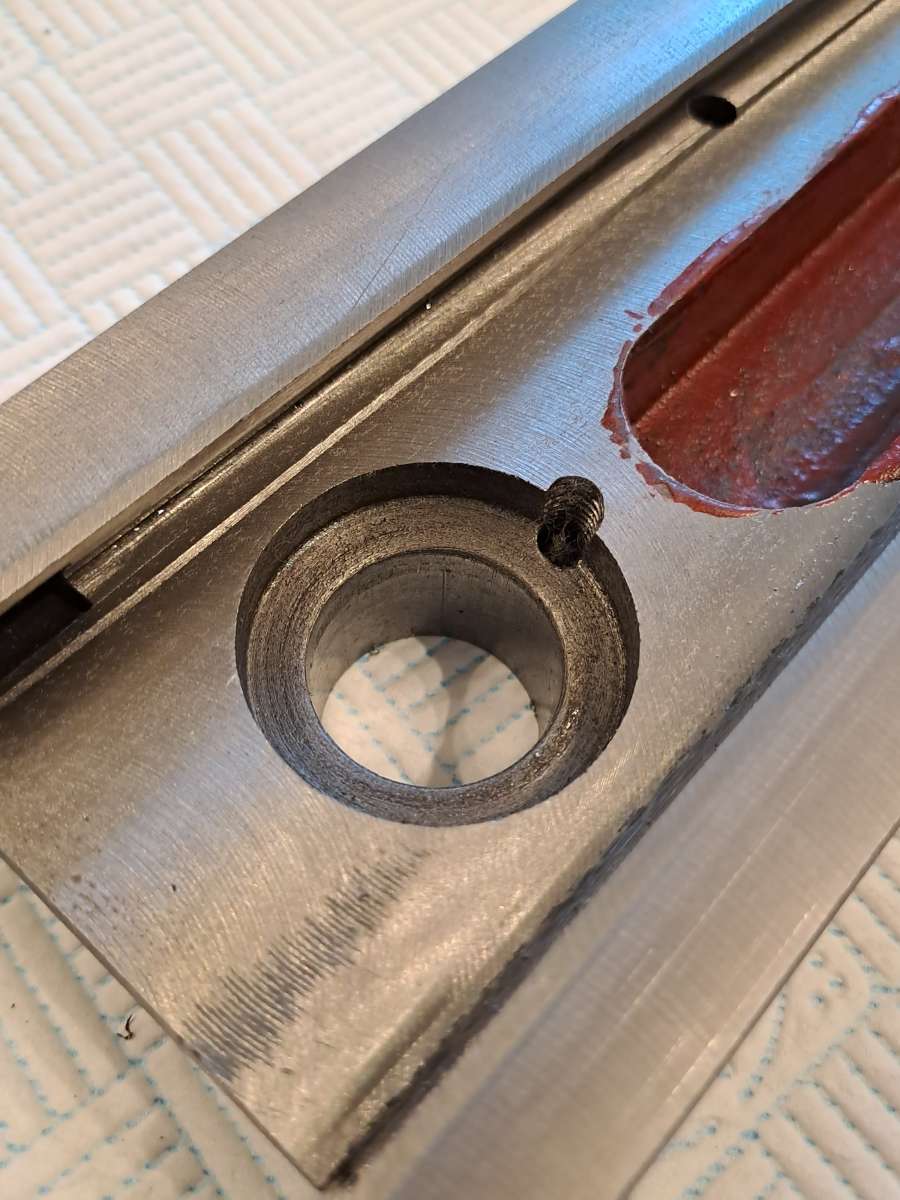

          @stuartsmith5
          Can the existing spigot not be removed ? And then a replacement made or the new supplied one modified?
          I had to do this to fit the Arceurotrade one to my Warco lathe.
          I think the original spigot was push fit from below and I removed it and made a bush to fit the hole and spigot from the new QCTP.

          Chris12
            @chris12
            No, the spigot is part of the top slide, so if I remove it I won’t be able to put a new one in place.

            Stuart Smith 5
              @stuartsmith5
              Chris
              I have added a couple of photos and some more info to my post
              Stuart
                A86AD6EC-7D61-4523-880C-20C455D1C2AD

                  Stuart Smith 5
                    @stuartsmith5
                    Chris
                    I have found some photos I took when I was doing mine.
                    EA805508-3A76-48BF-AF9E-4C4957D20079D7721BA9-280F-40A5-A999-CD6ABB75875546C073E5-01EE-4791-A9FD-946CE6462E36The first photo is of the underneath of the top slide with the original bush/ spigot removed. The second photo shows my replacement fitted. I remember now I had to tap it to screw the new piece in. The third photo is from above with it fitted.
                    Stuart

                      #812149
                      Chris12
                        @chris12
                        Thanks Stuart. The stud can be removed from below the top slide. However the spigot is an integral part of the top slide (from the picture it looks like it is a separate part, but it is not). Also, the diameter of the spigot (20 mm) is bigger than the bore of the QCTP (14 mm).
                        I considered filling down the spigot to reduce its diameter to the QCTP bore (ie 14 mm) but that means the thickness will only be 2 mm (the existing stud is 10 mm).

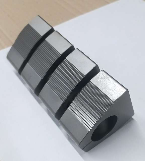

                                              I’ve cut some QCTP/TH (tool post/holder) with EDM because I think it’s a simple, practical, and economical solution for mini lathes. I’ll let you know the results of the test!
                                              20250822_190257
                                              20250822_190015
                                              #813553
                                              Fulmen
                                                @fulmen
                                                Very nice, you could even make it indexable like the MultiFix without too much modification.
                                                #813558
                                                dk0
                                                  @dk0
                                                  Yes, I’ve already included three index positions: 0°, 45°, and 90°, with a 5mm pin and three seats on the body.
                                                  Thanks for the encouragement, and any other suggestions are welcome.
