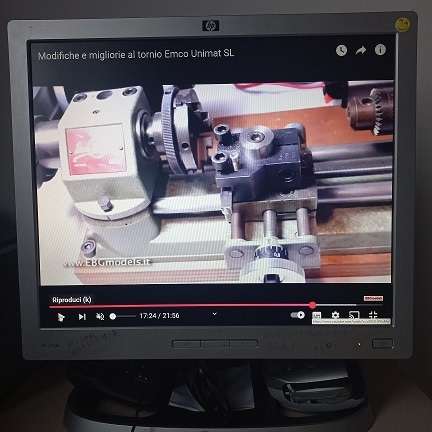

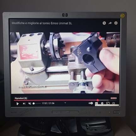

Ps. Italian version of Drummond Norman tool post.
I could make a square pocket for the tool and reduce the bottom of the tool holder to 2mm for 1/2″ tools.

On 24 August 2025 at 11:11 dk0 Said: Ps. Italian version of Drummond Norman tool post.
Thanks for posting this. I normally use a four way but I think something like this would be very handy for use with a boring bar. 😉
Vic in your opinion, what should be the dimensions of the square and rounded seats for boring bars?
Thanks.
George Thomas designed quite a few shop made tool holders including boring bars to be used in his Myford 4 way tool post that would also work just as well with any qctp. I think that alone is worth the price of the book. https://www.teepublishing.co.uk/books/in-your-workshop/model-engineers-workshop-manual/
On 26 August 2025 at 21:43 dk0 Said: Vic in your opinion, what should be the dimensions of the square and rounded seats for boring bars? Thanks.
I’m not sure, I’d have to sort out some of my boring bars and take some measurements.
