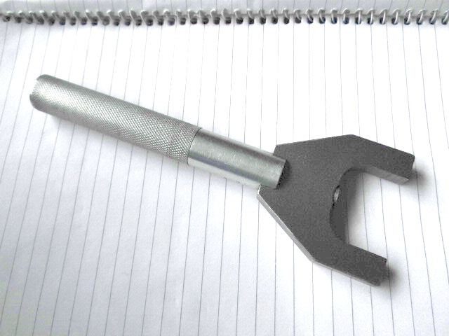

      My new benchtop mill was supplied with a Q-tech R8-ER32 collect chuck
      Having used it for the first time, I find that I can't hold the body of the chuck while I use the C-spanner to loosen the nut. I just don't have a sufficiently strong grip in my arthritic fingers.
      There are flats on the body of the chuck so I guess that one needs a spanner to hold the body.
      Can anybody who owns one of these Collet chucks kindly tell me what size spanner is required, please?
      Further, any suggestions as to where I might obtain one, please?

          With the chuck in the spindle you can also lock the spindle or put a tommy bar into it and then use the collet nut spanner in the other hand, that's what I do with my two R8 machines
          #486492
          not done it yet
            @notdoneityet
            I’m not surprised, if the collet chuck is tightened to the proper torque! Likely tighter than your car wheel nuts should be.
            Measure the distance across the spanner flats – that will be the spanner size required. For items closer to the minimum diameter for the collet, I have some handy blocks of wood, of various thickness, to support the end mill/ whatever while tightening and undoing – to avoid the item falling.

              Thank you for taking the time to respond.
              Measuring across the flats gives 46.3mm.
              The chuck uses a 7/16 UNF drawbar with a 11/16 nut on the top.
              So I suspect that the spanner may be 1.7/8 or 1.1/8 Whitworth
              Since I have nothing approaching any of these sizes (even in adjustable or waterpump spanners) I thought it would be useful to know is anybody among the intelligent and helpful readership has previously solved the problem.
              I have NOT discovered any way of locking the spindle and I'm sure I would have spotted a hole for a Tommy Bar.
              But I'll go and look at the Mill in the morning and search for Tommy Bar apertures and spindle locks.

                About the first job I did on my mill was to make a spanner to fit the ER32 flats. I do own a huge adjustable spanner (which weighs a silly amount) since i have some farm machinery and that was used to tighten the endmill for making my spanner from a wide bar of 8mm mild steel i bummed off the local agri engineers. i cut a wide slot to fit the flats and thinned down the rest of the bar as a handle. It is crude but functional and one day I;ll get around to making a nicer one but I've been sayng that for years….
                Hacksaw and drill work could fashion a temporary one or even as simple as drill holes and bolts on some narrower bar bits to create a U with a handle.

                  I slightly enlarged an old bicycle headset spanner with the intention of making a proper one but that was some 10years ago.blush

                    You can buy a single open ended 46mm spanner for a tenner and if its tight on your 46.3mm just mill a tad off each side.

                      As PGK said, a little work with a hacksaw and file would soon produce a useable spanner.
                      I have made several such for odd jobs over the years where the cost of a "Proper" spanner could not be justified.
                      They may be crude but they still work years later.smiley

                                                The spanner doesn't need to be strong. This one has a mild steel head bolted into an aluminium handle with an M6 Allen Bolt – junk box metal and rough craftsmanship.
