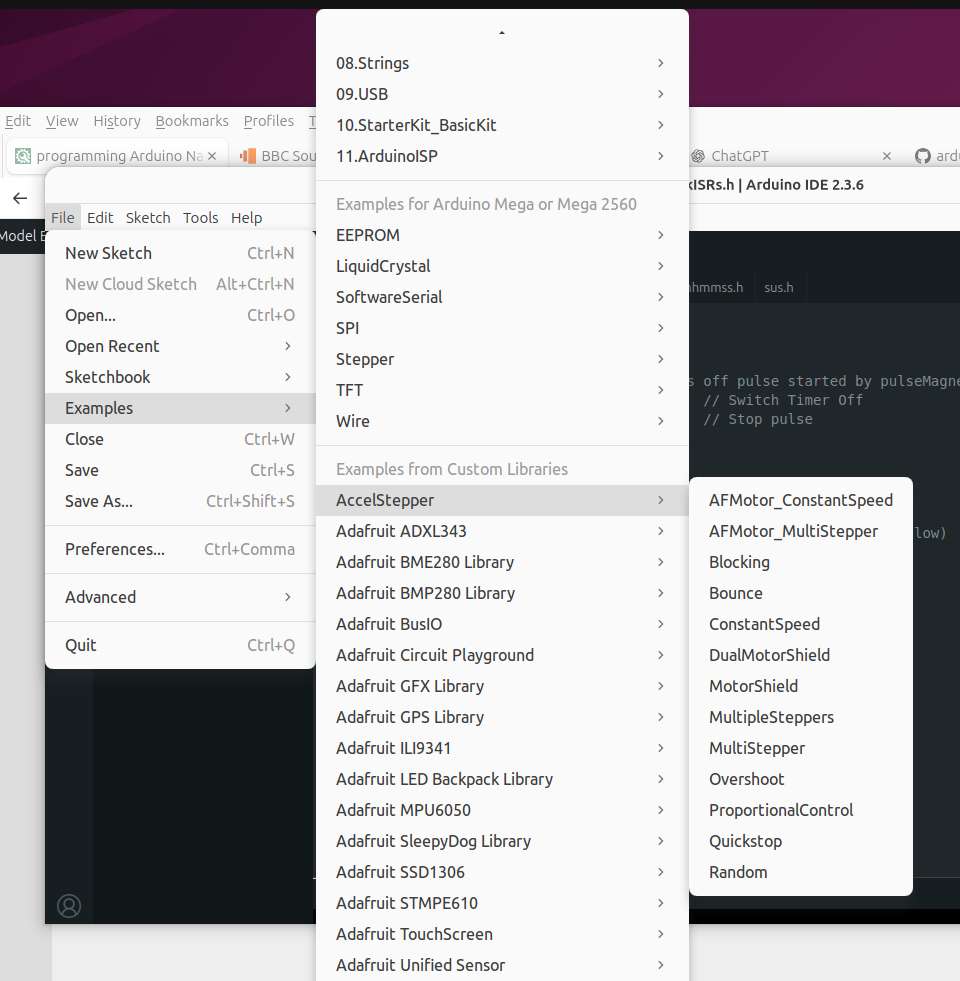

            I prefer books for learning rather than a screen.
            Most Arduino books are aimed at beginners and provide a good introduction and example programs.  My kids obviously have no idea what I did for a living because I got “30 Arduino Projects for the Evil Genius, 2edn” for xmas a few years ago.  Though nothing new in it for me, it’s quite good!
            This website has many older examples of the introductory type, which you can explore for free.   Might be ‘good enough’, but there’s much to be said for buying an up-to-date edition, because of many improvements and simplifications over the years.  My book doesn’t cover how to compile and install projects on the web rather than setting up locally.
            The Arduino platform is unusually beginner friendly.  It comes with many examples that can be installed with a few mouse clicks.  The source code is available to study, so it is very common to develop programs by modifying examples and cut and paste.  Not from first principles.
            The AccellStepper library comes with these:
            Screenshot From 2025-12-17 16-32-04
            Although the examples are mostly simply written and backstage complexities are hidden, the compiler is almost full function C++, making expert techniques available if needed.   Most code I guess is written in C-dialect, for which Kernighan and Ritchie is the classic primer.   C++ is considerably more developed, not always in a good way, and it’s ongoing.  I’m not sure what a good C++ starter book in 2025 is, particularly as the compiler version lags behind.   For most beginner purposes having C++ is under the bonnet doesn’t matter – KISS!
            If anyone wants a play without downloading anything, it can all be done on the web.  (With the usual privacy intrusions associated with the cloud.)

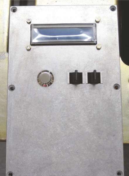

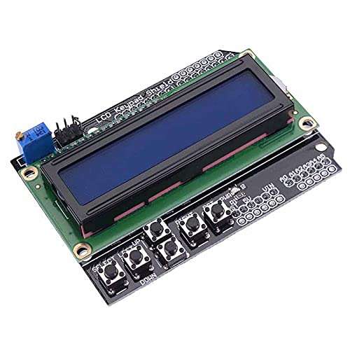

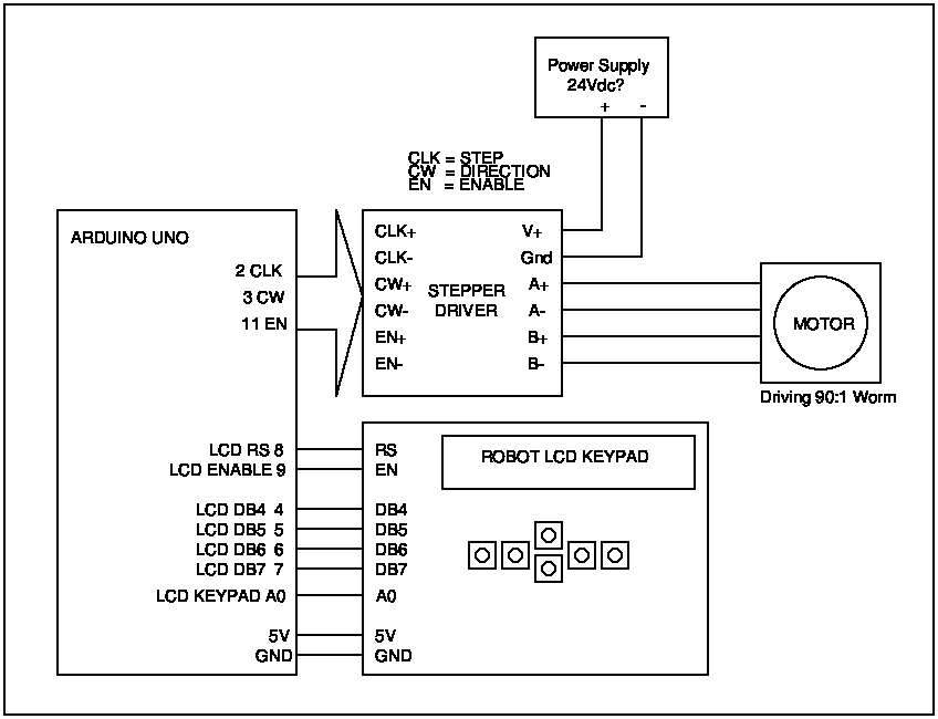

                            #829544
                              Ted and I are trying to sort out his actual problem which is a failed Stepper Motor Driven Rotary Table.  He’d prefer to do this without learning Arduino at all (very sensible!).
                              Not clear what’s wrong: could be the microcontroller, the keypad, the stepper driver, the motor, or a wiring fault.
                              My mission is to provide a working microcontroller.  This post is to confirm I’ve understood Ted’s set-up.  It’s described in MEW 249 “An Arduino Indexer”. which I don’t have.  Joining the dots:
                              • microcontroller is an Arduino Uno
                              • Software is Gary Liming’s 2014 Step Indexer.
                              • Display is a DF Robot / Sainsmart 1602 Keypad Shield.
                              • Stepper Driver is a TB6065
                              • Motor is 200 steps/revolution, microstepped × 8 for 1600 steps / revolution.
                              • Rotary Table has a 90:1 worm
                              • No temperature sensors fitted
                              • The stepper driver supports either positive or negative logic.  Assuming the MEW 249 article wired it to match Gary’s software, which looks to be positive.
                              tedsrotary
                              With this Keypad:
                              lcd1602keypad
                              Anyway, will Ted please confirm the LCD Keypad pictured matches his.  Also, if there’s a diagram in MEW249, that it’s like mine.
                              Grateful if anyone who has MEW249 will point out any misunderstandings.

                                The TB60xx drivers don’t have a great reputation.  There are much better modern drivers around at low cost.

                                      What is the driver form factor? Is it a black plastic box with a row of screw terminals? Is so there are many more modern devices available, I’ll check what I last used when I upgraded my lathe.

                                          Are you able to check whether there are pulses on the CLK+ input when the stepper should be rotating? (That assumes active high logic with CLK- connected to Arduino’s GND).

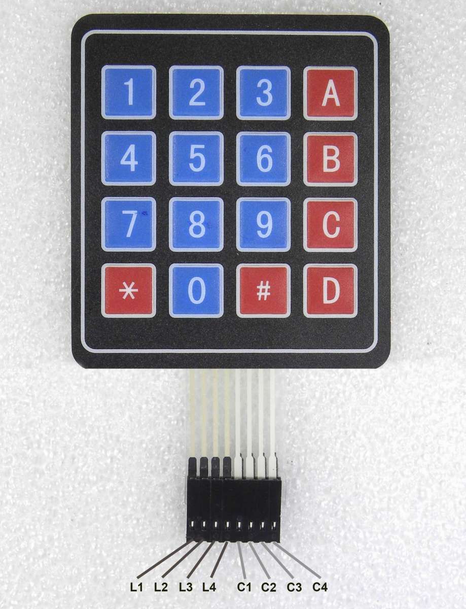

                                                On john fletcher 1 Said:
                                                Your diagram Dave isn’t quite the same as Carl Wilson, he used 12 volts and 4 X 4 key pad, fewer connection to the display. Many thanks for your help.  Ted
                                                Getting there Ted, I hope!
                                                12Vdc supply is fine, that’s as per MEW249.
                                                I’m a bit concerned about mention of a 4×4 keypad and fewer connections to the display because that suggests you don’t have Gary Liming’s software.  Could be one of the others, not the build described by Carl Wilson!
                                                Carl used a combined Display/Keypad exactly like this:
                                                lcd1602keypad
                                                The important feature is the buttons, bottom left, marked SELECT, LEFT, UP, DOWN, and RIGHT (RST isn’t used.)  Carl wired them to paddle switches on his front panel:
                                                Screenshot From 2025-12-22 10-53-15
                                                The MEW249 Step Indexer is incompatible with a 4×4 keypad like this:
                                                Keypad-4x4-E
                                                Be good to confirm exactly what you have.  Can you post a photo?
                                                Cheers,
                                                Can
