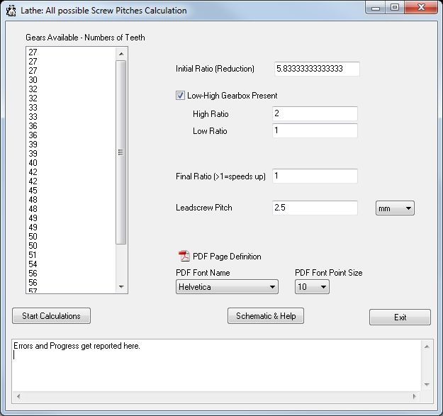

      Some while ago I became suspicious of one of the thread pitches quoted in my Warco WMT300 handbook, the 3mm pitch thread was wrong by close on to 15%, and (embarrassingly) I discovered that 10 years after getting the lathe, it hadn't been delivered with all the wheels it should have been – I didn't check when I got the lathe, just counted the wheels without opening the wrapping plastic – and it did have unexpected duplicates. This meant that I couldn't cut half the metric threads in the lathe manual. After enquiring as to the price of the wheels I needed (after 10 years I couldn't reasonably ask for them to be supplied FOC), and gulping loudly, I decided to write a spreadsheet to check the accuracy of the pitches in the manual and try to work out wheel combinations to make up some of the other threads for nothing instead. The manual threads were fairly consistent in being 1.59% in error, except the 3mm pitch which had a 70 tooth wheel instead of 63, which was the cause of the pitch error. After a good deal of trial and error I found alternatives for most of the metric threads I wanted, but it stuck me that it was more error than success & there must be a better way of doing things.
      You may be aware that every screw cutting lathe can actually cut a lot more threads than the manufacturer usually specifies in the handbook, and with pen making I wanted quite a number of non-standard threads. After the hours trying, I had proved trial & error was not a viable method, as it took too long to find the pitch I wanted, so what I really wanted was a method of quickly calculating every possible pitch, searching through the list and selecting the ones I want. So.. how to do it?
      Well, I wrote a program that used the brute ignorance & force method to try every possible combination of wheel in the lathe and calculate the pitch for it. The program is pretty simple and does not check if the wheels will actually fit in the available space (it would require too much detail about gear module, distance between shafts etc to be entered, to be worth programming for a program that really only runs once per lathe), but it does check every theoretical combination and allow the user to try them out quickly & easily. There are usually many alternatives giving the same pitch, so if one combination won't fit, another probably will.
      It turned out there were quite a few combinations for my lathe – the 755,160 possible combinations led, due to duplication of wheels, to about 230,000 distinct different combinations producing around 30,000 different pitches (I'm guessing, I haven't counted), and I found I was able to get thread pitches from 0.0708 mm to 5.185mm (358 to 4.898tpi). At the 1.5mm pitch range I particularly wanted, there are 356 different combinations to try that all produce exactly 1.5mm pitch to 14 decimal places, and then a further thousand or so giving a perfectly viable error of less than 1%.
      So, what has this to do with the ME forum?
      Well, I thought other people may be able to use the program. It is certainly applicable to the Warco WMT300/1 & WMT300/2 Combi's and all other badged alternatives of the lathe (Clarke CL430/500M, Chester Model B, Sealey SM27). It is also applicable to every single lathe that uses 4 gear wheels with a drive train similar to that shown schematically in the diagram below:

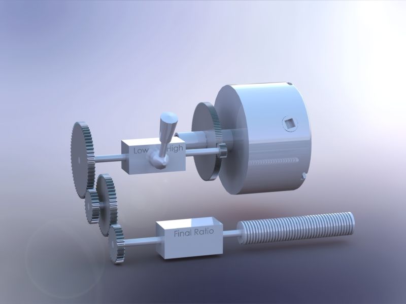

      The program directly applies to the Seig SC2, SC3 and SC4. With a bit of thought it could probably be applied to the SC6. It also applies to the Warco Super Mini, WMT500 Combi and WM150. It may apply to the WM180 with thought.The program does apply directly to the Chester Centurion 3 in 1 & long bed Centurion, Conquest Lathe Super & Superior, DB7, DB8 and DB11. It applies equally to many Grizzly & US badged lathes with the same drive train layout.
      The program window looks as below (with all the data for my Warco filled in):
      I have added a 2 page help file accessed through the 'Schematic and Help' button, made the data entry a bit easier than when I initially wrote the program, and programmed in two different output formats for the available thread pitches. The program can output to a PDF or CSV file for further manipulation in a spreadsheet. The PDF file can be quite big, so do not be surprised if there are 1000 pages in it, for my lathe and rather odd wheel combinations, I get 2991 A4 pages at 76 combinations per page, and a file size of 125Mb. On opening the pdf file, Adobe Acrobat Reader states that there is an error in the pdf file and 'repairs' the file. It speaks with forked tongue – it doesn't; it just wants to convert it from the uncompressed version 1.3 file format to a more recent and verbose compressed format and thereby slow the opening and responsiveness of the file (I had to know the v1.3 pdf format inside out before I could programme the unit to create a pdf file, and I know it's right – no other PDF reader objects to the files created by the pdf code I wrote).
      You can download a zip file of the program here:
      http://www.chestnutpens.co.uk/downloads/ThreadPitchProgram.zip

          The program is a self contained 32 bit Windows program that should run on any version of Windows from Win95 onwards and should also run under WINE on Linux. I have tried the program on Win7 (64bit) and WinXP (32 bit), and it definitely works on both operating systems. The zip file includes a readme file, the help file, executable file, and calculation unit source code (so you can check that the code does nothing nasty to your machine if you want to). The program creates a file in its own directory called 'data.ini' to keep the gear wheel sizes and pdf file preferences for next use. If you have any of my CNC programs and put the program in the same directory, they will all share the same 'data.ini' file, keeping the clutter down.
          Instructions for how to use the program are given on page 2 of the help file. Please note that the program can take a while to run, and Windows occasionally gets bored, looses focus and the program does not update the progress indicators. Just leave it to run, if there is a problem it will exit cleanly and tell you what happened in the box at the bottom, but if it seems frozen, that's simply a symptom of Windows not knowing how to cope with a calculation intensive task and it behaving like it has the attention span of a goldfish.
          I hope you find it useful when you need an odd thread pitch, loose a wheel or simply want to play.

            I downloaded and tried your program, for some reason it outputs zero (0) pages in the PDF file?

                After a brief tussle I have it working with wine. Initially same problem as Thor, but on the second attempt it fired up OK. Something to do with populating data.ini on first use?

                  Dave, same experience as you, except with data.ini populated I get lots of PDF pages, but all are empty.

                    That is one problem I have never had. It's amazing how people come across problems that seem baffling and shouldn't happen.
                    Could you try with outputting to a .CSV file?
                    The other option I can think of is, have you put in a 'final ratio'? Needs to be 1 if no other value is put in. A final possibility is is a font selected from the three options. It should default to 'Helvetica' but may not.
                    If that doesn't work, could you post the contents of data.INI, so I can try it myself?

                          As a result of Thor's .ini file I discovered that it did not respond well to decimal commas being used in the input. I have changed the program to include a text parse to convert any inputted commas into decimal points.
                          While looking for the source of Thor's problem, I did notice a silly bug in the pdf output if no initial gearbox was specified where I had misplaced a closing brace so it didn't include a statement it should have done. I have corrected that.
                          To prevent the apparent problems of data.ini not being present, I've included a really basic one that works in the zip file with 5 tooth numbers in it. If the teeth are not in your list, delete them and add the ones you want.

                                            For some reason I can't yet identify, the pdf output does not always work. I shall work on it, but as I have no idea of what the cause may be, the solution may be difficult to come by. So, in the mean time, can I suggest that you try the pdf output and if it doesn't work, resort to the csv output.
