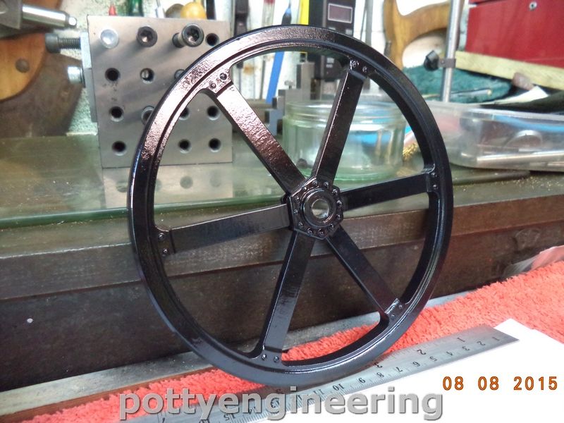

        I've more or less finished the drawing for the grasshopper engine for my series of Helping Dad Engines for beginners'. I used the free down load of the draft site cad package and I must say I was very impressed with it.
        This is the assembly drawing of the engine. Its roughly based on a haulage engine of the 1850 that on show at the Manchester museum of science and industry. Being a haulage engine it has a simple slip eccentric so being able to run in both direction will add interest, the eccentric as I've designed it should be very simple to make, ideal for a beginner. One part that has held me up with the design was sourcing a suitable fly wheel all of the readily available cast fly wheel were far to heavy a clumpy for this engine, so I decided on a laser cut blank, that was about the same price as a casting, with about the same amount of machining.grasshopper sht1.jpg
        I Have made a start of cutting metal the fly wheel and most of the cylinder is made, I've just got to crack on and get the rest done.
        Cheers
        Stew

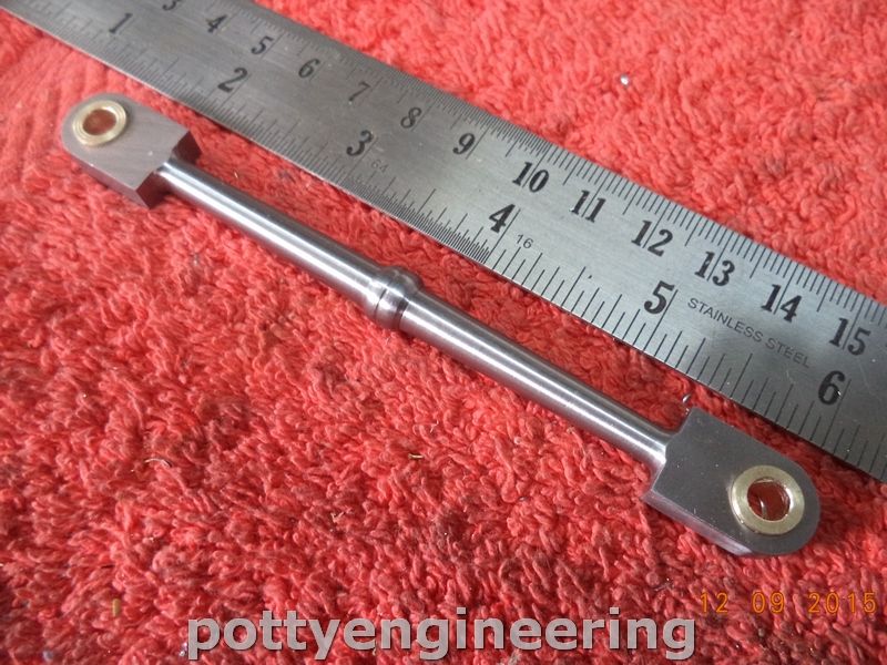

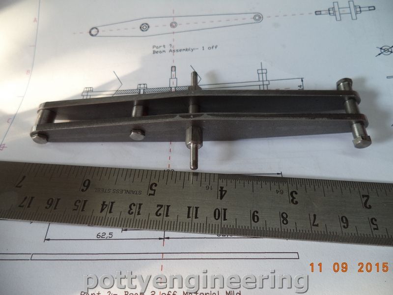

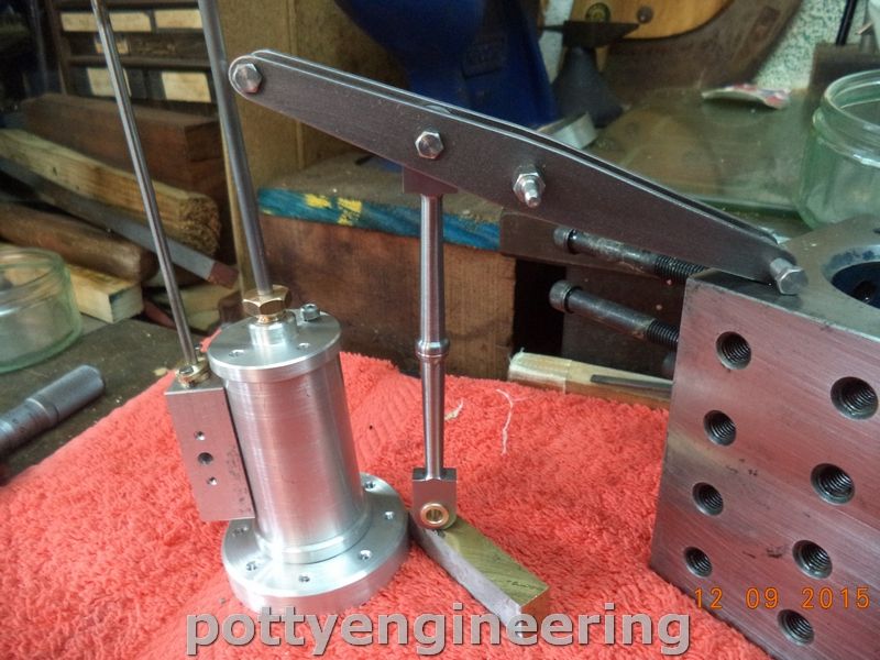

                          #204187
                          Stewart Hart
                            @stewarthart90345
                            Made a little bit of progress
                            Finished the beam, and the con rod and the cylinder off
                            Stew

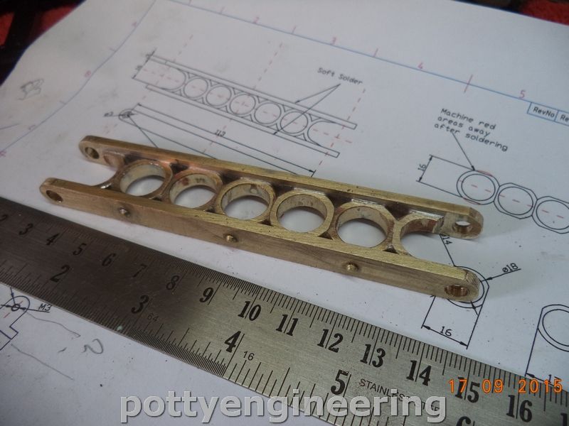

                            #204916
                            Stewart Hart
                              @stewarthart90345
                              Made the swing beam, a series of interlocking rings.
                              Stew

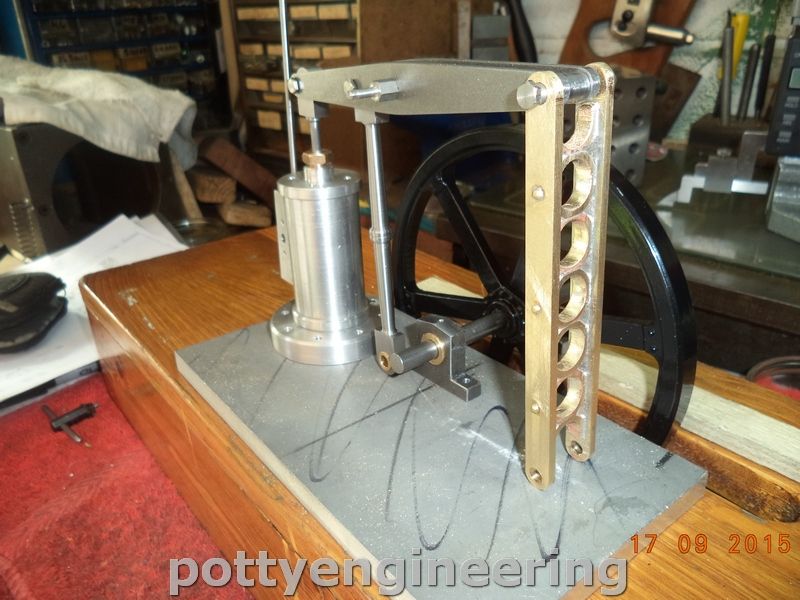

                              #209303
                              Stewart Hart
                                @stewarthart90345
                                Bin a bit delayed with this engine short holiday and domestic duties, but this morning I cobbled it together not all the nuts and studs are their so noting sealed, and didn't fit the fly wheel but I gave it a go anyway and it ran.
                                I'll strip it down now and finish it off properly with a paint job and a base plus a few other whistles and bows.
                                Thanks for looking
                                Edited By Stewart Hart on 26/10/2015 11:08:17
                                Edited By Stewart Hart on 26/10/2015 11:08:58

                                      Neil:- Don't worry the fly wheel will be on the finished job, along with a stop valve and a signal whistle. I'm planning on fixing it to the crank shaft with a straight knurl and loctite so it will be permanently on, but I didn't want to commit myself to that just yet.
                                      Cheers
                                      Stew
