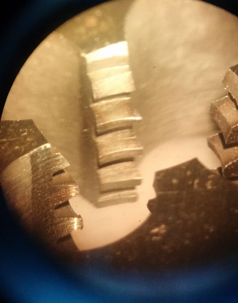

      Hello,

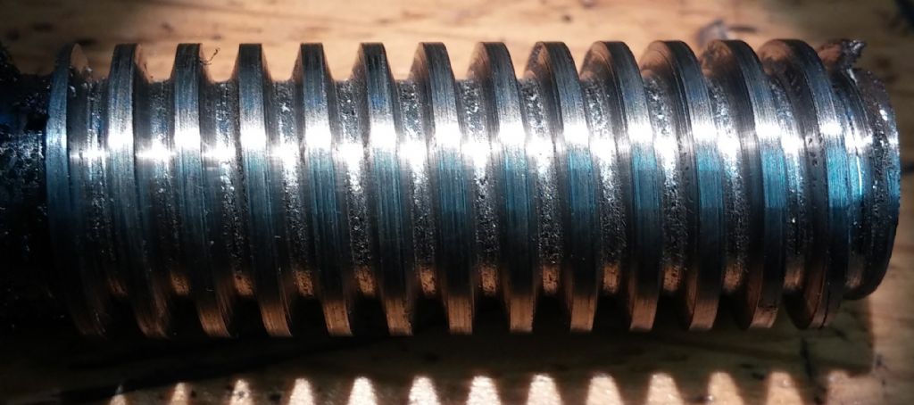

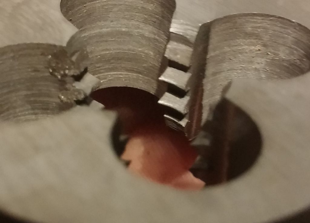

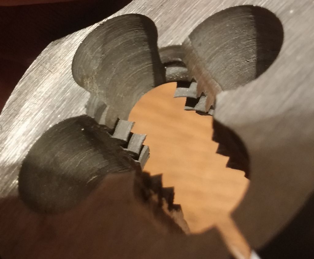

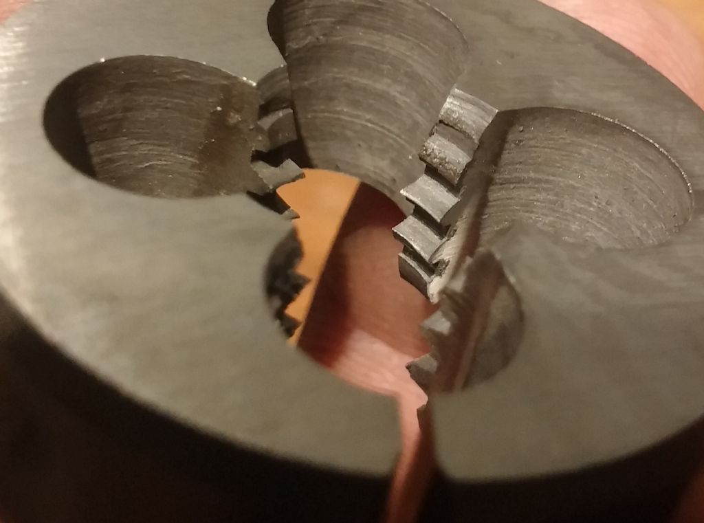

      Just looking for some opinions. Received this brand new ACME 1/2 x 10TPI HSS die from one of the mainstream ME suppliers today. Any thoughts on the quality, and its ability to form a decent looking ACME thread.
      The intention was to thread 90% of the depth using a form tool on the lathe and clean up with the tap. The test piece I have just run with it came out less than ideal IMHO.
      Thanks for the advice. I'm pretty sure this will be returned to the supplier tomorrow.

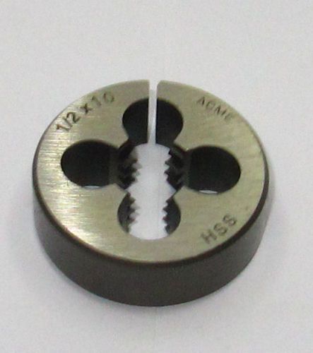

                    Actually, here's the picture from the vendors website. I'm not overly convinced the one they photographed was much better than mine. I'm certainly not picking out any flat crests on the cutting teeth there.
                    Thanks
                    Graham

                        Never used an ACME die to cut threads but is it possible that it's supposed to look like this ie different teeth cut different parts of the thread? The ACME thread form has deep valleys and sharp corners, so a different approach may have been taken. Have you tried using it? Could you be thinking too much?
                        Murray
                        Sorry – I see you DID try it. May be crap finish but still supposed to (otherwise) look like this.

                          Send it back,it looks rubbish to me, bought a tin box of drills a couple of years ago,25% were either ground off centre or wrong point angle, a Whit tap bought in a set shattered as soon as I used it,and further back I bought a bsp tap which jammed solid in the hole as there was negative clearance on the cutting edges. The suppliers take them back with no hassle and replace,they know that there are faults in their products from far away lands and unfortunately use the customer as their quality control.If I was cutting an acme thread for a feedscrew I would screwcut to finish size,its just a case of getting the form on the lathe tool correct or if you cannot get it right then finish off with a thread chaser held in the tool post same as the single point tool,if its a long slender feedscrew then support it with a travelling steady to keep the depth of cut constant,

                            Posted by Muzzer on 14/01/2015 09:21:46:
                            Murray
                            Edited By Muzzer on 14/01/2015 09:24:13
                            Murray,
                            I did try it yes. I had run the piece on the lathe to 90% of the depth with a single point tool first. Then ran the die down it. Prior to running the die, the trough in the thread had a reasonably flat bottom. The first pass left a groove along one side of the trough. I reversed the die and ran it again, this time it put a groove in the other side of the trough. So i'm left with a W shaped trough.
                            When I first looked, i had thought like you, perhaps to keep the stresses down, each tooth cuts its own slightly different V, all at slightly different positions in the trough so the end result is a "reasonably" flat bottom. But I don't think this is the case.
                            Thanks
                            Graham

                                  I tried sharpening the picture and the die pictures in it HAS got flat tips to the teeth, but much more pronounced at the cutting edge. It may not win prizes but should make a better thread than the one you have.
                                  I would be surprised if the supplier doesn't exchange or refund, but give them a chance to put things right, they haven't got the time to inspect every item before it goes out, and a duff item is a pain for them as well as you.

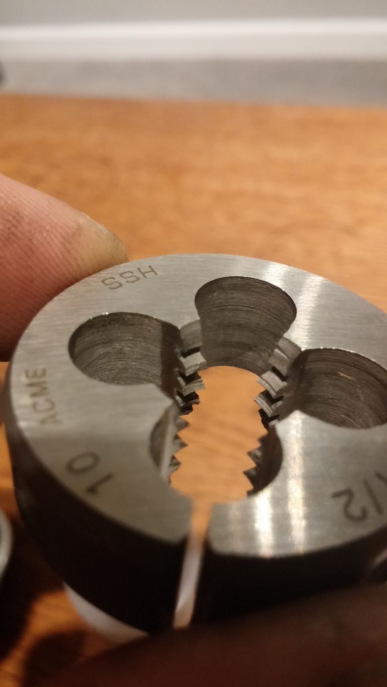

                                    Supplier promptly sent me a replacement die.
                                    Which produced a much better result on my test piece.
                                    Result ! smiley
                                    Graham

                                      Graham,
                                      That looks much healthier !!

                                          I think the first die may have been through the cutting process twice.
