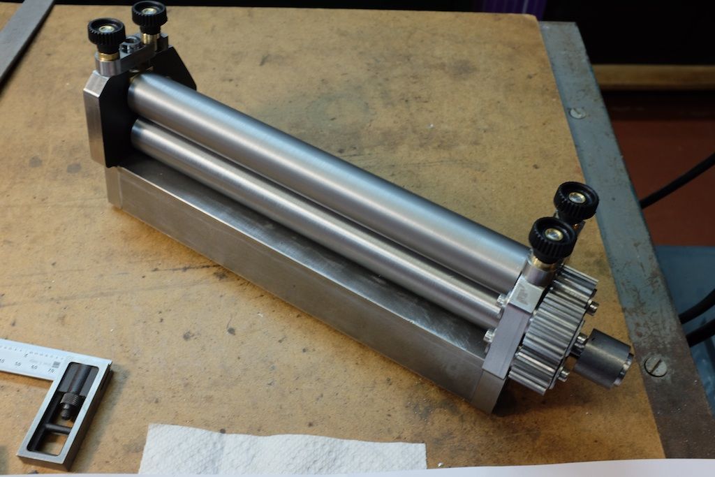

                                  Hi Bruce;
                                  Regarding my blog and the Hemingway Rolls kit, if you follow this link, I think you'll find entries with the word "rolls" in it. There is a search box in the top left corner (or, should be!) – this is Googles' "blogger" site and I'm no expert in it.
                                  Here's a link with a search: **LINK**
                                  The CNC conversion was fun; actually, all of Model Engineering is fun!
                                  Another of my Hemingway Rolls construction pictures:

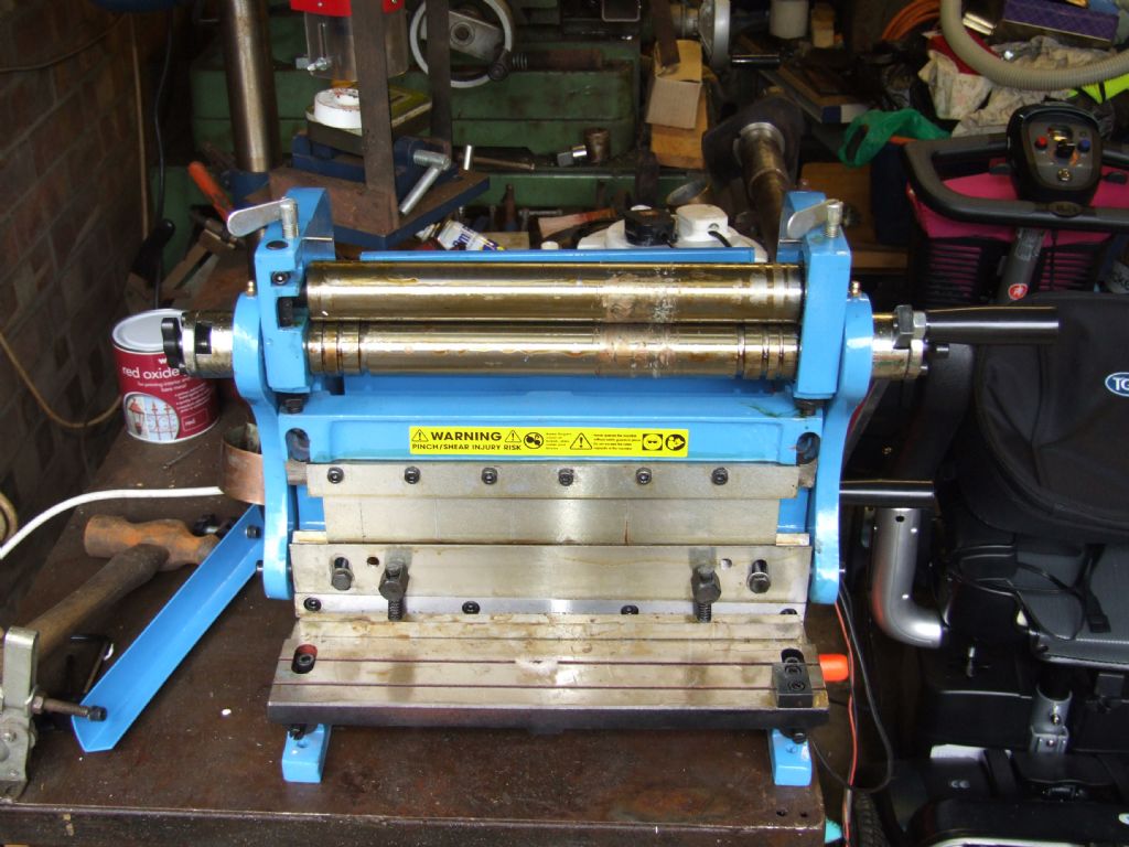

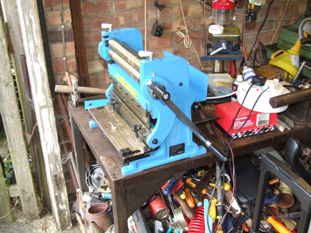

                                    I make fuel tanks for my Lister's and have been using a modified mangle and angles for bending but this weekend I treated myself to one of these 3 in 1 machines, a guillotine, box bender and rolls, it has a maximum material size of 1mm but for what I need it fits the bill.
                                    Martin P

                                      Nice Martin yes
