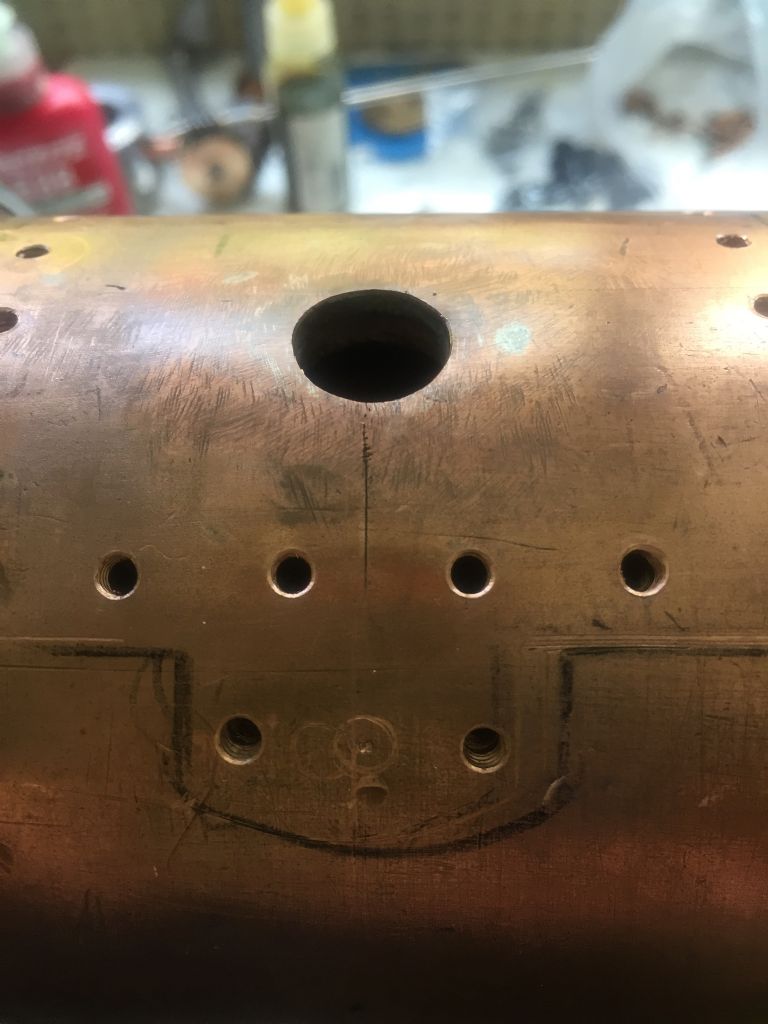

                          Afternoon all, what a lovely day out.
                          so I tackled the job I’ve been dreading for months, drill the cylinder fixing hole.
                          now as you are aware I have no pillar drill or mill so I’ve had to do these by hand and a jig I made to hold the drill at the correct angle.
                          and other that the boiler blanking hole I’m all done, drilled and tapped.
                          however I’ve come across one issue which I hope isn’t a game changer, the previous boiler maker I think placed the strengthening plate slightly further round the barrel than he should.
                          im pretty sure it’s not my cylinder position or it’s holes, however 4 fixing holes have missed the plate and tapped just into the boiler shell! Now is that going to mean boiler ruined?

                              Its just the 4 top ones, every other hole seems to have hit the plate..
                              Edited By derek blake on 24/08/2019 14:34:53
                              #425790
                              derek blake
                                @derekblake72550
                                I’d actually say it’s probably my fault not the previous builder, looking in the holes I’m just hitting the edge of the inner
                                plate, if my holes were 2mm or 3mm further round boiler I’d of hit it, so maybe my cylinder saddle is too slim.

                                  Do you think it will be OK? It’s a real shame as everything was going well but I guess I’m worried so little thickness for the stud the grip will mean it strips. frown

                                    One dodge that could be tried, to reduce risk of stud thread pull- out in the thinner sheet, is to fit a screw in from inside, rather than a stud from outside. This depends on whether there is room between shell and firetubes to get them in, held on a bit of wire dangled through the big hole. You would need to saw a screwdriver groove across the ends of the screws to wind them out through the shell with a jewellers screwdriver. Just food for thought.

                                      Hi Jeff
                                      i did wonder about stud/bolt from the inside but there no room to get inside.
                                      its actually a pain because all the drilling and tapping went well, especially as I had to use a hand drill.
                                      the threads haven’t stripped yet, but I just wonder how tight they will go on final bolt down of cylinder and what I do if they do give way.
                                      as the studs are in a line I did consider loctiting in the studs and adding nuts after, but not sure if this would strengthen or weaken the situation.
                                      i guess silver soldering them in would be ideal but no chance I can attempt that sad

                                            That's a real downer. You might just get away with it but at the risk of investing a lot of further effort only to find that the cylinder / boiler joint can't be well sealed. Also, a boiler inspector, assuming that he knew, might not be very keen on the departure from the published arrangement.
                                            If you put in studs prior to mounting the cylinder, I think that you would find difficulty getting the studs through the cylinder flange unless you elongated the holes in the flange rather a lot and I don't see much real benefit.
                                            My feeling is to consider drilling out the holes, say 6-7mm, countersink, and silver solder in 4 bronze bushes to be drilled and tapped. Not a too difficult job for someone who has boiler making expertise, and perhaps oxy-propane kit for localised heat. The bushes could be filed to blend with the boiler outer surface.
                                            The existing threads need protection whilst soldering
                                            Perhaps the local club has someone who can help. Best of luck.

                                                Thank you for your suggestions guys, unfortunately both wouldn’t work for me.
                                                its been a year with my boiler away and I struggled to get it to where it is now so going out for soldering is a no no.
                                                and looking inside the fixings I can’t get bolts in from the inside as the strengthening plate is in the way, when I tapped the holes it tapped into the edge of the plate, so one side has just the boiler thickness to grip and the other the boiler thickness and the edge of the strengthening plate.
                                                this means I have no flat surface for an internal fixing.
                                                its a blinking pain, I’m tempted to throw in the towel without sounding too dramatic, as this boiler has been the pain of my life for a year now sad

                                                    If when you make the Studs/bolts don't tighten the die down too much so you get as tight a fit in the thread as possible you may well be OK
                                                    Even if the head of a screw inserted from inside sat partly on the edge of the thickening plate that would not hurt so worth giving Jeff's idea a go even is it is a pain to get to you may want to try turning the tread off the then of the screw so you can poke the plain end through the hole before screwing it in (outwards)
