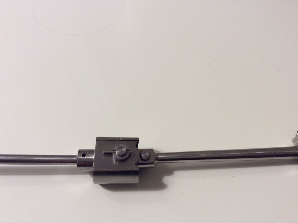

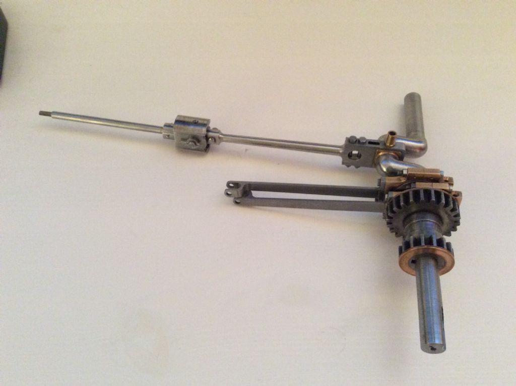

          Hi All
          A small selection of Allchin progress pictures added for anyone who maybe interested.
          Regards
          Derek
          #383850
          Brian H
            @brianh50089
            That looks nicely made Derek.
            Brian

                #383868
                Mick B1
                  @mickb1
                  Tidy and very attractive work. Keep going.

                  derek blake
                    @derekblake72550
                    Many thanks Mick
                    Will upload more pictures soon..crosshead turned on lathe and also flat sides.
                    Not skilled enough to make as separate parts and also have no millng machine yet.🙏

                                #384445
                                derek blake
                                  @derekblake72550
                                  #384446
                                  derek blake
                                    @derekblake72550
                                    Small amount of progress today, finished crosshead not perfect but happy with results considering it’s only one piece and not a silver soldered version as per drawings.

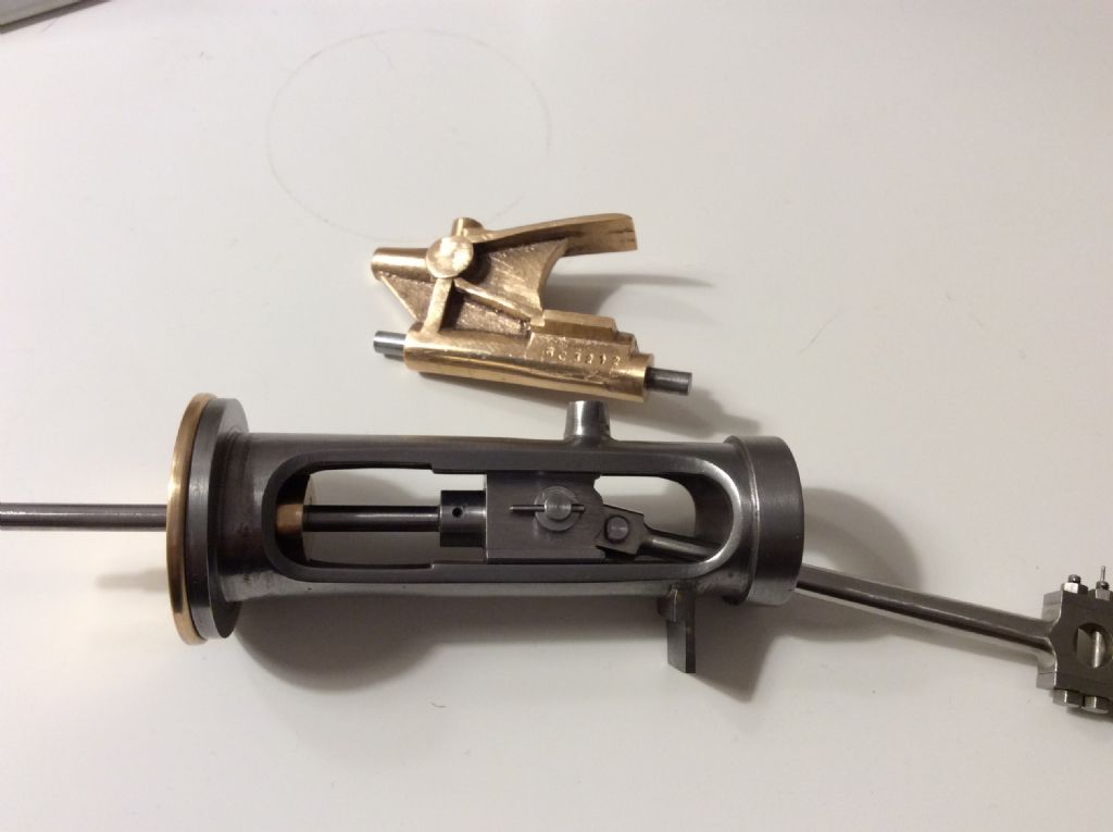

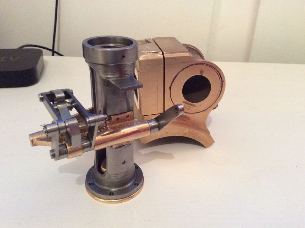

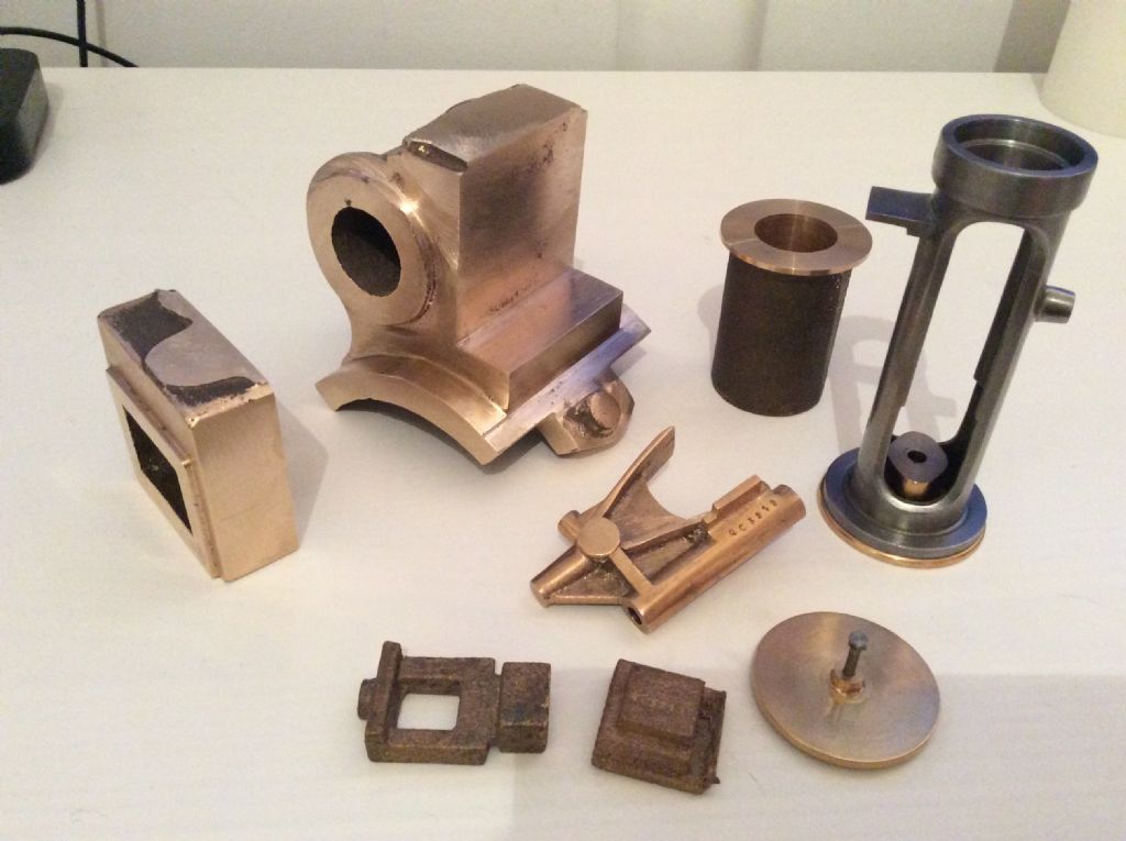

                                    #387961
                                    derek blake
                                      @derekblake72550
                                      Merry late Christmas to everyone.
                                      So I’ve done some more work on the cylinder and parts required for it to be finished.
                                      Now I have a small question for anyone, is there anyone who has built the Allchin before and would consider finished my casting for me?
                                      Now I understand that’s unlikely but I wanted to ask before I committed to some quotes I’ve had.
                                      I thought it maybe worth asking in case I could get it done slightly cheaper.

                                                  #389212
                                                  derek blake
                                                    @derekblake72550
                                                    Happy new year to you all.
                                                    Christmas has come and gone but a little more work done on the cylinder, I still intend to send away for boring and steam hole drilling’s as I’m not skilled enough for that part nor do I have the right size lathe, however I have pretty much finished the trunk guide etc.dbfa74be-9cba-4f09-b76b-9d5e146f16b5.jpeg
                                                    #389213
