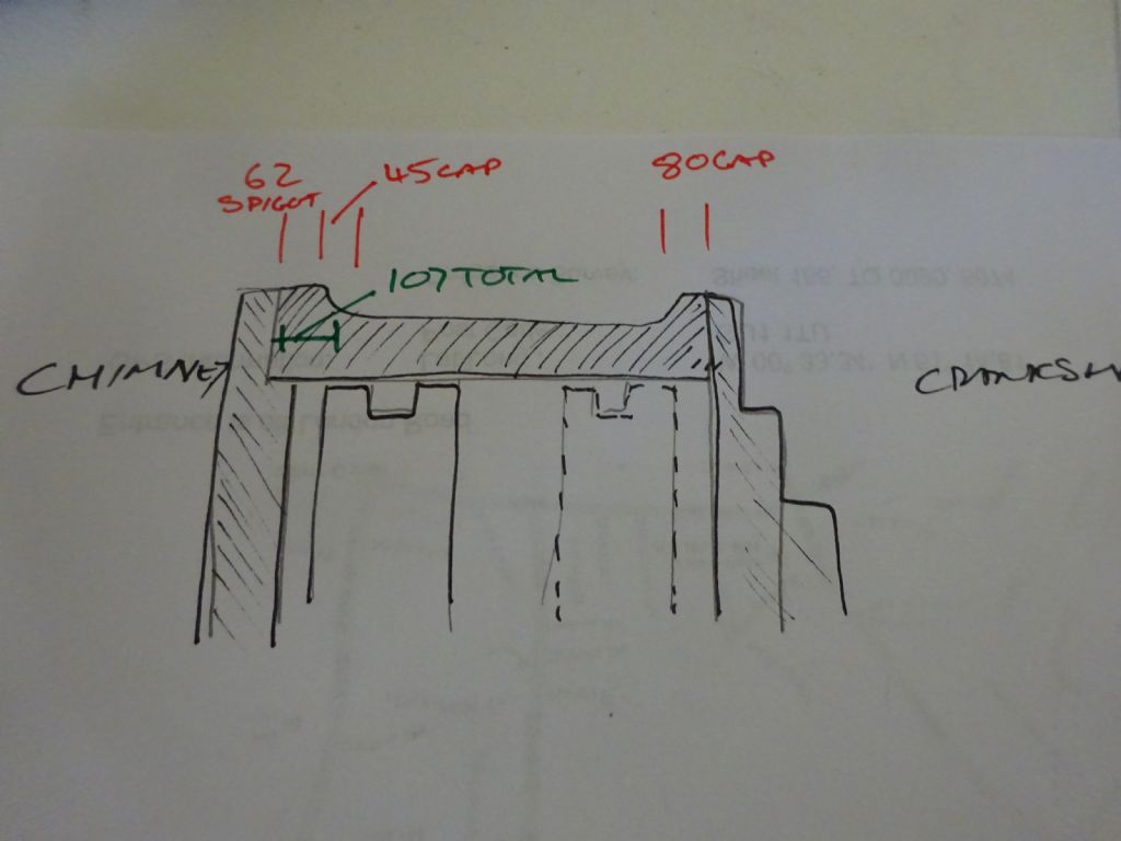

                        Many thanks Jeff, so I have another question.
                        Sorry to keep asking everyone but I'm looking to line up the cylinder on the boiler and have positioned where I think it should be.
                        however my piston comes out the end of the bore, I've checked the lengths of the piston rod, piston and all seems perfect or near as dam it.
                        I'm not totally sure how much gap you need to leave each end of the bore, should piston end up a couple of mm in from the end, or go right to the end?
                        I did know id struggle with this part of the build, if I get one end of the travel correct it seems to hit the cover the other end.
                        Regards,
                        Del
                        #425468
                          You should aim for an equal amount of clearance from the cylinder covers each end when in steam so a little less at the back (chimney end) when setting it cold.
                          Drawings show cylinder 2.094" long less front cover spigot 0.062 gives 2.031" clear cylinder length
                          Piston 0.406" long + stroke 1.500" = 1.906"
                          2.031 – 1.906 = 0.125" divided by 2 gives 0.062" or 1/16" clear from covers at each end.
                          Therefor when hot piston should be 1/8" in from the chimney end and in 1/16" in from crankshaft end. Doing it cold I would say something like 0.107"  (45 + 62) from chimney end and 0.080" from crankshaft end
                          Edited By JasonB on 22/08/2019 10:53:08

                              #425479
                                Derek, I'm just going to alter what I posted, got the cover without a spigot the wrong way round.
                                #425480
                                derek blake
                                  @derekblake72550
                                  that's Ok Jason, when I say spigot I mean the 1/16th lip that sits inside the bore on the chimney end cover.
                                  #425482
                                    This should make it clearer for cold setting.
                                    Once in steam as the boiler expands the cylinder will move away from the crankshaft so everything moves to the left but the piston does not so the 45thou gap will increase and the 80thou gap will decrease and hopefully end up equal.
                                    #425486

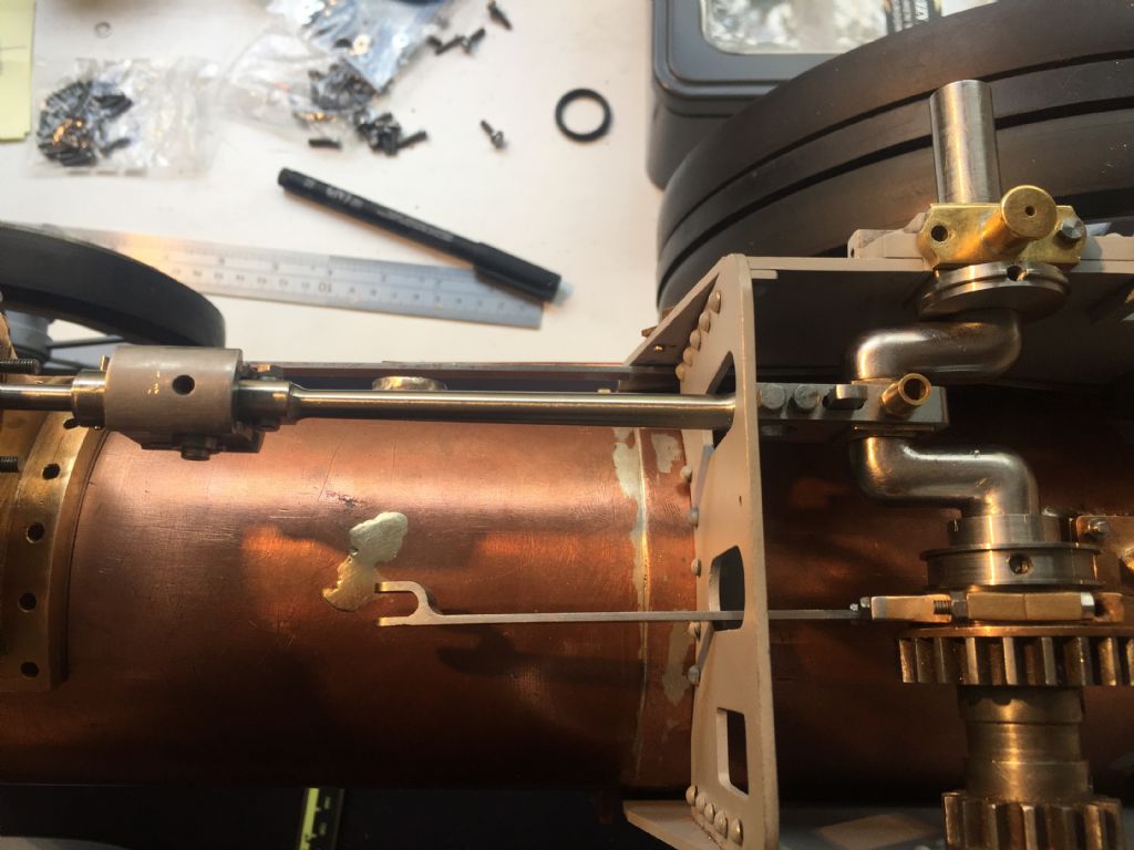

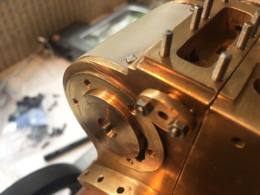

                                      derek blake
                                        @derekblake72550
                                        Hi Jason
                                        so I set my cylinder as per drawings, and with crank full over as per picture piston sticks right out of the end of bore as seen in other picture, to correct this I’d have to move cylinder right up against smokebox.
                                        very odd I wonder what’s wrong as all the measurements seem correct to drawing.

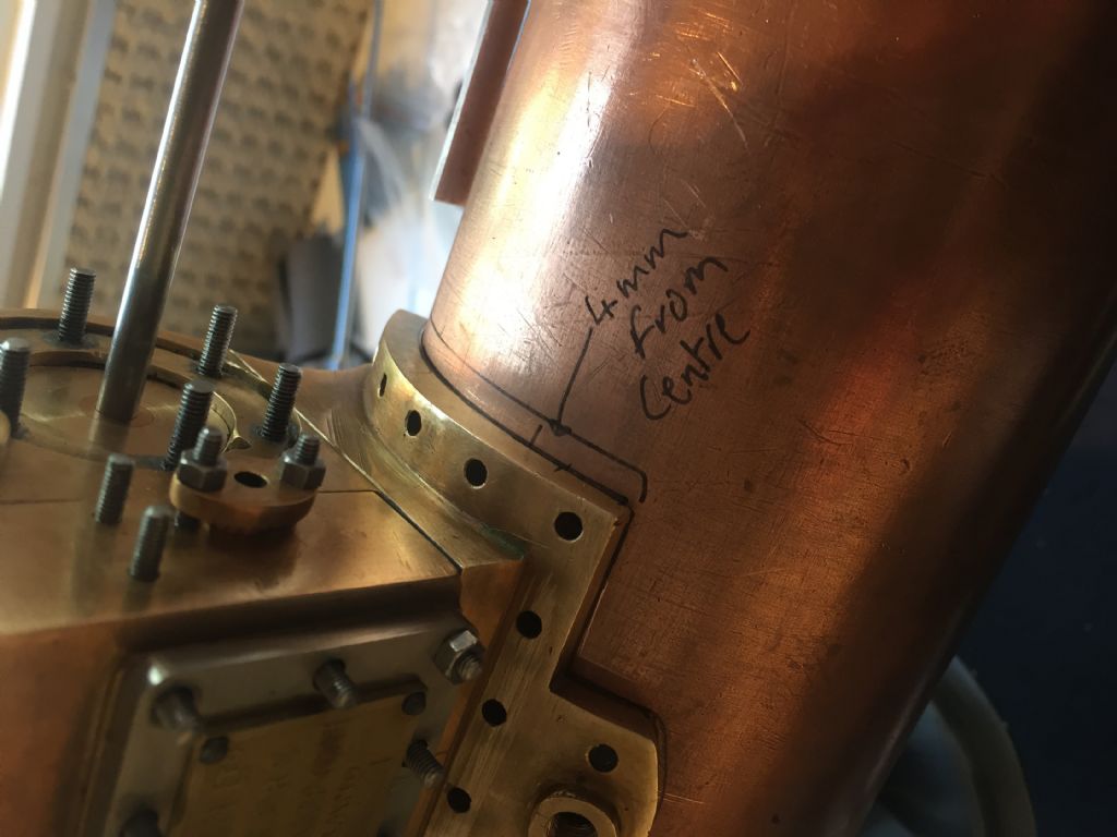

                                          derek blake
                                            @derekblake72550
                                            I have noticed my cylinder saddle is 4mm too wide but I still have to put cylinder out from being central to make it fit, maybe that’s fine,
                                            regards
                                            Derek
                                            #425548
                                            derek blake
                                              @derekblake72550
                                              image.jpg4mm towards the smokebox to get piston in correct position 🤔
                                              #425553
                                                How does the cross head run in the trunk guide with the piston in those positions, if the cross head comes too far towards the crankshaft the piston rod may be too long.
                                                #425554
                                                derek blake
                                                  @derekblake72550
                                                  I will set up and take a picture Jason
                                                  #425558
                                                  derek blake
                                                    @derekblake72550
                                                    Because my Hornplates have bigger fixing I managed to pull the boiler forward by 2mm, I now seem to be just 2mm from centre over steam hole, do you think this will be ok?
                                                    The crosshead seem to come to a good position at both travels, as I guess as long as the piston travel is correct the cylinder can be slightly forward or back on barrel?
                                                    i appreciate the help.
                                                    #425563
                                                      Yes
