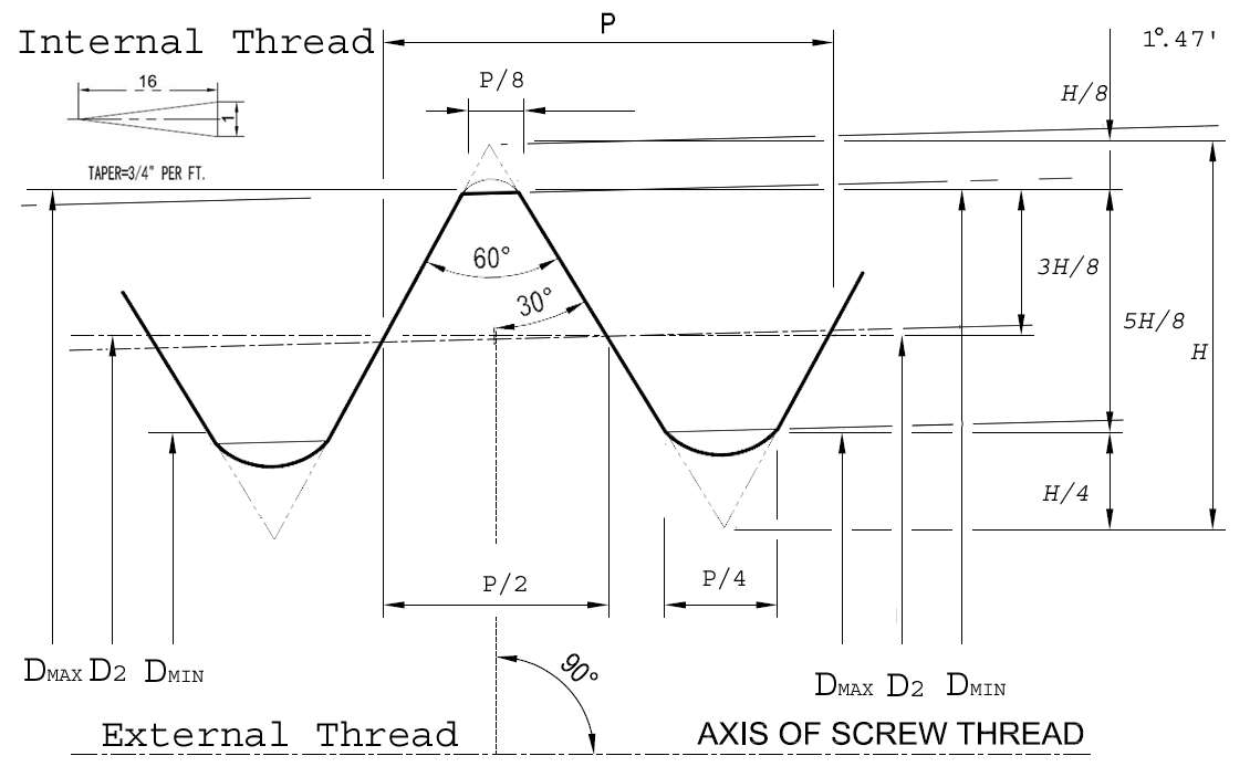

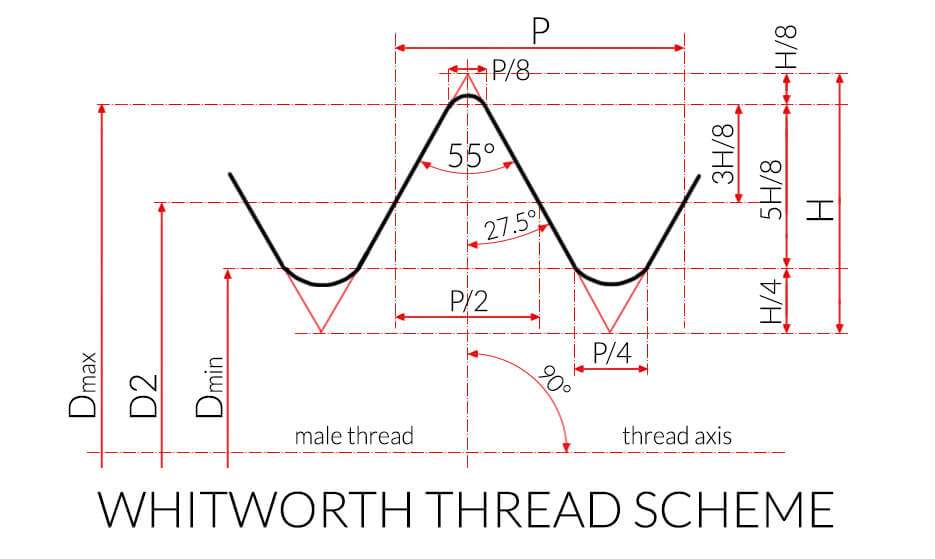

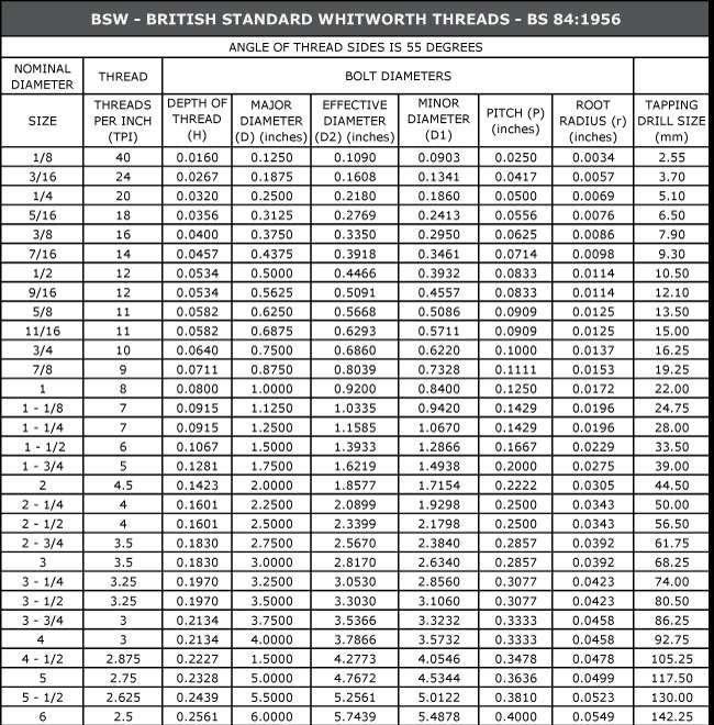

                                      I don’t understand why this topic has focussed on UNS and proprietary threads!  What Andrew describes is consistent with WHITWORTH, as suggested in the very first answer from Andrew Crow.
                                      Confusion is possible because Whitworth Threads are standardised for two reasons, and the thread form is used in both contexts.  Whitworth form is shown below, note the rounded tops and valleys:
                                      Whitworth-Thread-Scheme
                                      The form is applied separately to standard sized fasteners, as in this table:
                                      BSW-THREADS
                                      When applied to nuts and bolts, the form and fastener dimensions both apply.   But Whitworth form threads can also be applied to objects that aren’t fasteners.  Things like Blowlamp fittings!   Manufacturer aren’t obliged to follow the fastener dimensions: they can put a ¾” 18TPI Whitworth thread on a brass tap if that suits their purpose.   The standard fastener dimensions are irrelevant.
                                      Not long after Whitworth introduced his thread, an American defined an easier to make thread form.  Sellar’s Thread became the US standard National Thread, which was Unified after WW2, giving us UNC, UNC and UNS.  It has a number of advantages over Whitworth, one being flattened tops and valleys.   The thread angle is 60°, and took the form pictured below, or something like it. Standards  changed over time, and a bit murky, but I think I’m correct in saying that Sellar’s originally allowed V valleys, then flat, and since WW2 UN allows rounded too.   Rounded threads are good for sealing pipe connectors, these are not fasteners!.
                                      npt-thread
                                      Metric form is similar to the US system, also with a 60% thread angle, but specified with metric dimensions and pitch.   BA is metric with a 47.5° thread angle and rounded tops and valleys.  BA and Metric also standardise fastener dimensions.
                                      All thread forms have been used on stuff other than fasteners.  If that’s been done, the fastener size standard won’t identify it.  I think Andrew’s blowlamp is an example.  Although standard Whitworth nuts and bolts do not come in ¾” 18TPI Whitworth, his lamp is still threaded in Whitworth form.
                                      Using a standard thread form on other than fasteners isn’t really proprietary because the form conforms.  Proprietary involves changing the form, angles and dimensions.  Sometimes done for good reasons like anti-vibration in aerospace or anti-tamper, and often for bad, such as deliberately forcing owners to buy costly proprietary spares.

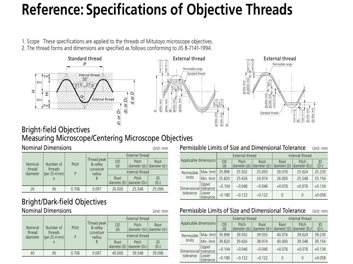

                                      #821709
                                        Just to add a little to Dave’s notes … Here is a properly specified description of a manufactured Whitworth-form thread
                                        … from those who still know how to do a job !
