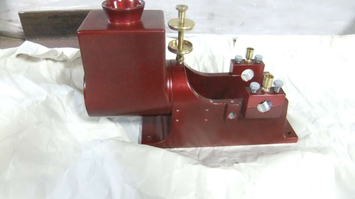

          Dalboy
            @dalboy
            After some advice on here I used etch primer followed by car auto paint then a coat of petrol resistant clear coat also for cars
