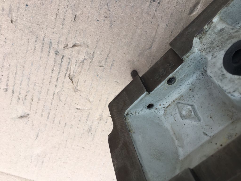

      What is it for?
      #481154
      Grindstone Cowboy
        @grindstonecowboy

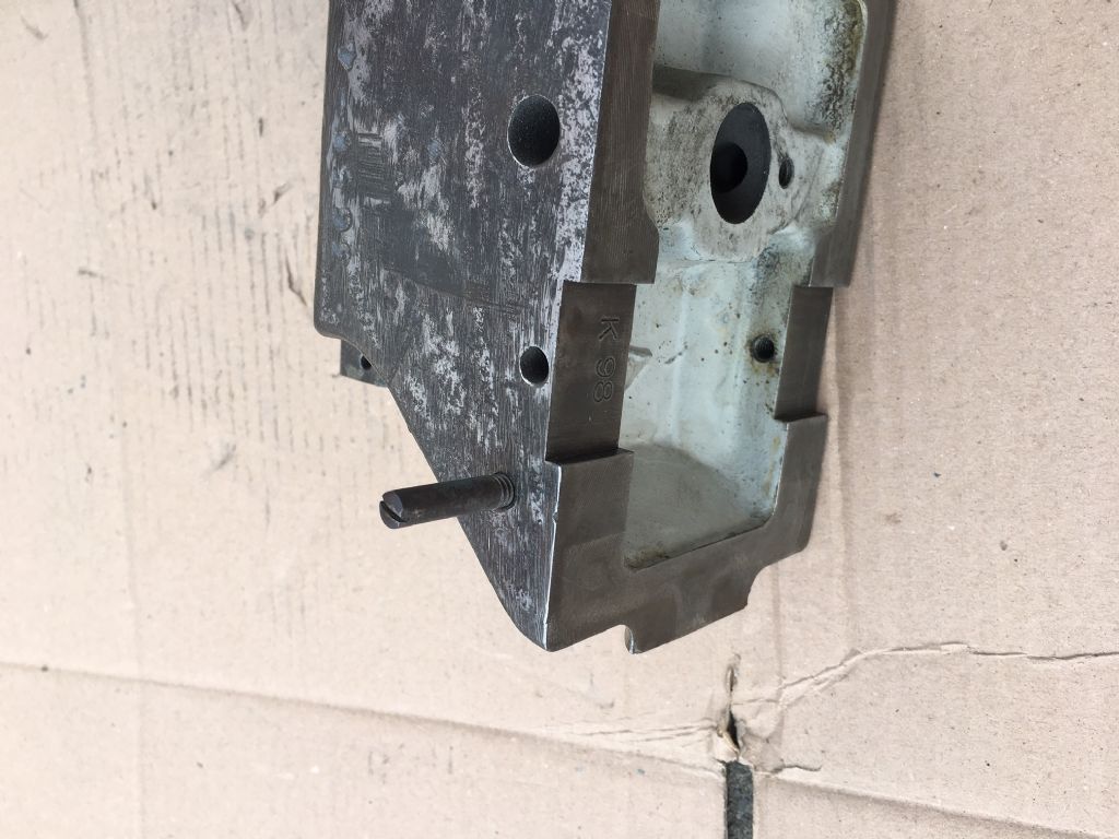

        I'm sure someone will know the answer to this, but it's got me stumped – what is the extra screw on the rear side of a Boxford (Model C Bench type) for? That's the slotted on in the photo.
        Pretty sure it's an original fitting – the hole it fits into is plugged by something that does not appear to be removable – no slot or hex recess – so it just sits there, sticking out about an inch and a half.
        Thanks,
        Rob
        #481155
        Martin Connelly
          @martinconnelly55370
          Does it stop the tailstock clamping lever from going down too far to a position where it hits the carriage maybe?
          Martin C
          #481157
          Gibbo568
            @gibbo568
            I don't have a Boxford, but if it has a lever type lock on the tailstock, (as my Warco has), it could be a stop for the lock lever.
            Gibbo.
            #481159
            Craig Brown
              @craigbrown60096
              I can confirm that it is indeed a stop for the clamping lever as described by the others
              #481165
              Grindstone Cowboy
                @grindstonecowboy
                Oh, don't I feel daft now! How obvious. In my defence, it was off the lathe when I started dismantling it for painting, so not really seen it in position. blush
                Thanks guys.

                    I have just like that on my Craftsman lathe, never knew what it was for [really ] but it does prevent the locking lever from falling down on the bed. And I was thinking about cutting it off !!
