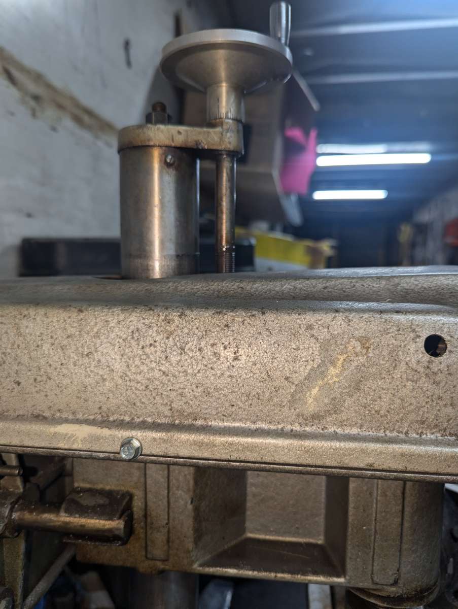

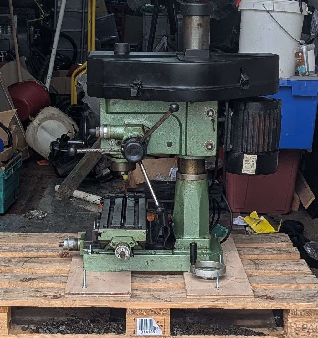

      Hi everyone.
      I require some help with my new/old NuTools md350m mill/drill combi.
      I understand this mill is similar to the sealey/naerok mill.
      My issue is that I loose the tramming on the mill every time I move the column head.
      There is a rack on the side of the column but it isn’t attached it is effectively just snug between the cap and the recess at the bottom.  So when you loosen the head you can spin the entire head around on the column.
      Not something I ever want to happen.
      I seen an picture of a person with a spare column to keep his head aligned.
      Is there anyway to actually just attach the rack so it stays in place.  I could deal with a small offset due to the rack and use a lazer pointer or similar there.  But currently it’s just wildly different every time I move the head.
      Would I sound crazy to tram the head alignment and then glue or bolt the rack to the column at a few spots along it to prevent the majority of the move?
      If anyone has any help or links to any of the articles covering this kind of modification please let me know.
      I will never be using the rotation of the head, and would just prefer ability to move up and down reliably lol.
      Also I see no locking lever on either side only 2 bolts at the back right hand side just behind the lock lever for the motor tensioner.
      Are the 2 bolts to lock it at height when your ready, should there be any quick lock mechanism on it like the spindle quill has. ?
      PXL_20240903_155605999~2PXL_20240903_162055407~2

        Your machine looks rather like the ones that used to be sold by Warco as the Minor or Major. (Probably listed as a RF30 or RF35)
        I don’t think that moving the head up or down the column loses the tramming.
        What it does do is to lose the alignment, which can be a nuisance if the head is moved part way through operations.

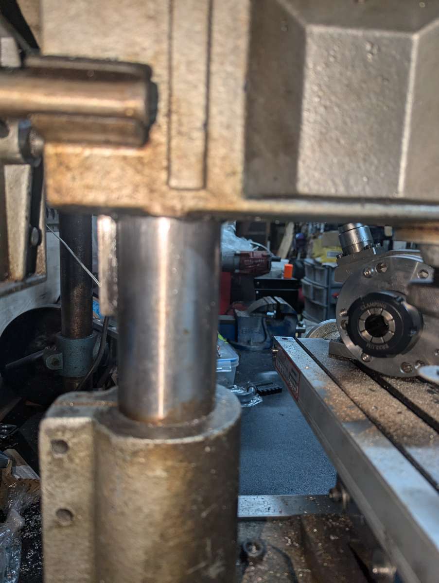

              The Naerok RDM350 is different. The rack is effectively a fixed key between the column and the base, so rise and fall of the column maintains the head on a fixed vertical axis as the key slides in its slot; the rack pinion is on the base. The Naerok head could be loosened on the column and rotated, but I have found no need to do so because, as you say, it would be difficult to get the vertical axis in the same place (this is not a tramming problem, as I understand it).
              #751128
              john halfpenny
                @johnhalfpenny52803
                A picture of the Naerok arrangement.
                20240904_105458

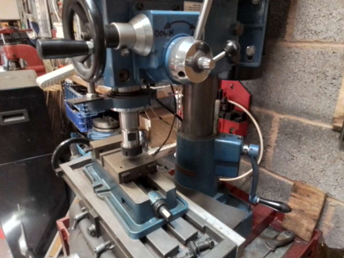

                                      mill pic 1
                                      #751261
                                      Bazyle
                                        @bazyle
                                        If you really insist on moving the head you don’t have to go to all that trouble. The only thing that is going to change is the relationship to the X axis. You would have to be miles out to affect the Y axis.  Just mount a DTI firmly to the quill or hold it in the drill chuck with the measuring finger aligned with the X-axis.
                                        Touch off and zero against the last bit of face you machined to give a YZ plane and zero or note X handle index. You might be able to use the side of the vice jaw as the reference point or you could clamp a 123 block to the table as a semi-permanent location.
                                        Raise head to new position, lower quill and touch off again at your reference point. Note the deviation on the X handle index and compensate.
                                        Before anyone says the movement of the quill is not true to the Z axis then you have a problem to fix before you do any more machining anyway.

                                                  As such I’ll just attach the rack on the flat at the bottom and top for now to keep movement from total rotation to a small deviation. Then I can use any approach from a Lazer, dti, dro or drill rod if I need to pick up a feature again to dial it in.
                                                  Thanks for that point as I really did miss that in my planning.
                                                  PXL_20240904_201129237PXL_20240904_201123266

                                                    Yes, I think they are a good machine – when I bought mine there seemed to be endless articles and videos dedicated to highlighting their deficiencies and providing increasingly complex ‘solutions’ to this perceived problem; some years later, I still haven’t found myself troubled enough by it to bother implementing any of them..
                                                    I did quickly discover that a decent edge-finder was a great benefit for relatively little outlay.
                                                    Nice Amolco!
