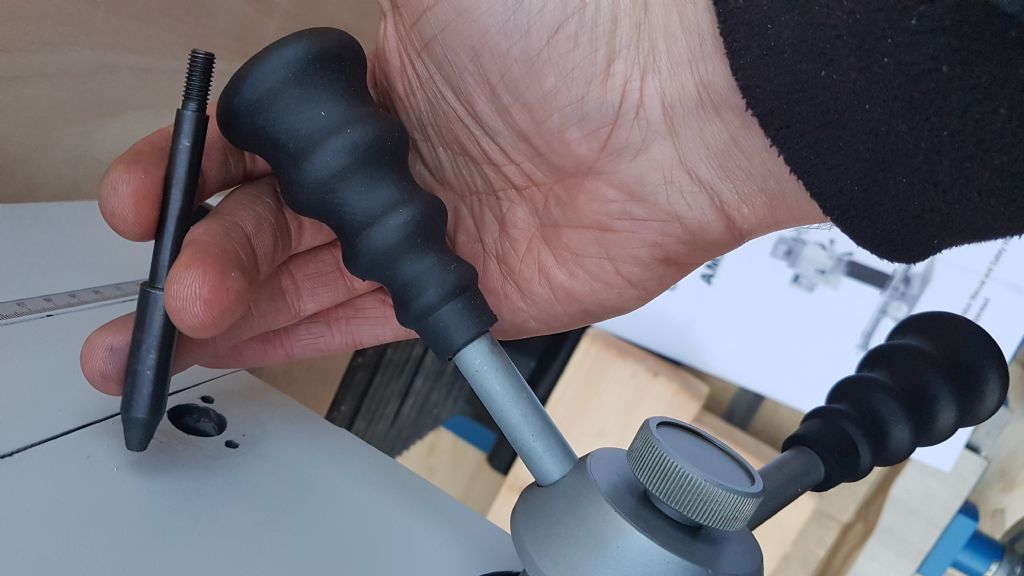

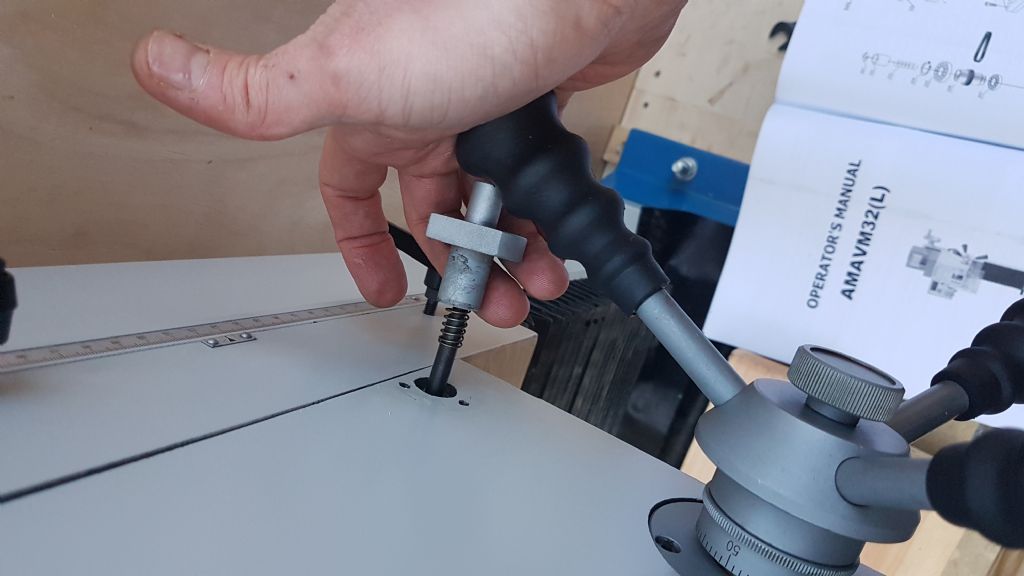

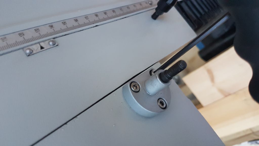

      Had my first mill arrive today which was great but have run into an issue immediately, hopefully someone can help. Tried tilting the head by loosening the 4 bolts attaching it to the column but no joy, saw what I thought was a retention pin (pictured) and removed it, the head started tilting…great stuff….but then stopped at around 45 degrees and now wont move back to upright or any where more than +/- 5 degrees of its current 45 degree position, anyone have any ideas about this at all? Mill is a Weiss VM32L.
      (Have put this one another thread of mine but off topic so moved to here)
      Cheers
      Mark

          Have you read the instructions, I think you are meant to just pull the handle on the pin not take it right out, should snap back in against the spring pressure.
          Also I think you should only have loosened the 3 outer bolts, the central one is the pivot.
          Edited By JasonB on 17/12/2019 19:16:49

            Yeah checked the instructions Jason, I think this version on the 32l is fairly new so nothing covered in the instructions. If I look in the opening I can see the divit for the pin and have fixed it back on again but it did not solve the problem of the head being stuck at 45 degrees.

              How 'loose are the bolts that you have undone? It is possible if they are too loose that one of them has dropped back into the recess that allows them to be fed into the circular tee slot that they run in. Try nipping up the bolts and then just loosen enough to permit movement and see if that allows the head to be rotated.
              Can you post a picture of the head showing the bolts you have loosened.

                  Head tilts 90 deg each way on that one.
                  Pin goes into detents at 0, 45 and 90 deg

                          Not sure why the head should stick at 45 degrees. Some photos would be good. My similar mill has two bolts controlling head angle, and the pull knob disengages a detent to stop it flopping over when the nuts are are slackened. (Pic from a Grizzly Manual; they're often better than ours, even if they can't spell centre!)
                          The top bolt is the axle, the lower nut is to lock the head at the wanted angle. Normally both are done up tight. To move the head, the top bolt is slackened slightly then the lower – not much, just enough to allow movement. Once those two are slackened pulling the knob allows the head to swivel. It's heavy – be careful to keep it under control.
                          Good news is the mechanism is simple – there's not much to go wrong. How loose is the head? Possibly it's tilted forward on the axle and wedged. It may need to be lifted and pushed backwards while the nuts are retightened. Perhaps a two man job, one lifting while the other removes excess slack on the nuts.

                                            PM have a better manual that mentions the pin and shows it in teh exploded view

                                                Looking at the manual posted by Jason, p17 describes the function of the pin you have removed.

                                                      Page 17 gives details for the head removal. Tilting the head specifically states to loosen 3 bolts, not four, so I expect the head is likely jammed on the boss on which it rotates. I may have damaged it sufficiently to prevent movement.
