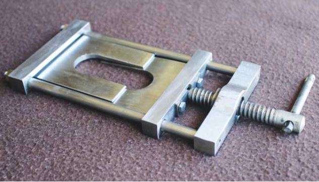

          #825790
          Paul Lousick
            @paullousick59116
            (A design for a taper removal tool was published in MEW No 231, August 2015)
