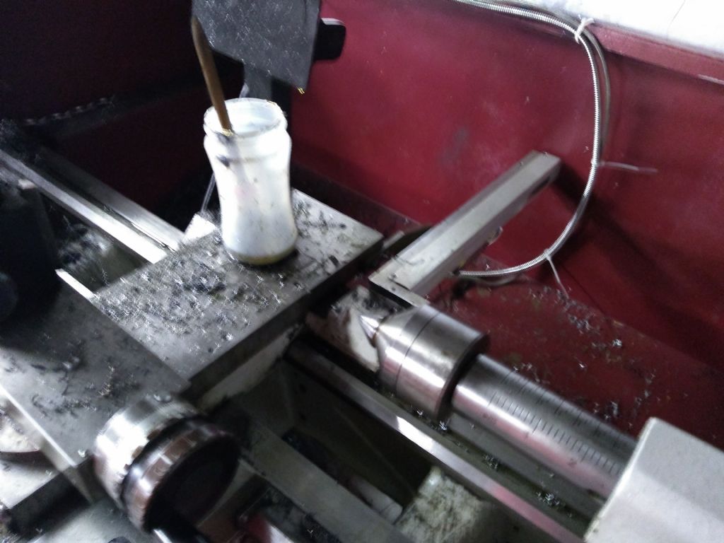

      Hello Has anyone fitted a Newall NMS 300 DRO On a Colchester Bantam MK1? Having problems fitting the cross slide scale, because of the cut outs to get to the compound adjusting nuts. John

          Hi John, can you use an extension perhaps an aluminium extrusion to move the scale backwards so that you can still get to the compound lock nuts. As long as the scale moves with the slide or the reader head moves it dosn' t mater that it is sticking out the back as long as it is sturdy.

            Not a great photo but it'll give you an idea, on a M250

              Hello, Thanks for the idea of hanging the scale over the back there. That is the only way it is going to fit, i thought i was buying a Bantam specific DRO kit two months later and 35 phone calls and it's still not done. The Newall scales are very cleaver. it's a stainless steel tube with ball bearings inside that the reader head reads from. You would think buying British you would get some good instructions. John

                In the past I have fitted these to many machines for 5 meter long boring machines to surface grinders just use the basic clamps and make your own brackets from pieces of ally angle and plate to suit machine. You can get a single ended mount scale but only if you have 12 inch or less movement. Have a look on Newell web site.

                  Not a Newall or a Bantam, but when I fitted a DRO to my Denford lathe of similar size I had to fabricate brackets out of angle that stick out the back of the cross slide. The included brackets didn't really help. There just isn't enough space otherwise. No problems with the z axis but I had to drill and tap holes in the casting.
                  It's stating the obvious but I fitted spring washers and used loctite to all fittings as I found vibrations loosened the screws over time and scales lost accuracy as the fixings had some end play.

                    Newall scales on my Myford S7s amd Harrison M300 all overhang partly to the rear. All single end mounted with own home made mounts. Single ended mount used for Bridgeport Quill DRO

                                    I fitted the smaller microsyn on my Colchester student On the right of the saddle, with a very thin piece of alloy angle to provide a shield. One of the newall black alloy angle mounting bars was mounted in the gap between the bed ways under it, used to stop the tailstock smashing into it.

                                      The thin aluminium  guard came with the set from newall  the mounting at the fromnt is slotted for positioning, the small screw end on holds the end of the sensor bar, which is mounted only at the front .  The cover is held in place with small cks “cap” screwse3e64b6d-bc4b-47b8-b0b3-d8045ad14015.jpegSeems the angle bracket also carries the sensor , it can be seen in both photosSry about the delay went to buy a loco but unfortunately the wheels were loose….. shame, was exactly what I wanted
