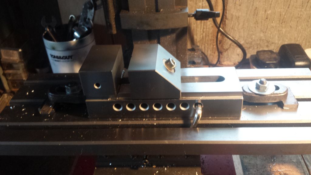

      Hi All,
      Well after much indecision I finally bought the new milling vice and settled on a screwless type shown in the photo.
      Have to say I wasn't sure about this type of vice but there have been some positive reviews on here so I took the plunge and bought one.
      Initial impressions are very good. A good size for the SX2P, it takes a little time getting used to the procedures for adjustment and tightening but once you do it's really simple to use. This one has a 63 mm wide jaw and 1/4 turn of the 6mm. allen key gives a powerful grip on the work with no jaw lift.
      It's similar to the ones sold by arc, and a bit more expensive. The relief at either end, is a feature I liked and which makes for an easy longitudinal setting on the table. It came from Germany, but was made in china, like many are!

        Screwless milling vice

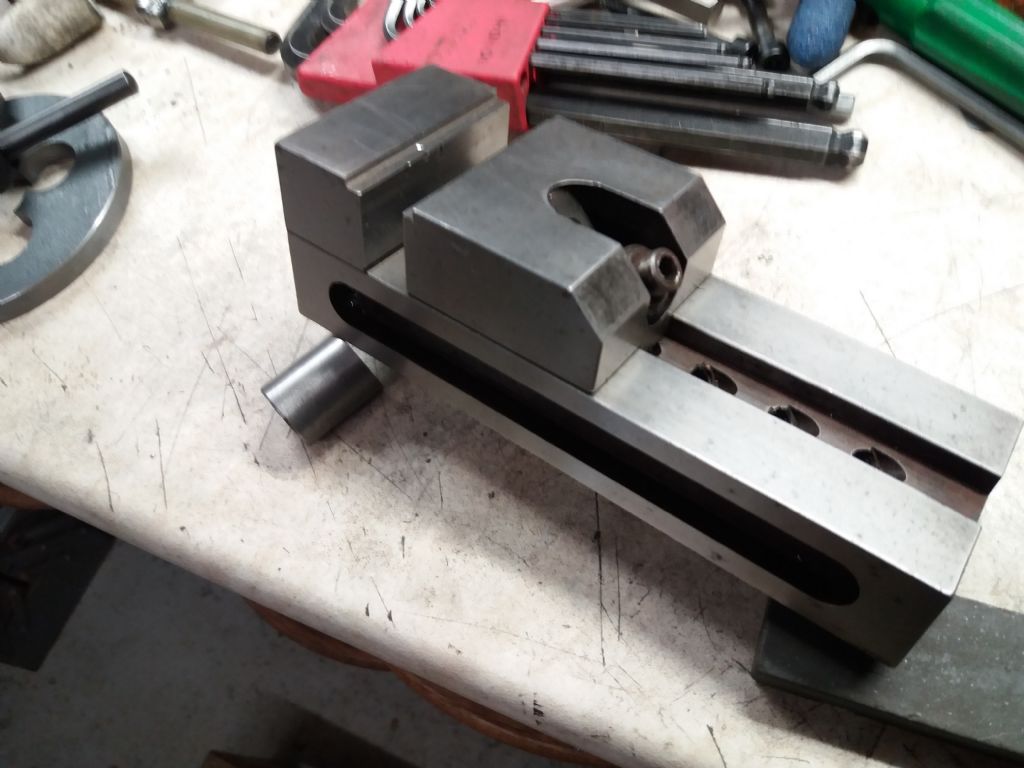

          I have a similar vice I made when at work. Absolutely solid and dead square you can remove a job and replace it with no problems of position etc. I have a small step in the top of the jaws to hold thin pieces.

            A vice of this form was the first which allowed me to machine work square.
            I tried many cheaper models first, it would have saved me money to buy a more expensive vice first! 😀

                My vice is about 40 year old but never reground it and it's still flat and square.

                  I have got two screwless vices and are very satisfied with mine. They are not to large for my milling machine.

                    Hi Thor,
                    That's another thing that I found attractive the compact design.
                    A vice with a long screw would take up more or less the full length of the milling table.
                    I have a big chunky aero engine body to machine. This vice will be A1 for the job.
                    David, your vice, very nice work. I assume it was made during your time as an apprentice.
