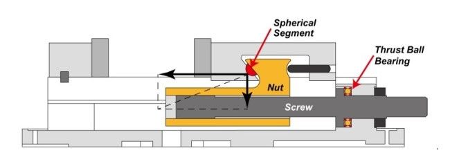

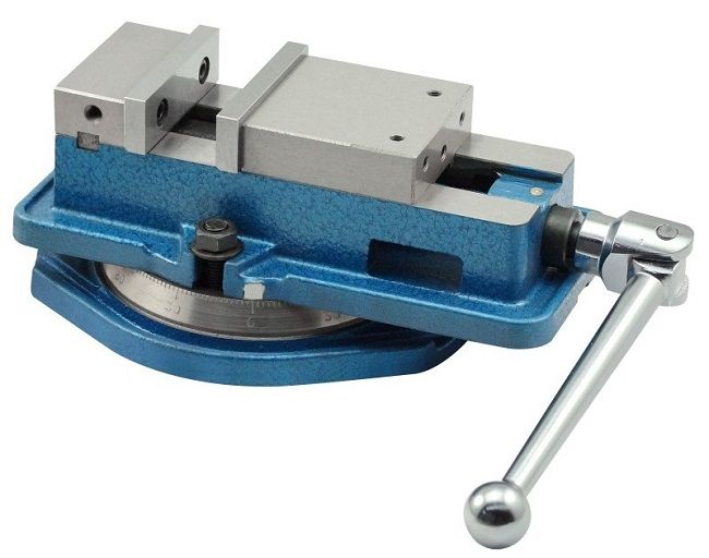

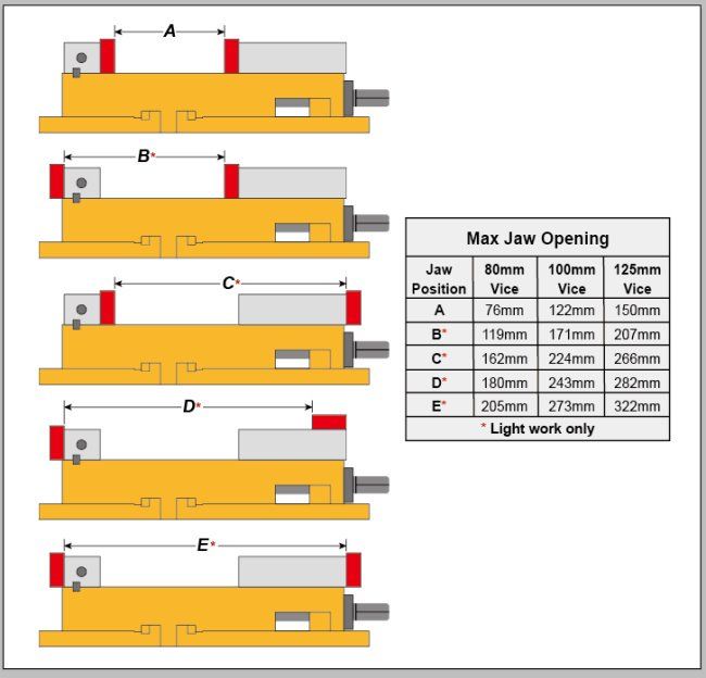

              I originally bought a standard mill vice which came on a swivel base and it has served me well for 8 years. The swivel base is seldom used and I just use the vice and clamp it directly to the mill table. A key slot has been added to the underside of the base for a key which aligns the vice with the mill table slots. Very quick to remove and re-mount the vice for most work..
              Also have a 70mm wide precision vice which I use for those more accurate milling operations. It is also handy when machining parts with a double inclined angle by holding it in the standard vice.
              I am considering upgrading and would like a Kurt vice but my pockets are not that deep and am looking at getting a versatile vice, a clone of the Kurt but much cheaper.
              The advantage of using a precision type vice is the clamping action of the jaws which pull down as the jaws close and not lift as it does in a conventional vice. This also what happens in a Kurt vice.
              The jaws can also be re-positioned and used for light clamping of wider parts that wont fit between the standard jaw position.
              Paul
