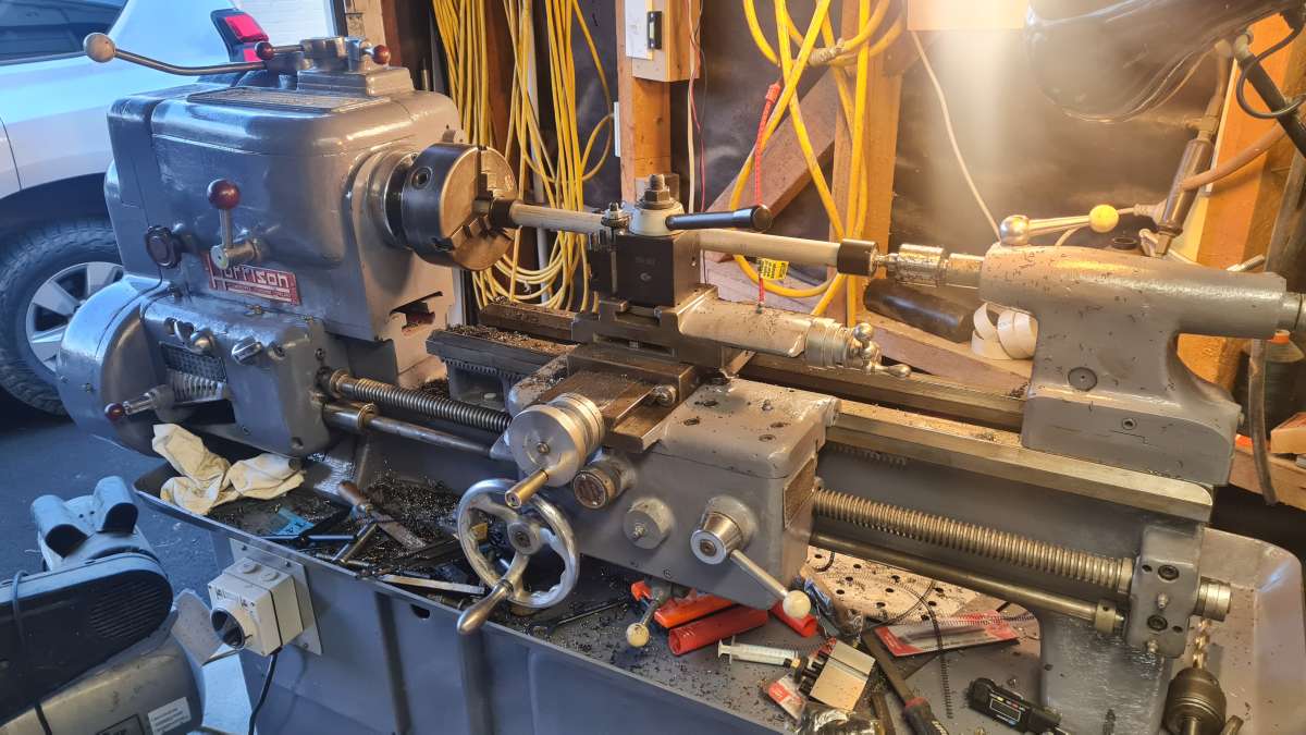

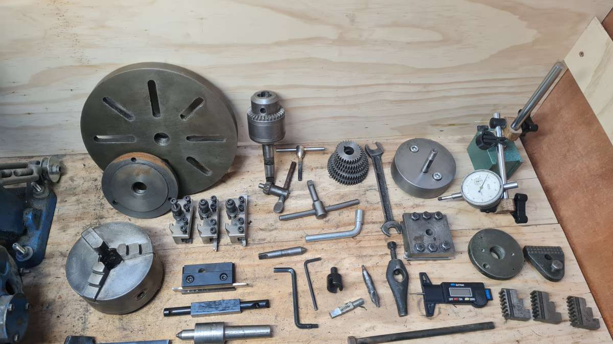

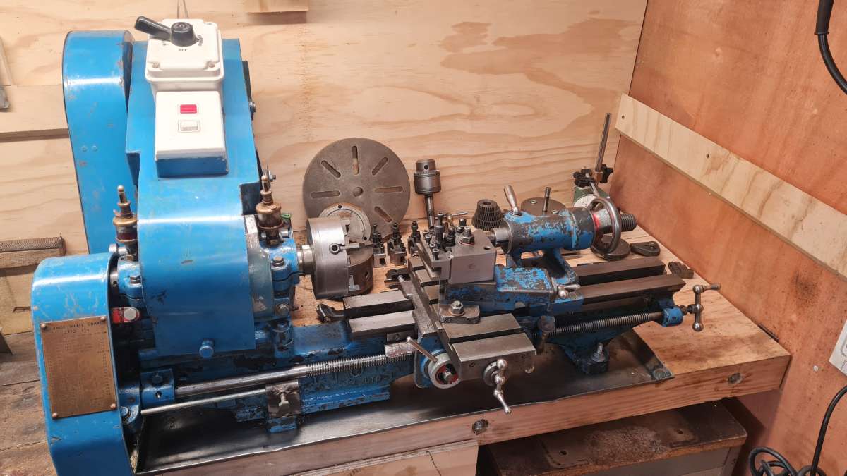

                  Thank you all for the welcome and advice. Funny how things go… since joining here with a Zyto, a Harrison L5A in good condition has come available on the local market and I’ve managed to acquire.
                  Currently have two lathes and looking to sell the Zyto on. Quite a difference in capability, the Harrison just eats deep cuts with carbide and leaves a beautiful finish.Zyto for Marketplace (7)Zyto for Marketplace (5)Harrison home (1)
