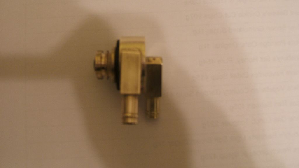

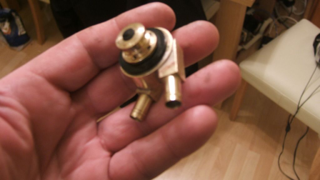

                        dscf3084.jpgPete,
                        I have made a water pump from this site http://www.model-engine-plans.com/engineplans/combustion/howellwaterpump.htm very clever design will mount it off the crank or flywheel depending on the ratio see photos dscf3082.jpg

                        doubletop
                          @doubletop
                          That looks very neat and thanks for pointing me over to Jerry's site. $21 doesn't seem to bad a deal when you consider some of the prices people charge these days
