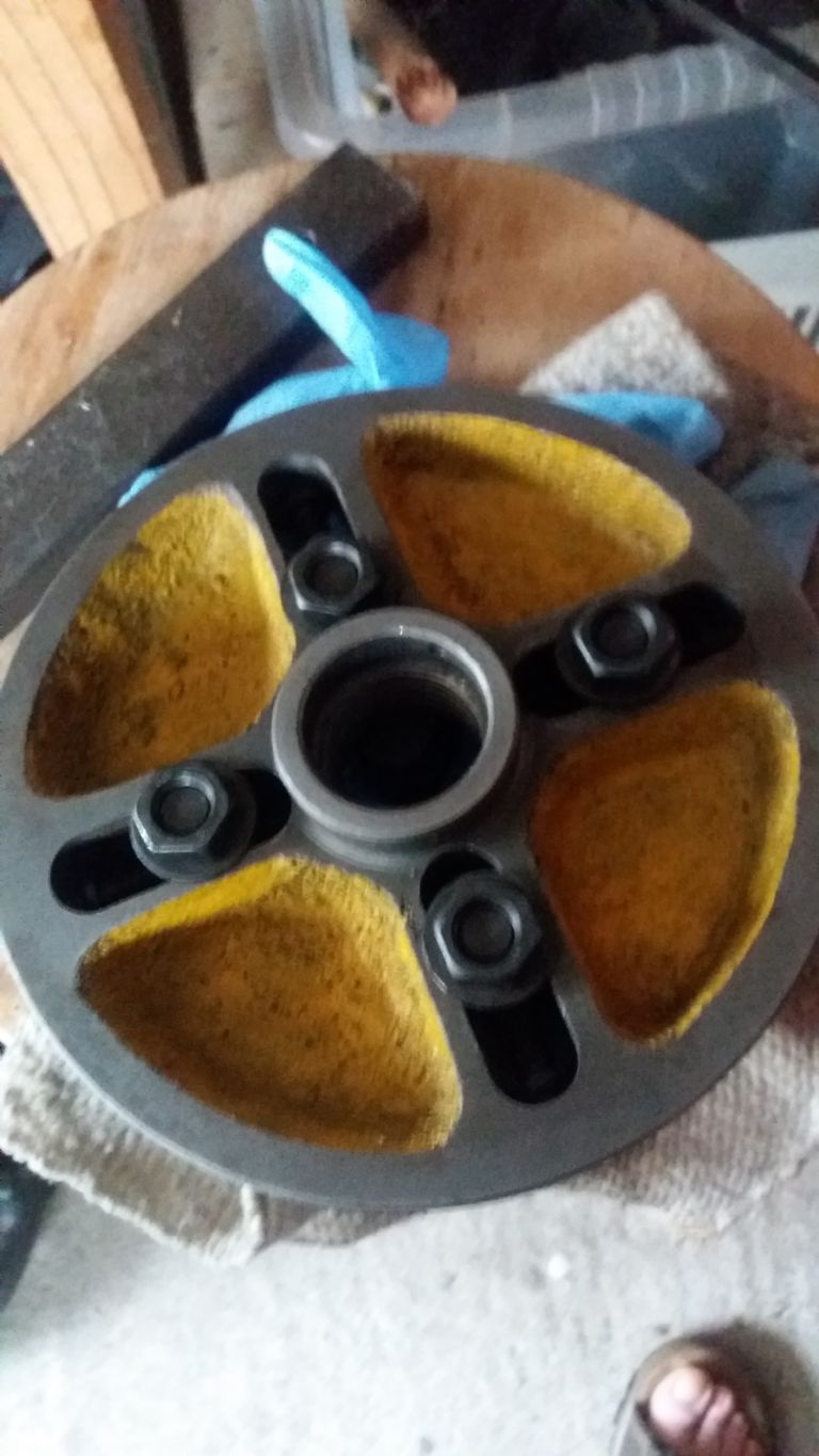

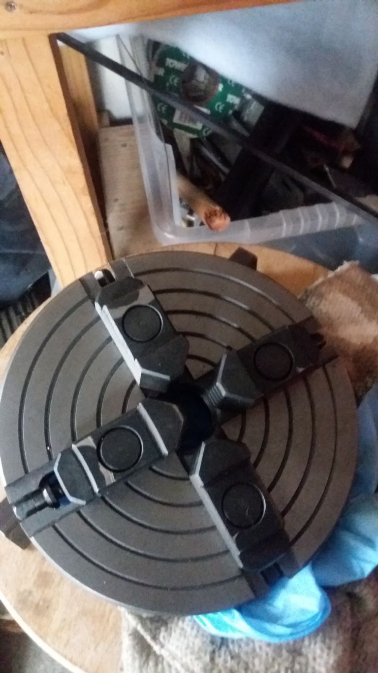

                  #238214
                  Iain Gordon
                    @iaingordon81374
                    003.jpgPhotos of the 4 jaw chuck. As you can see it quite crude. There is so much backlash in the adjusting screws that it is a really tedious job centering work.
                    #238215
                    frank brown
                      @frankbrown22225
                      If this "chuck" is a good fit on the spindle and the problem is the floppy jaws, then turn it into the "new" back plate. This way you can use the good spindle thread. Else your first job is to get accurate sizes of the thread and the register (+-.001" !!). The next job is to get your new chuck and measure its register, its a bit tricky as it will be a small .1" depression about 3/4/5" diameter (depending on the chuck size). This so the chuck body is located centrally before its bolted to the back plate. So the back plate needs a close fitting spigot to align in this depression.
