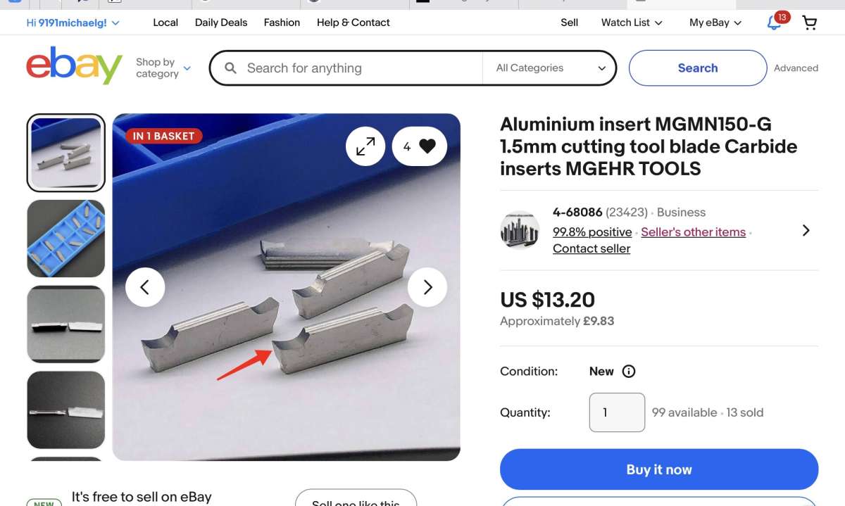

      I have just been looking for some narrow ‘Aluminium-cutting’ inserts to abuse … and came-across this listing on ebay:
      https://www.ebay.co.uk/itm/155695820702
      Before commenting … Please look at all the photos in the listing.
      Could someone kindly explain … have these been re-worked ?

        Looks very much like it Michael mine look like the rest of the photos. But could be an interesting rework.

            The main photo look more like some MGGH ones that I have where there is just a flat top to the cutting edge but the other photos have the moulded tops to curl the swarf so hard to say which you will get.

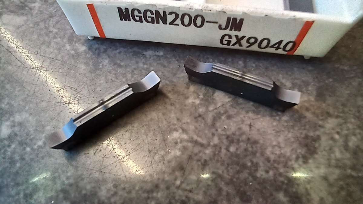

              Here you go sharp MGGN inserts but intended for stainless and other Ferrous alloys so they are not polished like the ones for aluminium as sticking is not an issue with the ferrous metals but do have the typically ground cutting edge to reach the “**G*” tolerance code.

                  Many thanks, Jason … you’re a star !

                    For info.
                    Hello, I’ve found two additional links for you. Could you please check if these are what you need?
                    Reply
                    Your previous message
                    Thank you for the very prompt reply … but NO
                    It is the modified inserts that I want
                    … I have added a red arrow to your photo
                    Is this shape actually available ?
                    Thanks again.
                    4-68086:
                    Hello, I believe the model you’re looking for might be available in this listing: https://http://www.ebay.com/itm/166884467867?var=466557463193<;/a&gt; (eBay item number: 166884467867). Please feel free to check it out, and if it doesn’t meet your needs, don’t hesitate to reach out to me anytime.
                    I am very interested in these inserts.
                    Could you please clarify … Have they been re-worked to the unusual shape shown in photo 1/6
                    Thanks in advance

                      That second listing is much like the ones I showed. Check your messages for polished aluminium specific ones (last on the page)

                          The seller is obviously a shopkeeper and not a machinist with intimate knowledge of his products. And almost certainly relying on Google Translate for the English text in his listings, which is disastrously hopeless  between English and most Asian languages. The results, in my extensive experience, range from laughable to downright criminal.

                            I have some 1.5mm inserts like that, but can’t remember if they have the standard chip breakers. The photo’s show several variations. They would probably need a 1.5mm blade or tool, not any other size.

                                        Not reworked I think.  The retailer has simply mixed up photos of different members of the MGMN family.  The family has at least six variants of the same basic shape and dimensions but with different edges and chip-breakers.
                                        I guess ordering a box could result in a mixture arriving too, because the seller isn’t an expert.
                                        A variety box arriving may not be bad unless the purchaser knows exactly which one he needs.   Manufacturers know because they carefully select inserts to get the required finish from a given material at minimum cost.  And they have the fast, powerful, rigid machines needed to run inserts to specification.  As hobbyists rarely have ‘ fast, powerful, rigid machines’, it’s often impossible for us to run inserts to spec.  And unlike industry, we cut different metals with the same cutter, possibly not knowing exactly which alloy it is. We have to experiment for best results instead, and it may be one of the MGMN variants performs better than the others.
