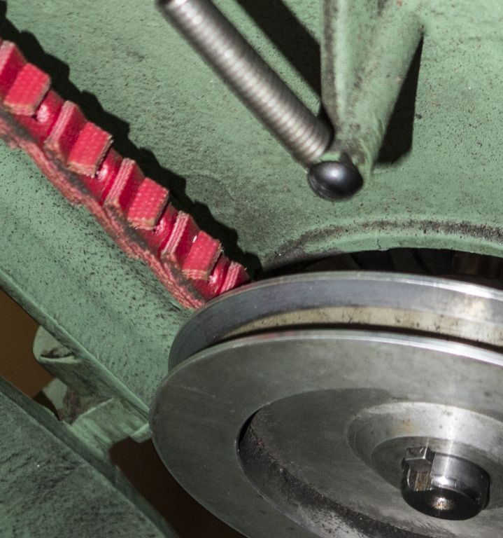

                                      I was always told that the link type belts awear the pulley more due to the metal content of the belt is this true or not as they are as alresdy discussed a lot easier to fit than a standard v beltGeoffre
                                      #132034
                                      NJH
                                        @njh
                                        Hi Geoff
                                        I don't know about the link belts with a metal fastener but I would have thought that the fastener would not be in contact with the metal of the pulley – if it was then sure wear would occur. ( I accept too that the link I posted does show metal joiners but that was not the type supplied!)
                                        To clarify the matter here are a couple if pics of my belt – no sign of wear as you will see.
                                        link belt 1
                                        Here you can see that the joining tabs are part of the belt material.
                                        link belt 2
                                        Studying this photo It does look as if I should do a bit of a clean up !
                                        Good luck – I'm very pleased with my link belt!
                                        Norman
