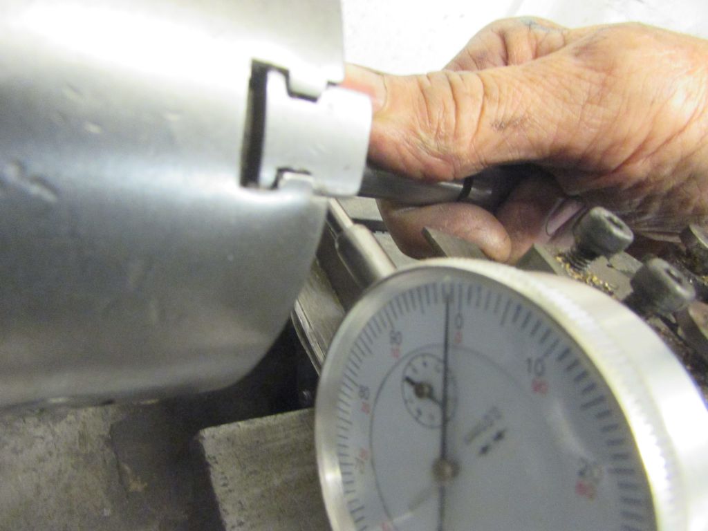

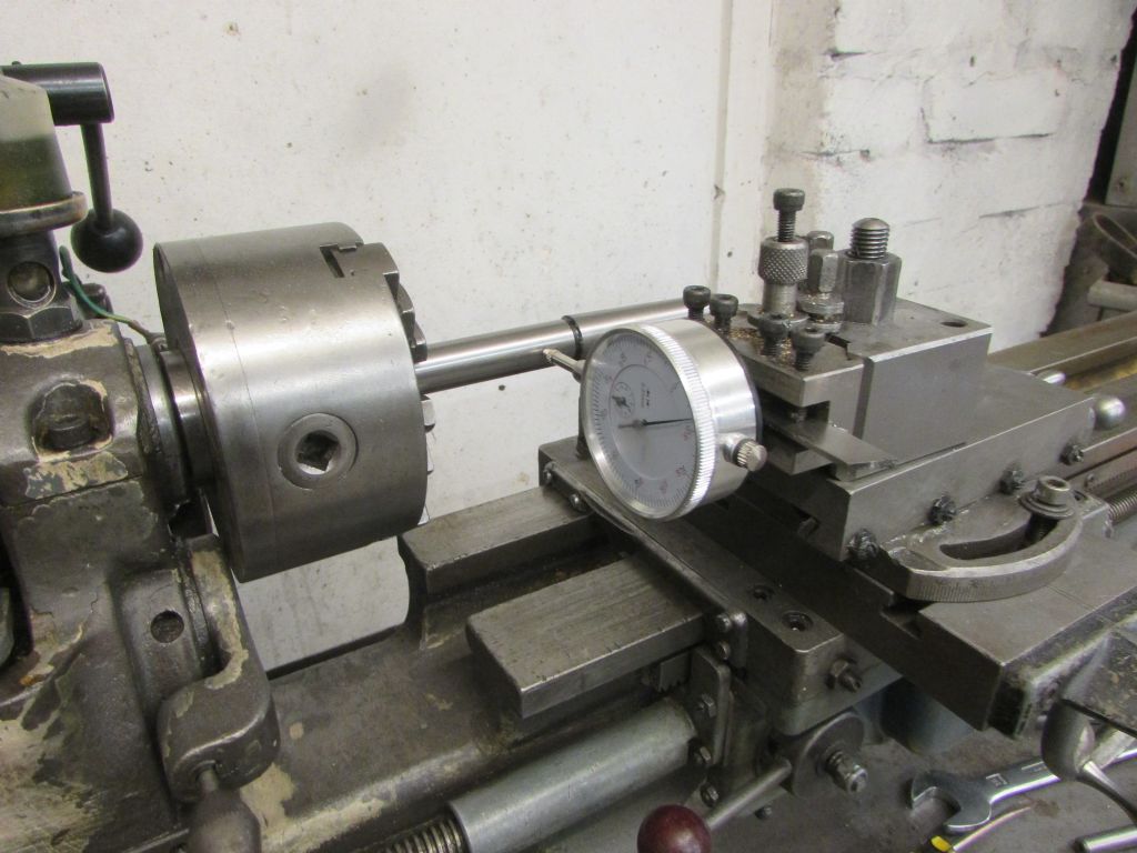

        911 wings 028.jpgHi Guys.Decided that I need to check accuracy of my ML7(serial 41733)
        I knew it had runout.Bolted to floor on Myford stand, with correct mounts.I levelled the bed with engineers level.
        despite my best efforts, the runout didnt really alter, it stayed about .9mm
        then I noticed that by grabbing the test bar,I could get up to 1mm movement on the test bar.I think the movement is behind chuck.Im presuming, I have worn bearings?Any input grateful thanks.911 wings 025.jpg

          A better test would be with the test bar in the spindle MT socket as it would seem a lot of 3-jaw chucks have runout that is far greater than mine.

                      Holding a bar in your chuck doesn't tell you anything about the lathe itself only that the 3 jaw chuck is not running true at that particular diameter.

                          To check the Mandrel, the test bar has to be seated in the clean 2 MT taper of the Mandrel. Using a chuck introduces another two possible sources of error, so that the result says nothing about the Mandrel.
                          Holding an absolutely parallel bar in a three jaw chuck could result in any reading of run out, from Zero to 0.036", depending on how good the Mandrel and the chuck happen to be, based on the ones that I have seen

                                  You need to put the plunger of the dial indicator on the lathe spindle directly behind the chuck then yank your test bar up and down and side to side. If you still have more than one thou of movement there, you have loose headstock bearings.

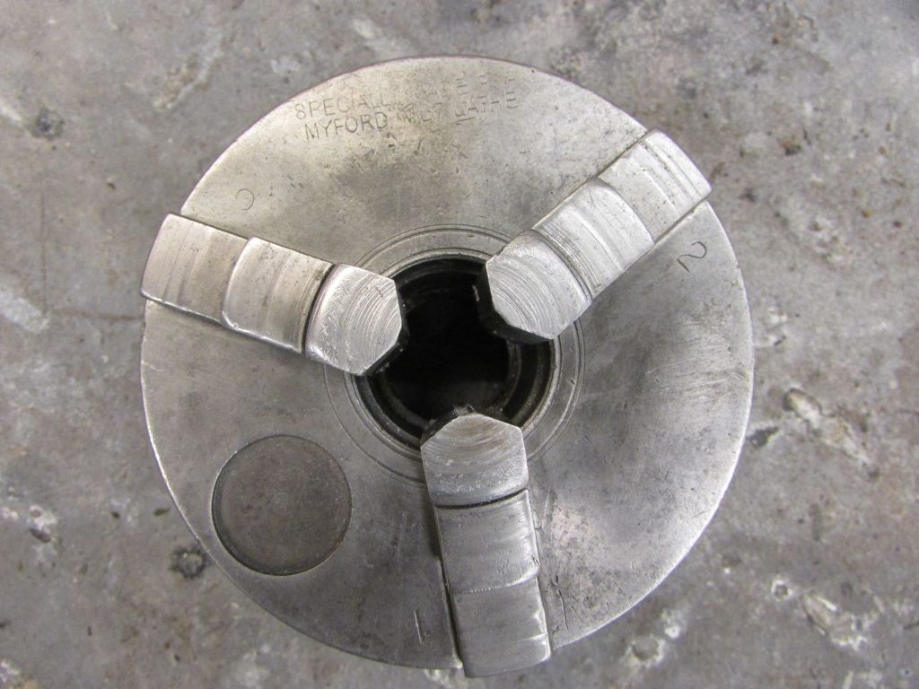

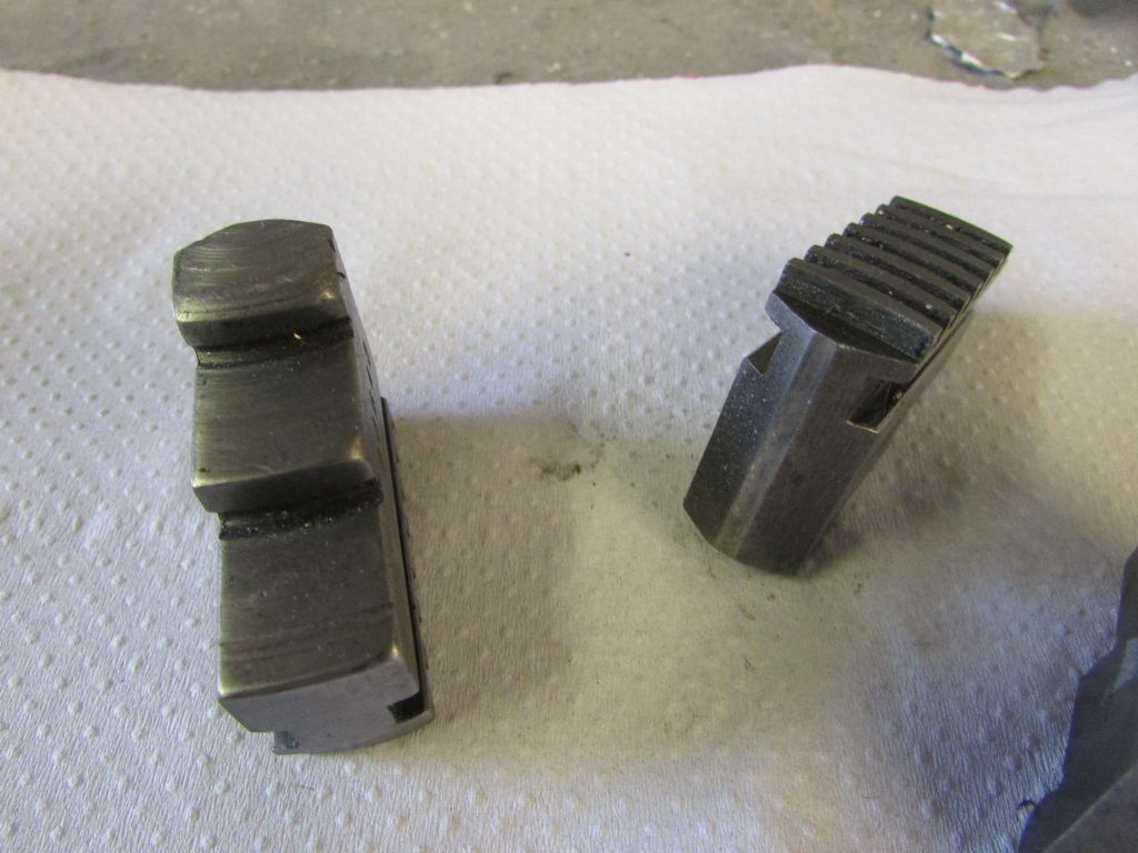

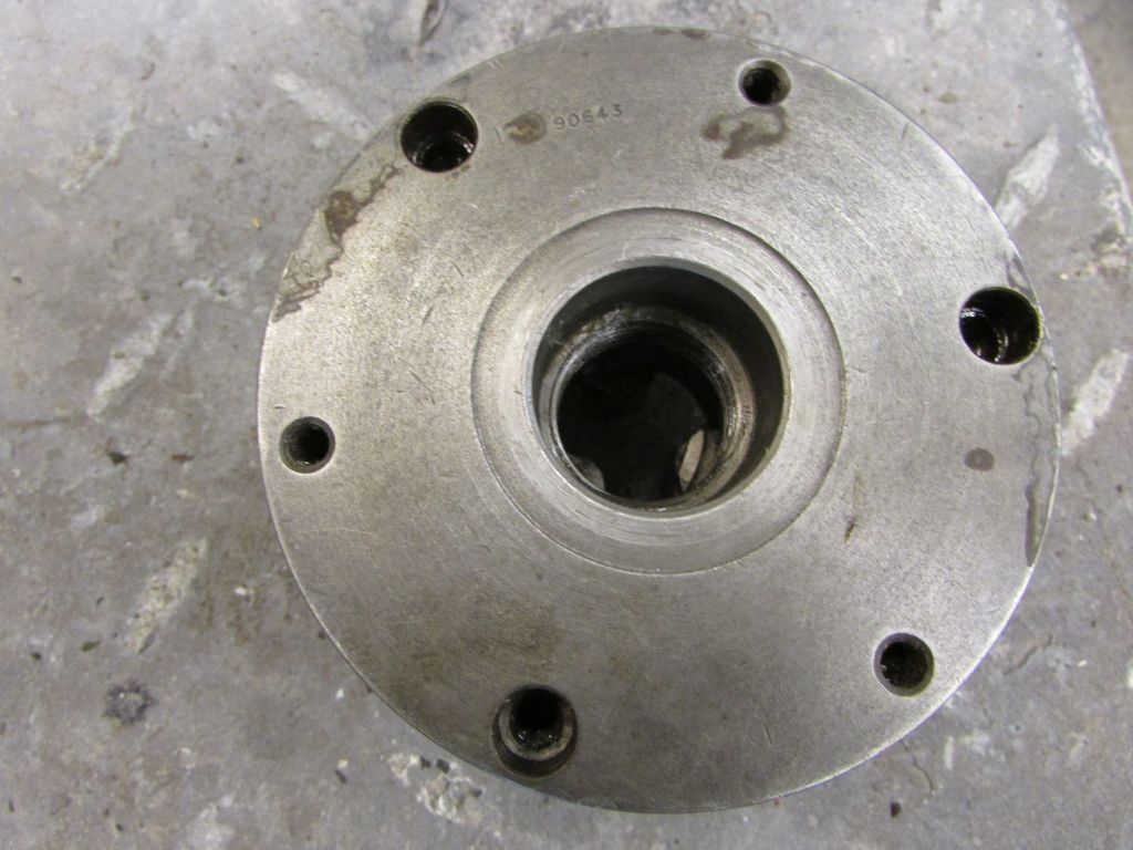

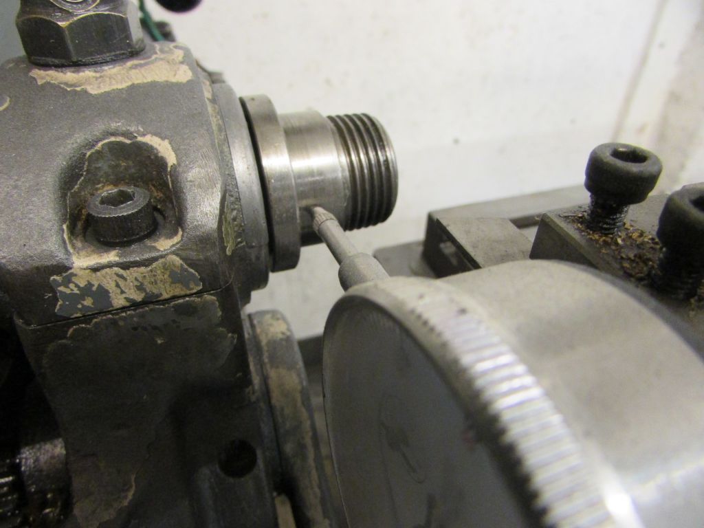

                                            Ok guys finally managed to find some time.Today I removed chuck and checked run out on spindle as suggested.No matter what I did I couldnt get more than 1 thou runout.Happy with that.I did notice that the spindle bearing caps were not pulled down tightly.I pulled them down and as I thought the spindle locked.Then backed off quarter turn and the spindle runs freely.
                                            Im presuming that my issue with run out is the chuck.Pic of it attached along with 2 jaws.It doesnt state a make,but is stamped "Specially made for Myford ML7" If I have to replace it, I presume I will need to reuse the back plate.Any advice on removal of back plate.I removed the Allen Keys.Not sure of what is required next?

                                                The 'made for myford special chucks' do not have a backplate in the conventional sense, what you are assuming is the backplate is in fact an integral but threaded part of the chuck, as shown in the picture below.
                                                You take it apart by undoing the socket screws and splitting the two parts with a hide mallet.
                                                if inconsistent or large TIR is an issue for you the easiest route is to purchase a new chuck (of the non integral variety) and new unmachined backplate, machine said backplate on your lathe to mount your new chuck. dont expect less than 3-6 thou TIR as a repeatable error (you might get better – just don't expect it!).
                                                Your other more time consuming choices are:
                                                determine the cause of the error –
                                                is it badly worn jaws – if so you could attempt a jaw re-grind to minimise the runout, you should be able to reduce it slightly but not remove it entirely (google / utube is your friend here)
                                                worn or damaged scroll – you are stuffed – you can tell by inconsistent runouts at differing diameters if runout is a problem you will need a new chuck
                                                deformed , (ie bent off axis) chuck mount (hard to believe but entirely possible- that was the problem with the one in the picture) – you can tell by putting a dti on the back of the chuck and check for axial wobble – you may be able to effect some sort of correction by shimming the downside on the rear chuck part.
