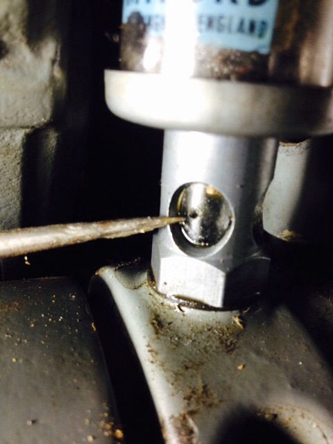

      A coup,e of questions…
      1- The sight glasses on the drip feed oilers each have a small hole in them. If I leave the the needle valve open, the reservoir empties, the oil having leaked out of the sight glass through the holes. At present I'm closing the needle valves when not using the lathe, but wondered if the sight glasses are meant to be o have holes. Seems a little odd, and I know at some point I'll forget to close needle valves when I've finished working (or forget to open them when I start).

                    There are holes in the sight glases? Where abouts?
                    If you leave the levers in the "ON" position, the oil will continue to drip feed just as it does when you are using the lathe, Turn them to the "OFF" postion after use. If you forget you are just wasting the oil and getting an extra mess to clear up.

                        Posted by KWIL on 06/09/2015 09:44:01:
                        There is a 1.5mm diameter hole in each of the sight glasses…
                        Should these holes not be there? (I've never looked for them on other Myfords, and didn't notice them on mine until the oil started leaking out).
                        I could block the holes easily.
                        My drip feeders don't have a lever, just a knurled screw which controls the needle valve. If I screw it up the drips stop.
                        The hassle is when I forget, the reservoir empties through the hole in the sight glass (happened again today when I ran to answer the phone).
                        #203288
                        Bazyle
                          @bazyle
                          Put less oil in so even if you forget less is wasted. those holes do seem odd but not a Myford user. Perhaps the inner sleeve is supposed to be rotated 90 degrees.
                          After all these years surely there has been a modification article in ME or MEW.

                              I removed my drip-feed oilers and fit little brass flip-cap oilers instead. Just give them a squirt when I start work and forget them till the next time.
                              My sight-glass oilers had the flip lever but it never worked well for me. I spent more time adjusting the flow than actually using the lathe and still the sight-glass would empty overnight …. which all goes into the swarf tray of course. (Anything remaining in the current brass flip-cap oilers also leaks through overnight but the volume is tiny).

                                For now I'll just half fill the reservoirs, and Cleese the drip feed when not using (if I can remember).
                                If I forget, it's only a few mls of oil ending up in the drip tray.
                                #203504
                                daveb
                                  @daveb17630
                                  If the sight glass fills up you are either dripping to much oil or the oilway is blocked. It should not have a hole in it.
                                  #203531
                                  KWIL
                                    @kwil
                                    Having a hole in the sight glass should not affect its use, the glass is only there so you can see (ie sight) the drop size, that part should never have a significant amount of oil in there.
                                    #203539
                                    Ajohnw
                                      @ajohnw51620
                                      I'd guess that the hole is there to let the oil drip and also so that the drip rate can be seen.
                                      I found the original myford ones a pain/impossible to set so used them as manual oilers before using the lathe and from time to time if I used it for a long time. Say a bit every hour or so.
