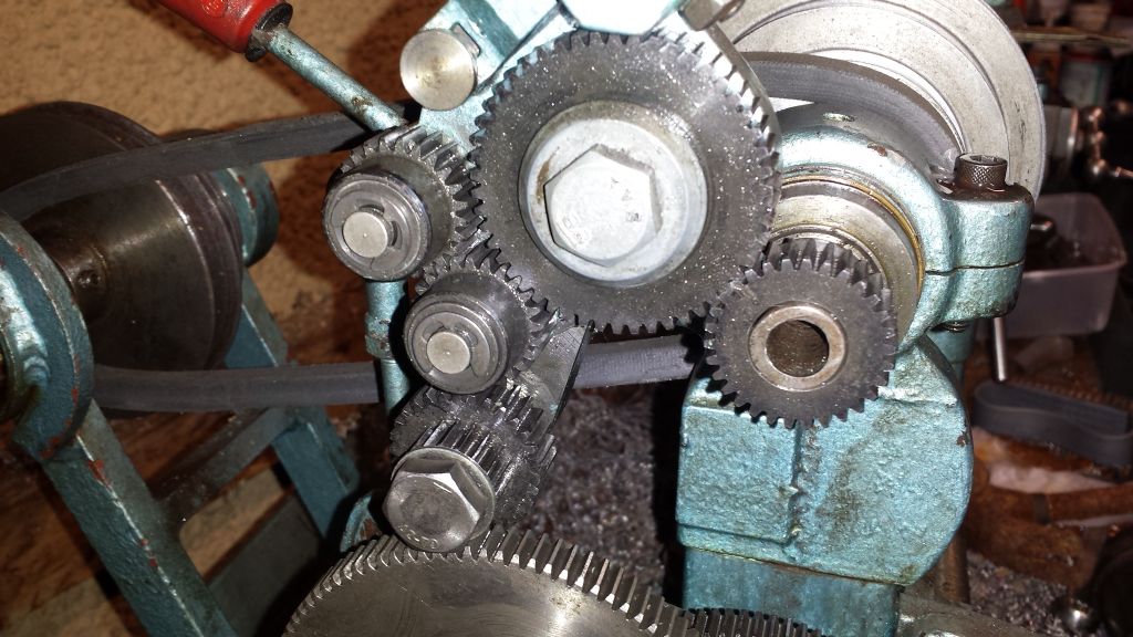

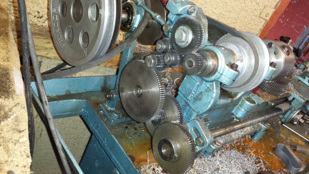

      Hi.
      I'm wanting to start practicing cutting threads on my ML. I have most of the change gears, 1 x 15t on a shaft???, 2 x 20t, 1 x 25t, 1 x 30t, 1 x 35t, 1 x 40t, 1 x 45t, 0 x 50t, 2 x 55t, 1 x 60t, 5 x 65t and one collar. I'm certain I have a 50t as well but I can;t find it and it's one of the gears I need for a 20UNF thread
      Anyway the little chart in my garage says I need a 20t on the mandrel and 50t on the leadscrew and idlers on the 1st (upper?) and 2nd (lower?) studs. When I take the gears of the leadscrew and try and fit a 50t (must have been a 55t) the lower idler can't reach it as it's a compound gear and the larger of the 2 gears prevents the smaller one engaging with the 50t on the leadscrew.
      So I'm wondering just what the idler gears should be. I recently bought the lathe of a chap who didn't really seem to know much about lathes so couldn't give much . On the upper rearmost stud (1st stud?) there's a single peace compound gear with MOD1-100 written on it.

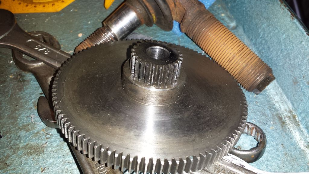

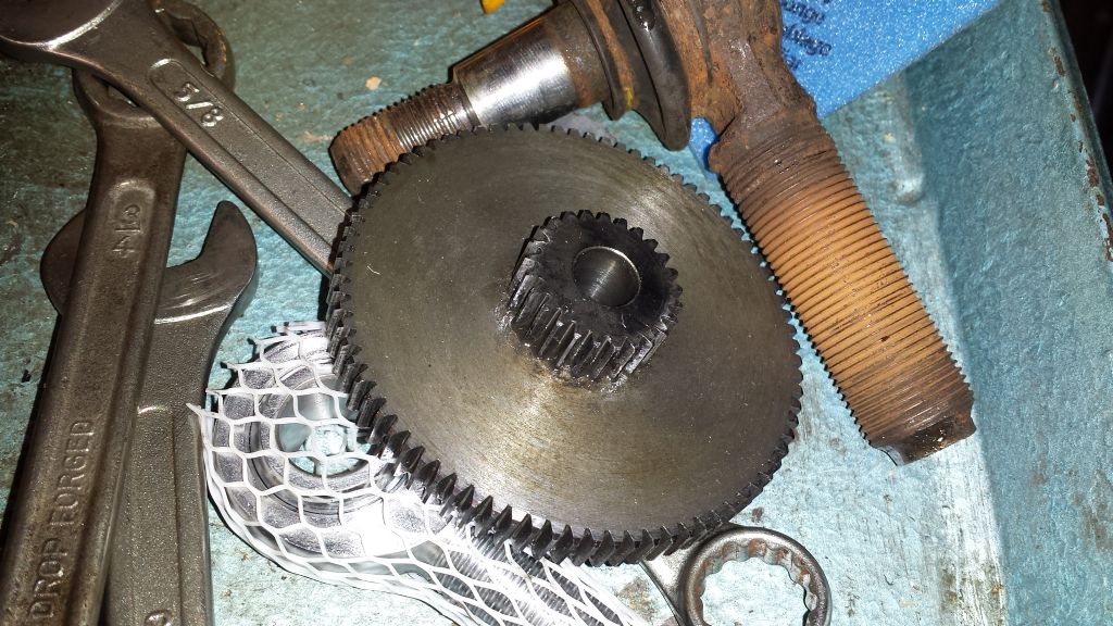

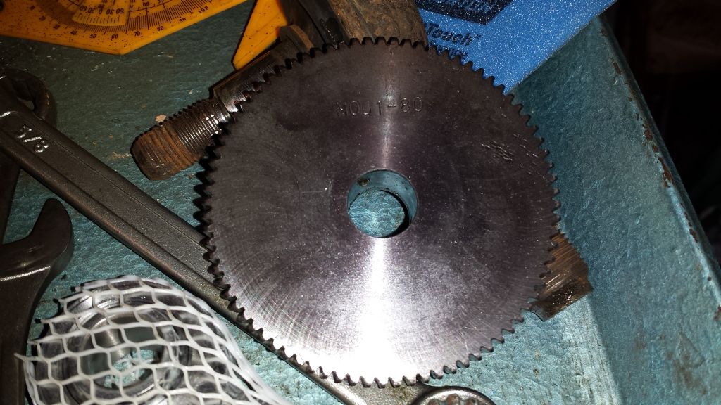

      On the lower stud(2nd stud?) is another compound gear with MOD1-80 written on it.
      And on the leadscrew is a single gear with MOD1-80 written on it.
      This is how they are arranged,
      Also the diameter of te 1st and 2nd studs are much smaller than the holes in my change gears is there supposed to be some sort of bush I should have?

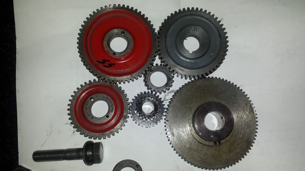

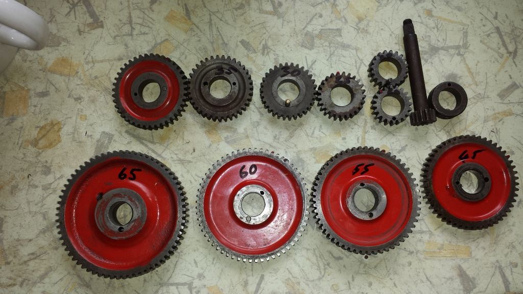

      Here are my change gears.
      If somebody could help me understand what gears I need and where/how to fit them I would be very grateful as I have been brought to an abrupt stop with my little project
      Many thanks
      Rich

              The idlers are exactly what they say they are, they simply allow you to span the two wanted gears to get from the mandrel to the leadscrew. So any two suitable gears will do that fit OK. Assume the mandrel has a 20T gear and the leadscrew has a 60T gear. If you could couple them directly then the reduction would be 1:3.
              Now interpose any idler gear, let us say it is 40T. Then the idler gear will rotate 1 turn for every two turns of the mandrel gear. Now couple that 40T to the 60T leadscrew gear and it will rotate the leadscrew 40/60 per rev, that is a reduction of 1:1.5. Multiply 1.5 x 2 for the two ratios and you 3:1, which is what you would get without the idler gear in place.
              So the idler does not effect the overall ratio and hence any suitable gear will work. Cascade as many idler gears as you like and the overall ratio is simply the first and last gear – as long as you have each idler on a separate spindle. However, if you couple two gears on a common spindle with the drive pins then it becomes a "compound gear" and the number of teeth do have an effect.
              I hope that helps?

                    The 'MOD' gears you have are NOT the same a the rest of the gears. The holes and pins for locking them together should be a clue. They should clearly have different teeth sizes and don't try to run them together.
                    ML 2 is NOT the same as ML7. The early Myfords used the same 14DP gears a the Drummond. Only for later models were the smaller 20 DP gears introduced.
                    DP is Diametric Pitch (which google seems to want to call Diametral Pitch). It is a standard measuring system for gears used in imperial units. Mod is short for Modular which is the standard for metric gears. Look them up.

                      Myford used 20 DP cast iron gears, with steel as the material in 20T and 25T gears, being a lot stronger. As others have said, they are linked by pins in the lower part of the gear. The gear bore was always 5/8 inches [0.625]
                      Ideally you need two working gears in the chain, a 20T as the mandrel gear [the one sharing the reversing gear cluster] through two idlers [size immaterial] to a 50T wheel on the leadscrew. That will give you the right gearing for a 20 tpi pitch thread. It would pay you to get a 50T wheel from Myford, or find the one you the missing one, you will need it frequently and make your own pin drilling in the wheel boss. It will come with a keyway, but that won't matter.
                      Certainly, Myford did not use module gears, the pressure angles don't match and the nearest size to 20 DP is 1.25 mod. Even that would won't mesh well so your 1 mod wheels won't mesh at all with the Myford wheels you do have. I would sell those on ebay, they are effectively useless for this lathe.

                                        Don't ger rid of your Mod 1 gears! They look very useful. It is entirely possible, and indeed was not unusual practice in the days before the cornucopia of cheap internet tools were upon us, to use gears of two or more modules or DPs to construct a gear train.
                                        It looks like the Mod1 gears you have are set up to provide a nice fine feed for turning, finer than the standard Myfrod gears would provide. It looks like the Mod1 compound gears with the 100T and 80 tooth and 20tooth gears coupled together mesh with a Mod1 gear that has been attached outboard of the original 20DP output gear on the reversing quadrant.
                                        So keep your big and little MOD1 gears and use them meshed as shown in your pic for nice fine turning feed.
                                        For screwcutting, use the original 20dp gears but set up to mesh with the inboard gear on the reversing mechanism's output shaft. Plenty of Myford 20dp change wheels come up on Ebay UK every week. So you should be able to buy one for a few pounds. Or keep using the compound gearing app you have already discovered.

                                              If that is so then to set up a 20t-50t (my new 50t arrived this morning) to cut a 20tpi thread I'd swap the outer Mod1 gear of the reverse tumbler compound for a 20t 20dp gear and fit the 50t 20dp to the lead screw and fit suitable 20dp idlers between them?
                                              Yes and no. To get a 20/50 overall ratio, you would need a 20 on the actual lathe headstock spindle, aka mandrel, and a 50 on the leadscrew. You can then run any string of idlers in between the two gears and the ratio is still 20/50. But if you run two gears on one stud, such as that reversing tumbler output shaft, ie compound combination, the two gears must be the same number of teeth each in order to give a 1:1 compound ratio. It might be possible rather to use the inner gear on that output stud, assuming it is a 20dp and mesh the next idler gear with that gear.
                                              I also like your comment about being able to mix and match the 20dp and Mod1 gears provided I always have them meshed like for like, so the switch would take place on a compound gear. For instance no harm would be done by leaving the Mod1 outer gear on the reverse tumbler output compound which could drive a Mod1 compound which in turn could mesh with a Mod1 gear locked to a 20dp gear to form the 2nd compound which in turn could mesh to a 20dp on the lead screw…I think lol.
                                              Yep, you got it. I think it was Prof Chaddock of Quorn fame who suggested in one of his books or articles that the model engineer should collect any gears they could scrounge up and use them in such a way to build compound gear trains of varying DP's where needed. It was probably just easier and cheaper for your old engineer previous owner to buy off the shelf (or "borrow" out of the store at work) MOD1 gears than to try to source 100tooth 20dp gears etc.

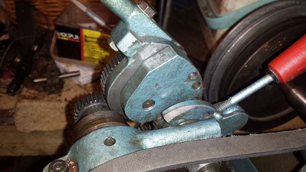

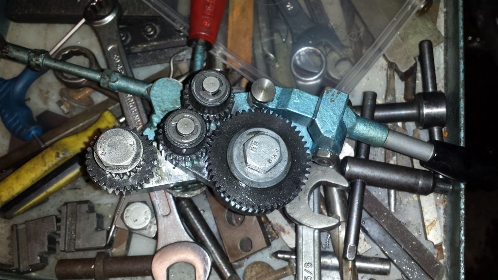

                                              Also, can you post a few more pics of that reversing tumbler set up? It looks different from other ML2 ones I have seen and might be something the old engineer set up himself. So you might want to check that the gears on the mandrel and the reversing tumbler are all 20dp and not something different again that he set up from whatever was in his scrap box! Or as John has suggested above, maybe that's the way they were copied from Grayson with varying DPs to suit whatever needs they had in manufacturing.

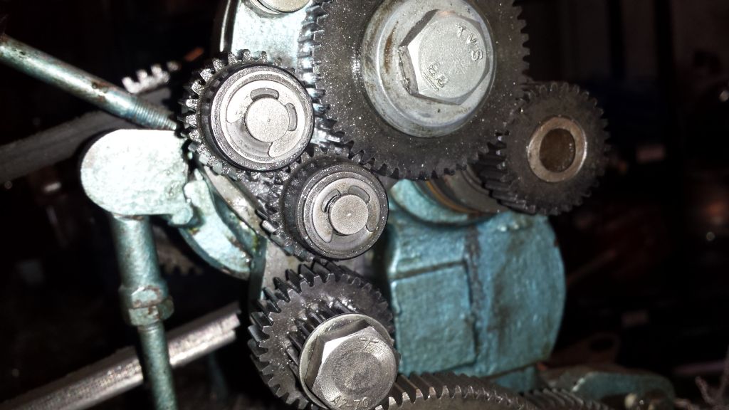

                                                    Here are the photos of the reverse tumblers . I think my quadrant may be different as well as in other photos of peoples ML lathes they have a quadrant with 2 slots arranged in a sort of V where as mine just has the single slot. I don't know if that will matter but there are plenty on ebay if I need the V type.
                                                    The black handle selects forward, reverse or not engaged, the red handle just tightens the v belt.

                                                      I have an old ML4 which is very similar to that, and I'm sure that your change gears and mounting are very different. Someone has heavily modified your machine, but that is likely to be a good thing. The actual Myford gears were quite good, but the original method of mounting left a lot to be desired.
                                                      I don't know if all of your gears are metric or not. There's no reason not to use metric gears if that's what your machine has been converted to use. The main thing of importance is that all the gears you use have the same pitch.
                                                      Don't forget that idler gears can be anything. An easy way to think about this is one tooth in, one tooth out. The only way you get a change is to have two gears on one shaft. Then you certainly don't get one tooth in one tooth out.
                                                      Your lead screw is probably 8 TPI, but that might have been changed too. If it is 8TPI then the 20T and 50T gears sound right for 20TPI. Just use whatever idlers bridge the gap. It looks like you have a tumbler reverse, so you can have odd or even numbers of idlers, as you find convenient.
