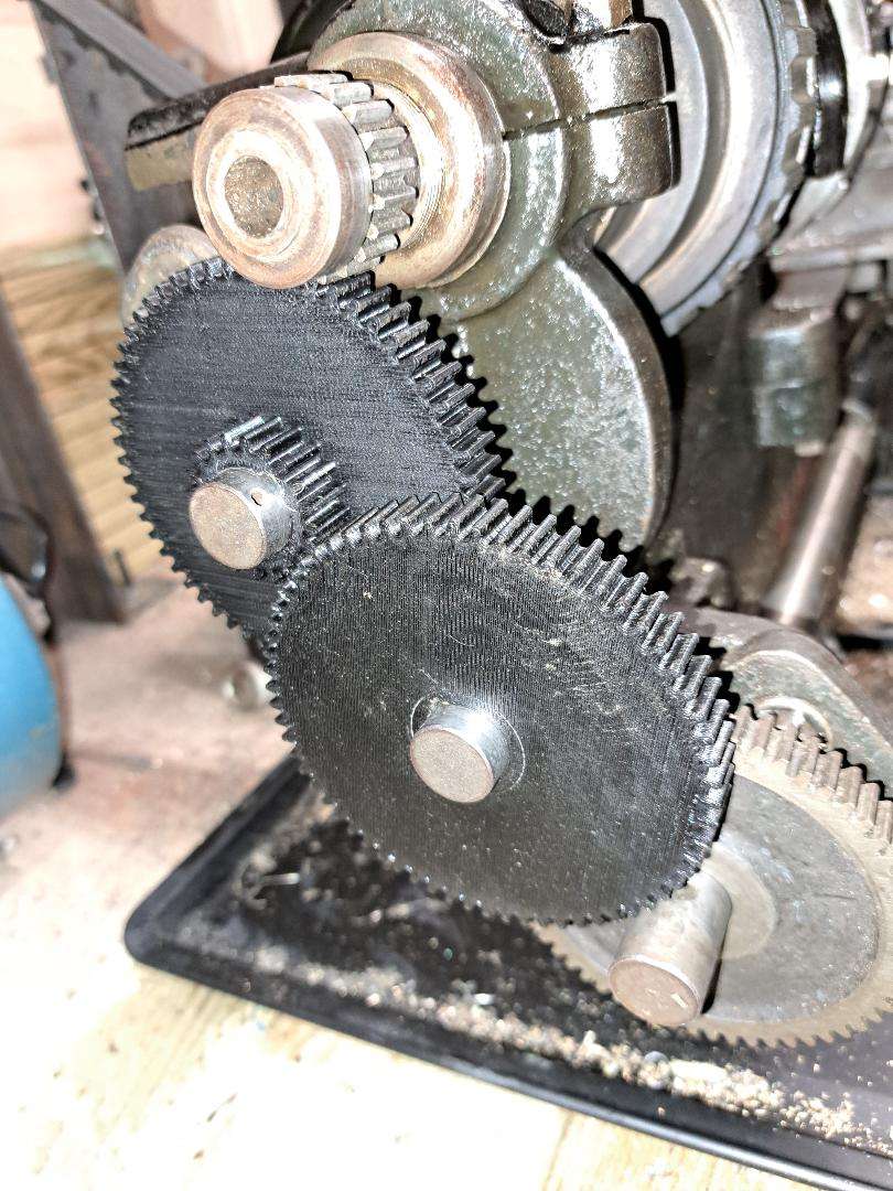

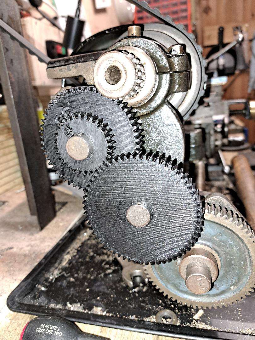

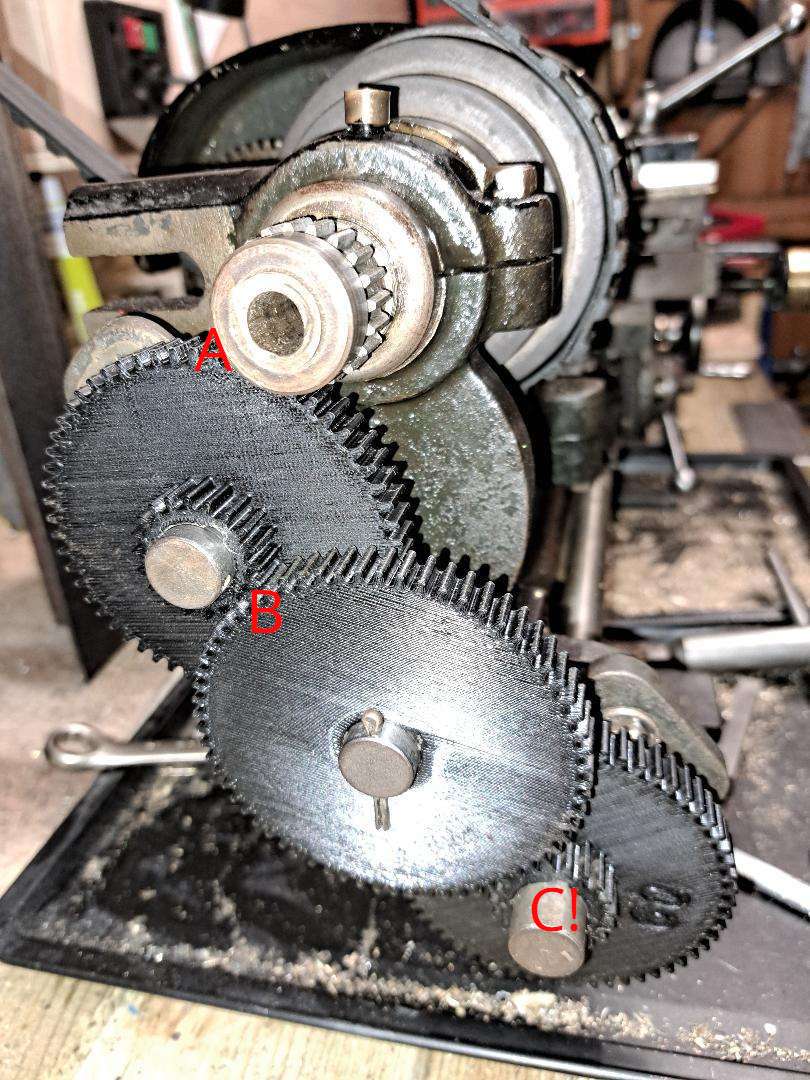

      Hello, I have recently printed a 20/60, 20/65 and 20/60 for my Myford ML2/3 as seem in the picture below from the advice of Howard Lewis post from a few years ago. It dfoes not give a fine feed, looks more like a screw cutting. Any ideas on how to get a fine feed to work. It has not got the reverse lever on it.

        Take the 20T off the lead screw as it looks like you have that meshing with the 65T. You want the 20T behind the 65T to mesh with the 60T on the leadscrew. It should be small gear driving a large one on all studs and leadscrew.
        so that a fine feed can be set up 20:60/20:65/20:60 on the Leadscrew.
        From Howards post
        20:60 = 20T on spindle drives 60T plastic 1 /
        20:65 = 20T plastic 1 drives 65T Plastic 2/
        20:60 = 20T plastic 2 Drives 60T on Plastic 3
        No need for the last 20T on Plastic 3
        #783112
          I suspect the gears aren’t set correctly. They should all go from a low toothed driver to a high toothed driven.  In the picture:
          delrin
          Red A is good
          Red B is good
          Red C! looks wrong: big wheel B drives a small wheel, so the ratio isn’t geared down.  The small C wheel should be behind big wheel B and mesh with big wheel C (which is correctly positioned.)
          Hope that makes sense.

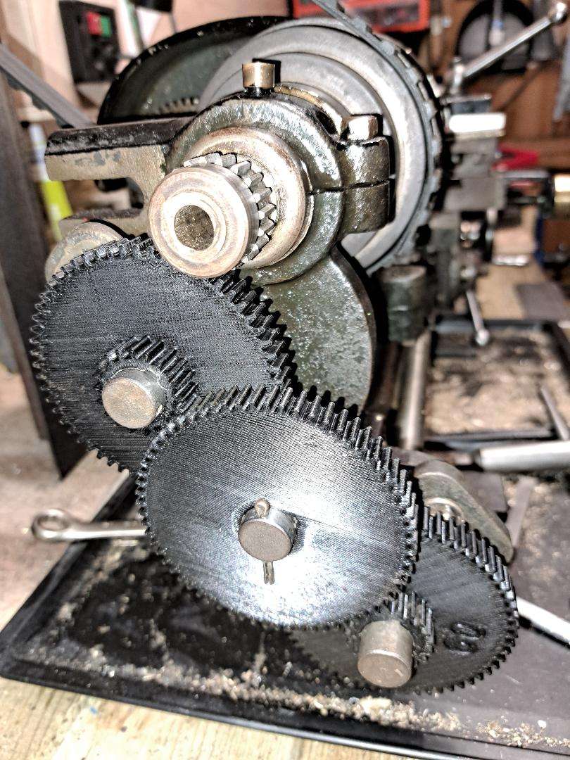

          #783115
          barry
            @barry
            Thanks for the quick replies. Have done what you suggested. They all mesh together now but I cannot fasten the lead screw gear. The gear B is now touching the lead screw shaft.
            Thanksthumbnail

              #783134
                20 tooth driver to 60T /20T compound to drive a second compound 65/20, which drove the 60T on the Leadscrew
                Howard that is what he has got in his second photo*. Problem is the 65 comes too close to the bit of lead screw that sticks out the end.
                Might work with a gear a bit larger than 60T on the leadscrew which will push the 20/65 gear a bit further away if the banjo will allow it and gear won’t hit the drip tray.
                * spindle gear may be a 25T

                    #783148
                      You can’t just “snug up” the gear at the spindle end of the banjo as it will come out of mesh with the other gears, You build the banjo up from the leadscrew gear getting each successive gear to mesh correctly.
                      It’s far more than just a slightly oversize 3D print, it touches the leadscrew let alone the collar that is meant to go on and retain the leadscrew gear.
                      fine
                      If you look at the finer pitches and feeds on other Myford charts the leadscrew gear is always larger than the next large gear of the pair before it. Howards setup has it the other way round.
                      If there is room on banjo and below the gear print a 70T to go on the leadscrew.

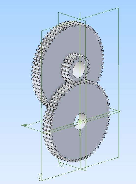

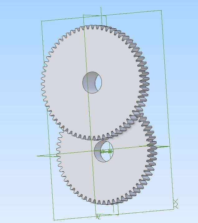

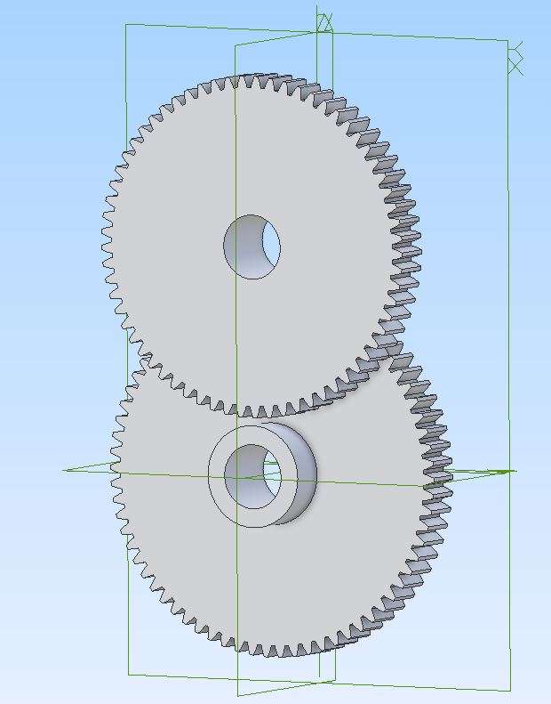

                        This is the problem
                        If the 60T on the leadscrew is meshed with the 20T behind the 65T
                        mesh 1
                        Then the 65T comes too close to the lead screw which can be seen if you look from the headstock end
                        mesh 2
                        To cure this the leadscrew gear needs to be larger. Assuming the collar is 1″ dia then a 70T will do it provided the bango allows and it does not hit the drip tray
                        mesh3
                        These are 20DP gears with 5/8″ bore

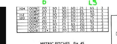

                          I have the original handbook from the era which quotes two versions of fine feed
                          114.4 tpi is given by 20:55, 30:60, 25:65
                          171.6 tpi is given by 20:55, 25:60, 20:65
                          Looking at the photo gives me the strong impression that these printed gears are much coarser than 20 DP, and therefore larger than will mesh happily in the space on the banjo.

                          #783159
                            Brian, The ones I have drawn are 20DP and show the same problem that the OP has so size would seem right.
                            The two gear trains you list are similar to what I said in that the leadscrew gear is 5T larger than the large one on the pair before.
                            Just doing the maths shows it won’t leave room for the collar.
                            65T gear has an OD of (65+2)/20 = 3.35. Half that is a radius of 1.675″
                            60T meshing with 20T have a pcd of 60/20 + 20/20 = 3 +1 = 4. Half that is a distance of 2″
                            5/8″ shaft has a radius of 0.3125″
                            So if you subtract the 1.675 and 0.3125 from 2″ then that is about 12thou gap which the collar will not fit into.

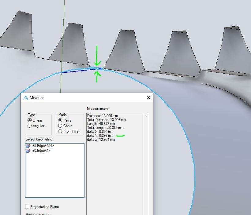

                            #783179
                              Confirmed with CAD, 0.296mm ( approx 12 thou)between crest of teh 65T and the leadscrew when the 20T:60T pair are meshed.
                              gap

                                    #783443
                                    barry
                                      @barry
                                      Hello again, problem solved, printed off the gears Brian Wood suggested from the original manual of 55/30, 60/25 and 65 on lead screw. It works perfect. Thanks again for all your replies and help.thumbnail
