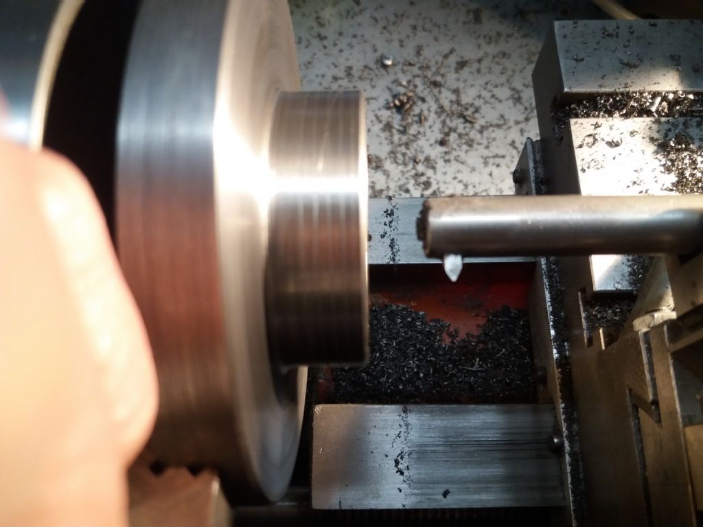

      Just thought I would share drawing of back plate for my M Type lathe. These pictures and need moding to suit your chuck but the spindle sizes are the same no matter which chuck. I also have a C spanner mod on all my chucks and thought it is easy to do.
      It's so easy to remove chuck with no damage just tap C spanner with mallet.
      David

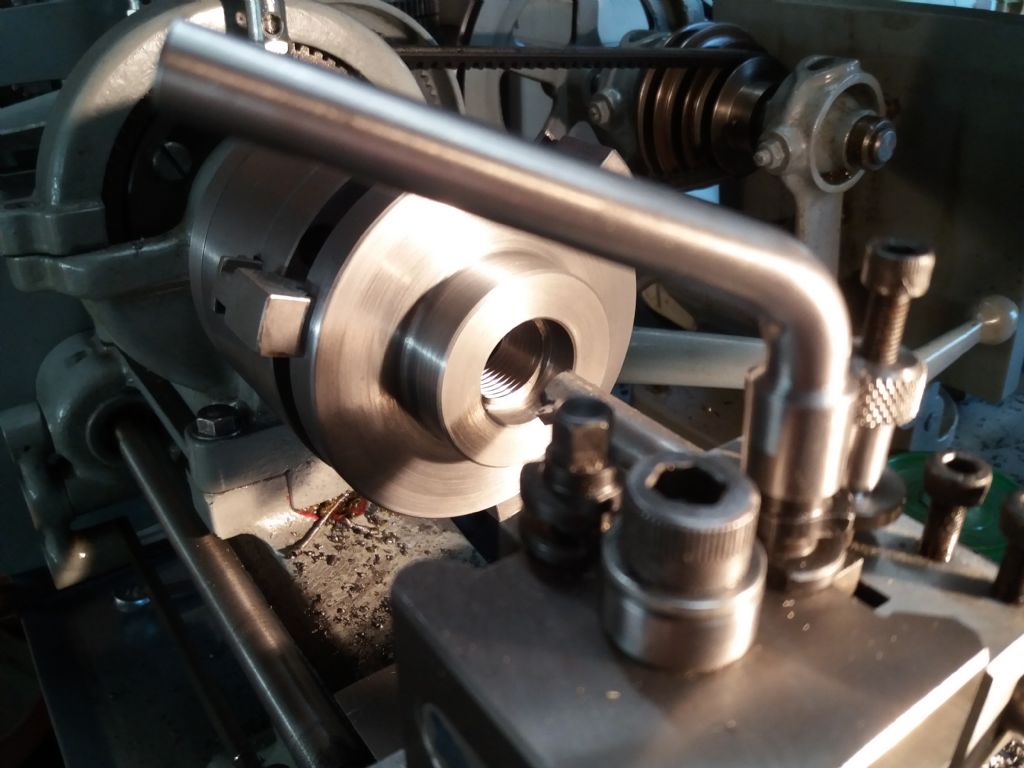

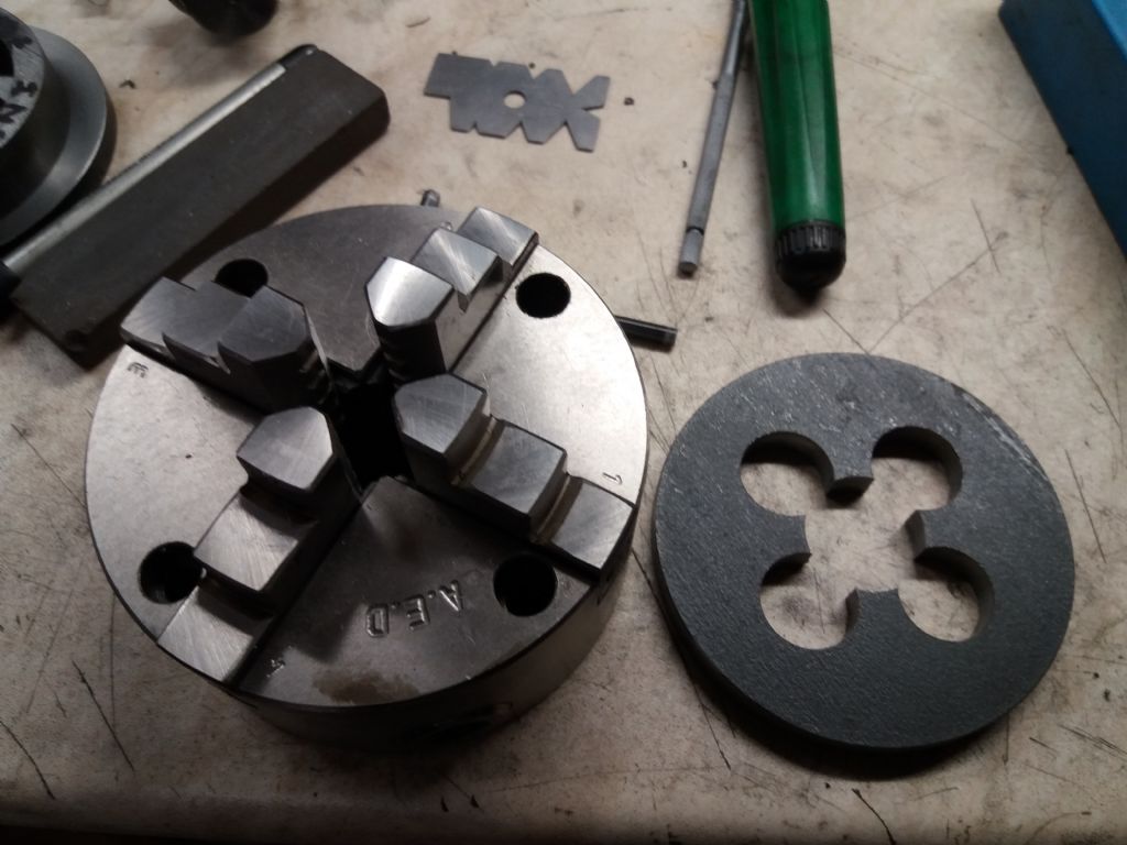

                      I have started machining the back plate ready to mount my new 4 jaw self centering chuck but as I bought it from Myford at the at the Doncaster show as faulty, returned as it ran out written on box. I checked it by holding it in my 3 jaw chuck and after striping and checking it is obvious that the jaws were ground wrong. So I have made a 4 hole cloverleaf jig to grind it when mounted.
                      Screw cutting the back plate.
                      Here is the cloverleaf jig.
                      David
                      #413229
                      geoff walker 1
                        @geoffwalker1
                        Hi David,
                        Never seen this before, interesting.
                        Would I be right to say that clover plate has to made extremely accurately for it to do the job.
                        I.E. the four outer must be precisely positioned around the inner hole both in angular setting and P.CD.
                        This will ensure that each jaw exerts equal pressure on the plate when the jaws are closed and set for grinding.
                        Looks tricky to me, how did you make it
                        Geoff
                        #413235
                        Roderick Jenkins
                          @roderickjenkins93242
                          I don't think the clover plate needs to be made with extreme accuracy: It just needs to resist sufficient pressure to ensure that each jaw is firmly seated against the scroll, taking up the backlash.
                          Rod
                          #413237
                          David George 1
                            @davidgeorge1
                            The cloverleaf plate is just to give pressure on front of jaws to make sure that when you grind them they are in the working attitude and will be able to grip on whole width of jaws. The three jaw type are less accurate than a four jaw one as like a three leg stool won't rock but as I have stamped the plate so it can be returned to same position on chuck and I have checked it with feeler gauges and localy filed it till there are no gaps when tightened up. Also it is made from soft mild steel so it will bed down fairly easy. For the other set of jaws j have made a set of rings which will do the same thing but opposite pressure for grinding them as well.
                            David

                            geoff walker 1
                              @geoffwalker1
                              Rod, David,
                              Thanks for the replies.
                              I get it now, I understand.
                              The possibility of backlash puzzled me but I can see that as long there is pressure on each jaw that will be enough to take up the backlash.
                              Very interesting, as I said earlier never seen it before. I have an old 3 jaw which could benefit from a regrind. May try it sometime
                              thanks again Geoff
