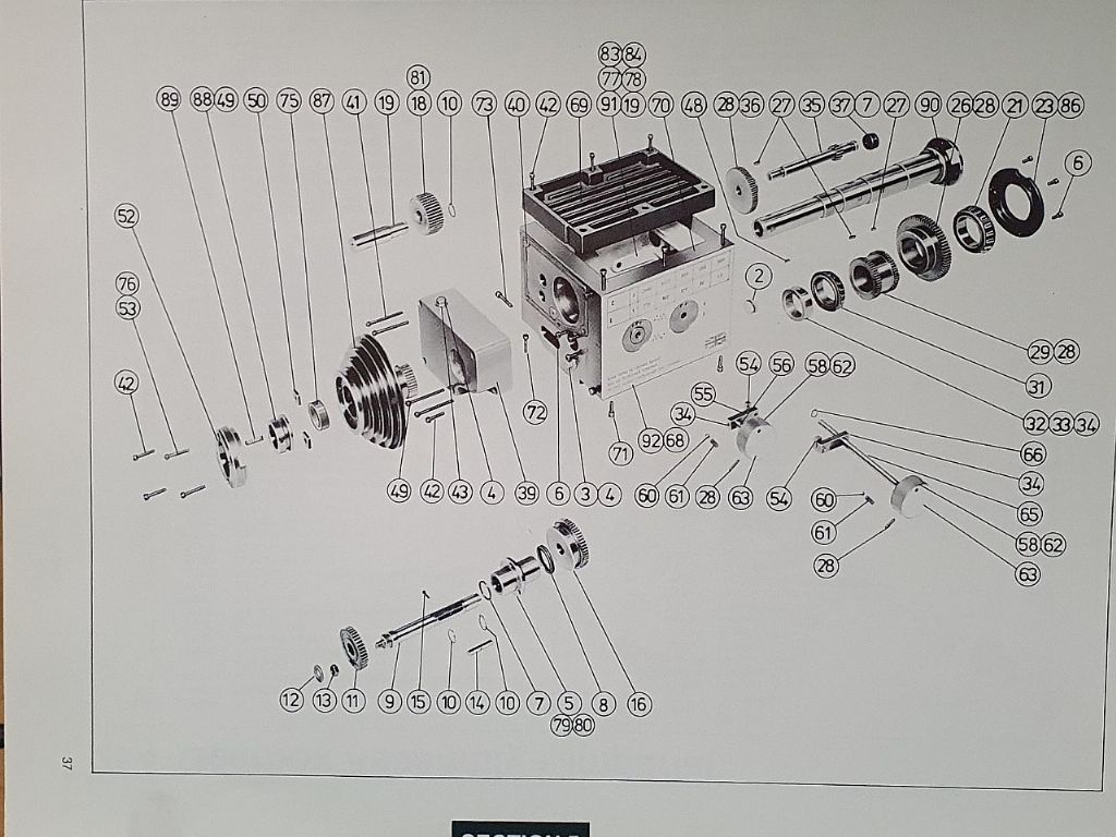

      I have oil leaching out from the front headstock spindle behind the cam lock head. There is a blackened cover which I assume has some sort of seal in there.
      Does the whole spindle need removing and is there a seal available somewhere.

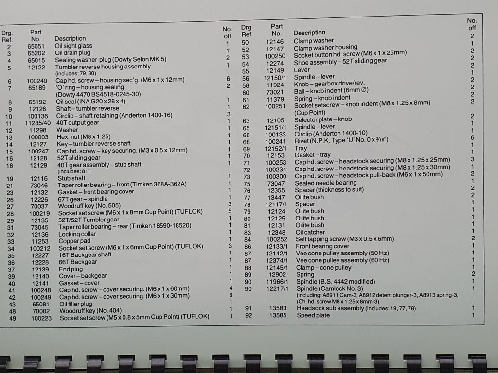

          I'm not familiar with the Camlock, my 254 Plus has the BS25442 Spindle which has the chuck mounting boss on the end. Looking at the parts diagram, I think that to replace the seal (23) which is behind your cover (86) you would have to remove/dismantle the complete spindle assembly. However finding a seal may not be possible as the lathe was discontinued many years ago.

              Looking at the parts list there is no oil seal and I wondered if it is a labyrinth cover which is designed to catch oil and return it back to the sump. I also wondered if the oil level was too high, maybe the oil level sight glass has a stain in it giving a false reading or has the wrong oil been used.

                  As far as I can recall, there is a wee hole at the bottom of the flange so that any oil which is carried into it may drain back into the headstock. There certainly isn't any form of rubber or scroll seal. The hole could be blocked by debris. I fear that dismantlement of the headstock may be required. Not an easy task!

                        Part no 23 is called 'Gasket – front bearing cover' so i assume there is a gasket that seats inside this bearing cover.
                        Yes I think it will all have to be striped down and hopefully find a part that can be replaced. Or it could be a complete waste of time if part is not available.
                        Is there any past Myford employees that could shed some light on this matter.
                        There is no mention of a labyrinth seal in the parts assembly page.

                          A labyrinth seal is not a seal as a finite entity. It is means of preventing oil leakage.
                          It is a non contact means of retaining oil. The shaft has a "wind back" groove with a close fitting, but not touching housing. The oil film forms between the housing and the shaft, and the wind back thread does just that, it pushes the oil back into the housing, from which it drains through the hole in the bottom, into the Headstock.
                          So, if you run the lathe in reverse for long periods, the "thread" will wind the oil OUT of the housing.

                              If no seal is listed for that area of the Headstock, it would be likely that the means of preventing oil loss is a labyrinth.It is likely that there will be a gasket between the labyrinth seal housing and the Headstock.
