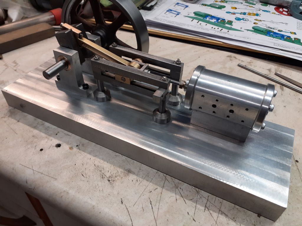

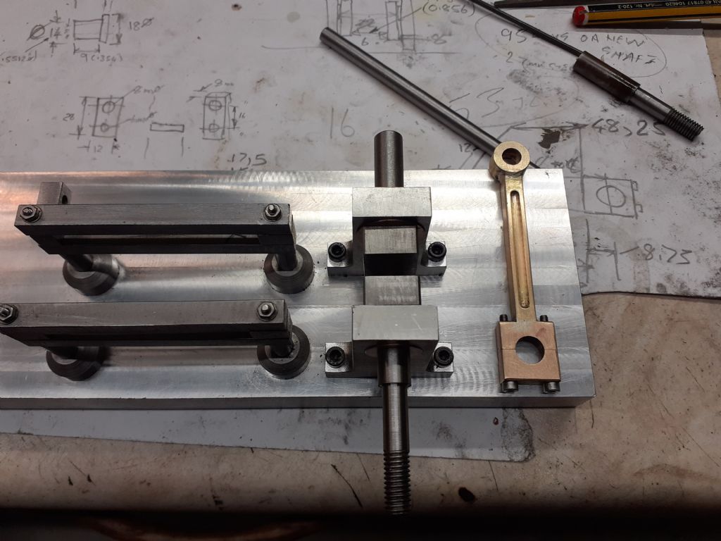

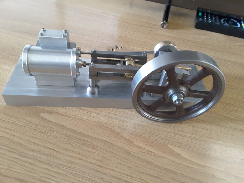

      Just finnished the valve section and eccentric and done a first assembly. I have changed a few bits to my liking to give it a bit more strength.
      David

          Looking good David.
          What's in the box on top of the valve chest?

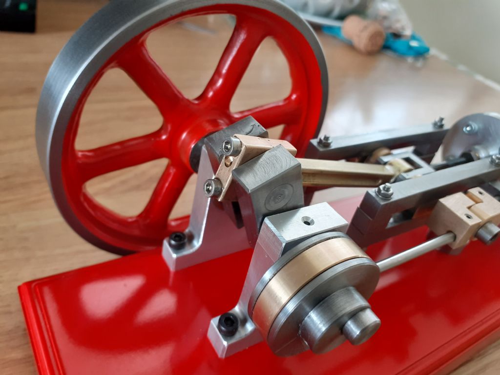

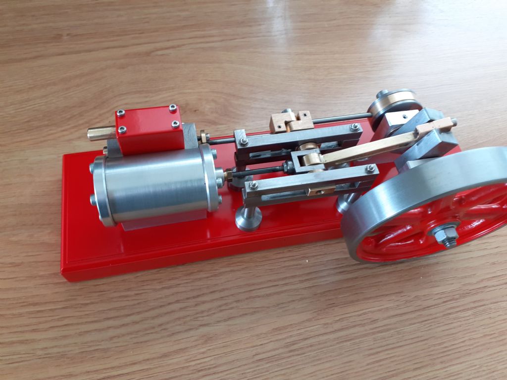

                  Hi Jim the box is an exhaust with the outlet on the end. I have drilled the exhaust outlets on the top and cross drilled to end.
                  Not tried it out yet and have some finishing to do on edges and corners as well as lube bits and pieces then clean up the flywheel casting. I probably will paint it red.
                  David

                    Thanks for that David. One of the things I like about Stew Hart's designs is that they can be personalised fairly easily. I did a similar thing on my version but had the inlet on top and the exhaust on the side.

                    I like your connecting rod too, I must bear that in mind

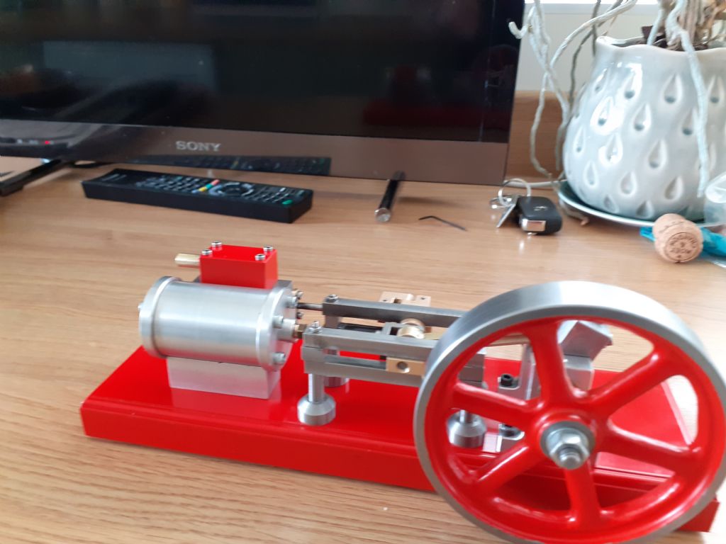

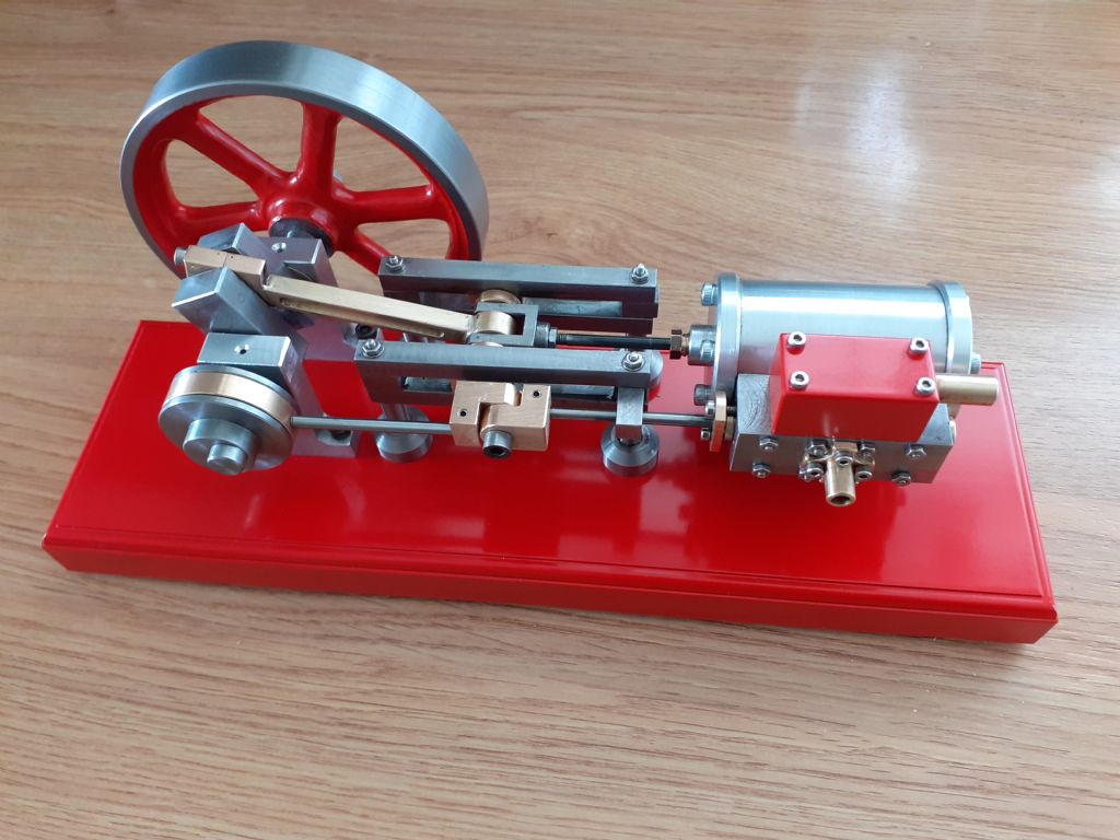

                            It lives. I had the first run on my engine.
                            I had it connected to tyre inflator, only 5 PSI and it runs great.
                            David

                                    Super job David; any advice on how you prepped the aluminium pror to painting… was the paint rattle can or mini spray gun ?
                                    George.
                                    #541680
                                    David George 1
                                      @davidgeorge1
                                      Hi George. I used rattle can paint. First an etch primer then a primer followed by finnish coat with fine wet and dry between coats.
                                      David

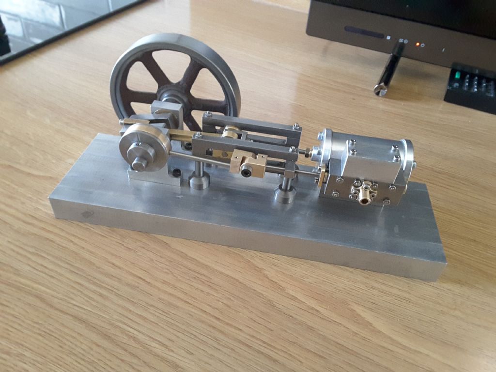

                                      David George 1
                                        @davidgeorge1
                                        Got my pottymill on steam today. I had a try with the boiler on the wobbler and lamp but the solid fuel wasn't sufficient to power the pottymill. I ordered a gas burner from Forests and it came today and it ran perfect.
                                        David
