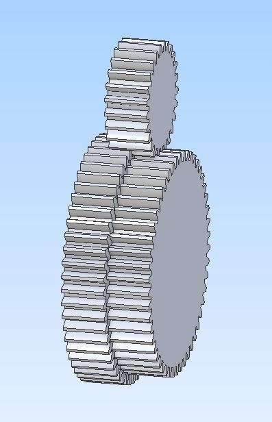

                  On JasonB Said:
                  Borrowing the picture from Jason’s post for reference ^^^
                  … and stating the obvious !
                  Using an axial grub-screw [or set-screw, depending on geographic preference] on the joint line is a very effective alternative to fitting a key, and is intended to be a semi-permanent arrangement.
                  #737667
                    Brian, if the problem existed then your 50/55 pair would be more of a problem than the 50/63 as they are closer in diameter so would more likely clash with the 25T.
                    This is something that playing with online calculators does not tell you as they don’t always take into account what actually fits on a banjo.
                    I wonder if Andrew is simply putting the 63T of the pair against the banjo and that is why it is engaging rather than the 50T?

                            The 50/55 on the same stud will suffer the same problem as the 50/63 on the same stud.
                            Something needs to move sideways or you need a single gear on the first stud so only that engages.
                            This is a 50/55 pair that don’t allow the 50T to mesh with the 25T which is the OPs problem not the actual gears used.
                            gear clash
                            This is something that affects many of the imported lathes where the fixed driver on the spindle is at least double the width of the banjo gears so whatever pair you put on the first stud MUST have the driven gear a larger size than the driver it is paired with
