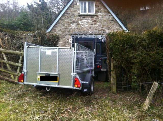

                                              Thought I had a big job on last week getting my new Warco Lathe into the house (pallet was labelled 180Kg) but seems it was nothing compared with the stories and weights above. We had to reopen an old gate not used for many a year into an adjoining field and bring the lathe across the whole length of the field and down a very steep grassy bank so that we could unload right outside the door. Simply lifted the lathe in the trailer with an engine hoist, laid the trailer door on top of the hoist legs and drove the trailer out of the way – then lowered the Lathe onto a trolley I made for the job and wheeled along lengths of board into the house. As has been said planning and having everything ready was the key, including picking a dry day..
                                              Best of luck with it.
                                              Regards
                                              Allan.
