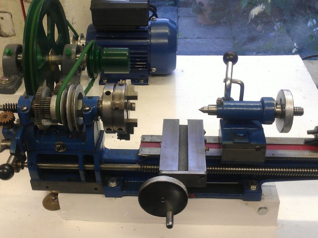

                #196317
                James A
                  @jamesalford67616
                  Finally, I have set up my Flexispeed and it isready to try using. I am not sure whether I have set the speeds at realistic rates: the top speed is a shade under 500 rpm, the lowest without the backgear being 190 rpm. With the backgear, it is measuring 50 rpm. The first thing that I wish to make for it is a pair of oilers for the headstock, followed by a QCTP. Making these will soon give me an idea of a how useful the speeds are.
                  Regards,
                  James.
                  #196363
                  Ian S C
                    @iansc
                    James, that sounds a quite sensible speed range. Is that a clutch on the counter shaft pulley? That looks a nice little lathe.
                    Ian S C

                                #196432
                                James A
                                  @jamesalford67616
                                  John,
                                  Thank you. I am pleased with the machine, which was a Christmas present. The lump on the pully is just the stub of the billet from which I machined the pulley. I started doing it on a friend's lathe, but needed a bigger machine to bore it out. I did that on a huge great industrial machine in a factory at about 10:00pm. As I barely knew the person, I did not want to overstay my welcome, so it had to stay as it is.
                                  I am not sure whether the comments from others regarding grinder motors refer to my motor or not: however, this motor is not from a grinder, is rated at 1/6hp and cost just £25.00 delivered.
                                  Regards,
                                  James.
