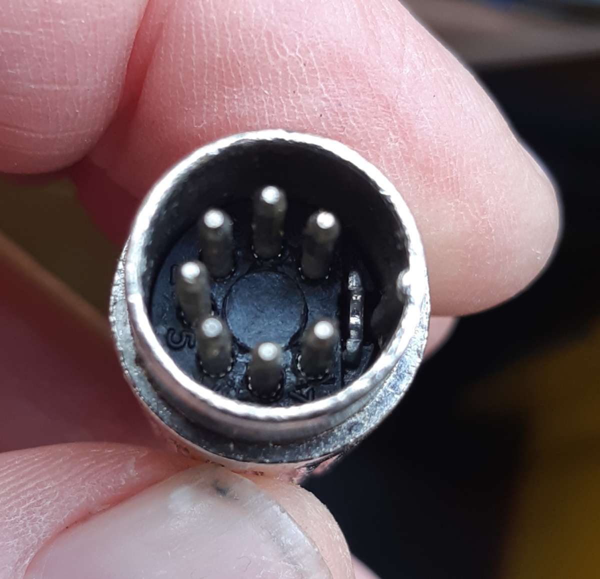

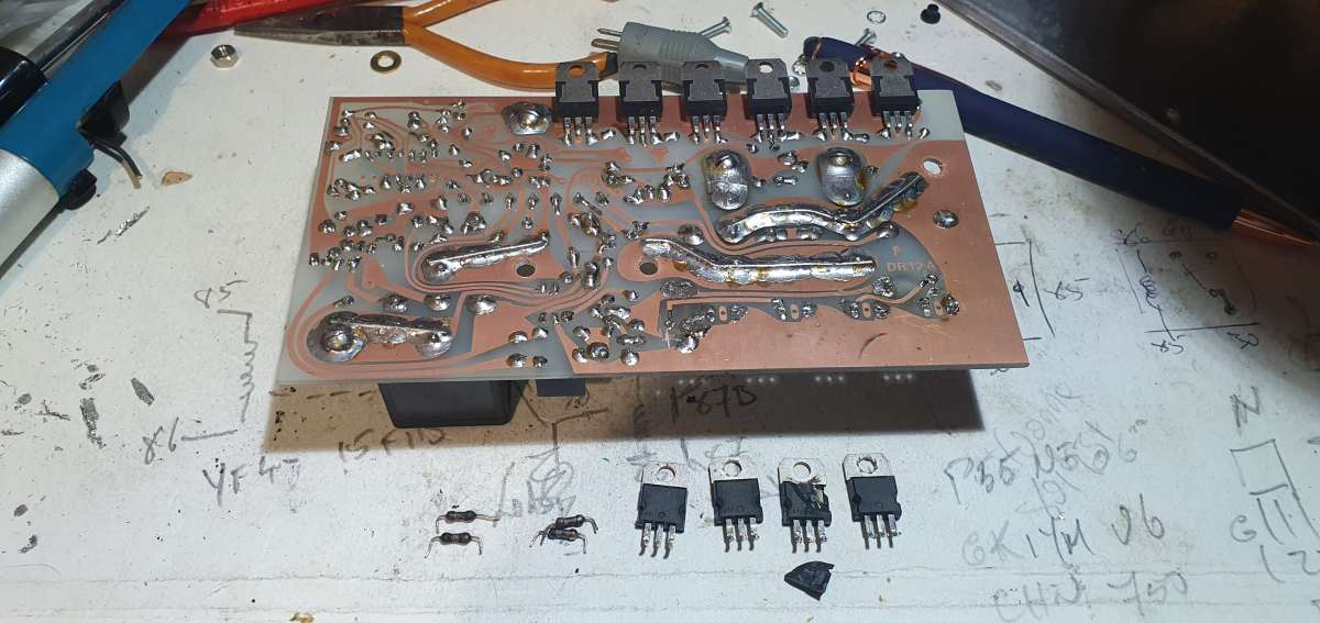

                          Hi  Phil,  unfortunately no additional info or circuits etc. I have identified 7 out of the 10 mosfets are blown. Waiting on replacements to arrive before working out what the connections are and power it up.
                          Tom.

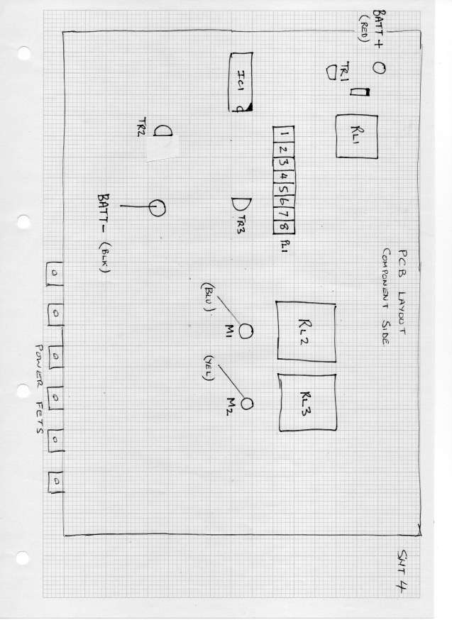

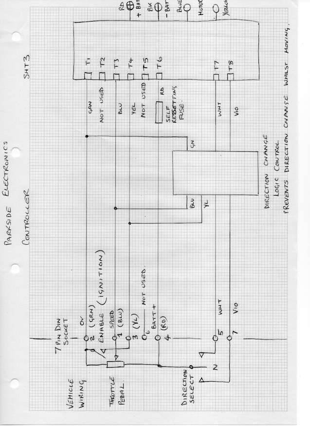

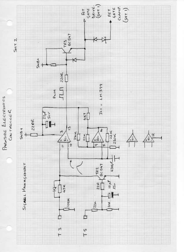

                            Clive Steer
                              @clivesteer55943

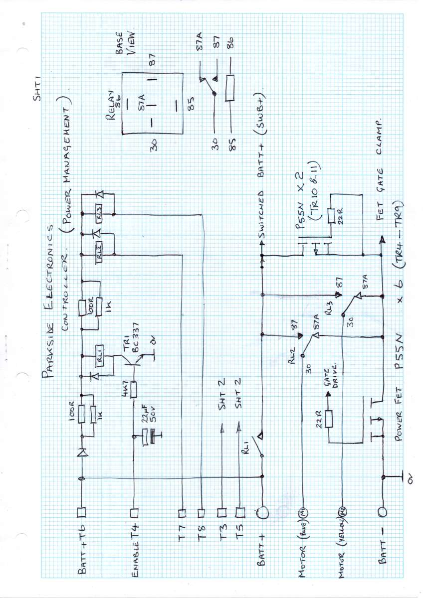

                              I’ve attached schematics of the Parkside controller I had a look at. The circuit is very simple with one section of the LM399 being used to generate a sawtooth wave which is fed to another section to convert the variable DC control voltage into a PWM signal to drive the MOSFET’s. It appears 2 MOSFET’s are used to provide braking. In my case the controller was working OK and the issue lay elsewhere in the vehicle ( a Childs electric car)
                              I hope this helps.
                              CSParkside con sht1Parkside con sht3Parkside con sht4

                                Somehow the upload left out sht 2.Parkside con sht2

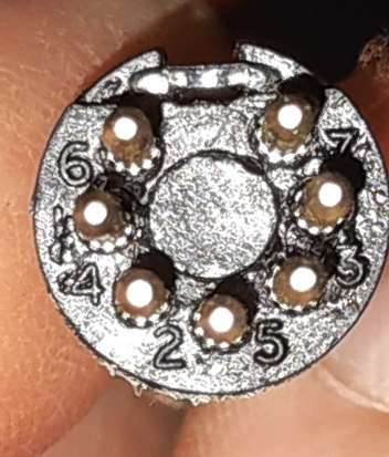

                                        Hmm,  the pot on mine is a centre biased joystck,  with fwd and brake.  The additional analoge board is possibly a level shifter / brake control circuit?
                                        My reading of the MOSFET stage is a simple pull to ground transistor (4-9) with 10 & 11 as flywheel diodes.  The relays can switch this to either motor wire.  The other switched to positive.   If the relays are not delivering power, then they short the motor … reheostatic brake.  This is pretty neat!
                                        00  – short motor
                                        01 – FWD
                                        10 – REV
                                        11 – short motor.

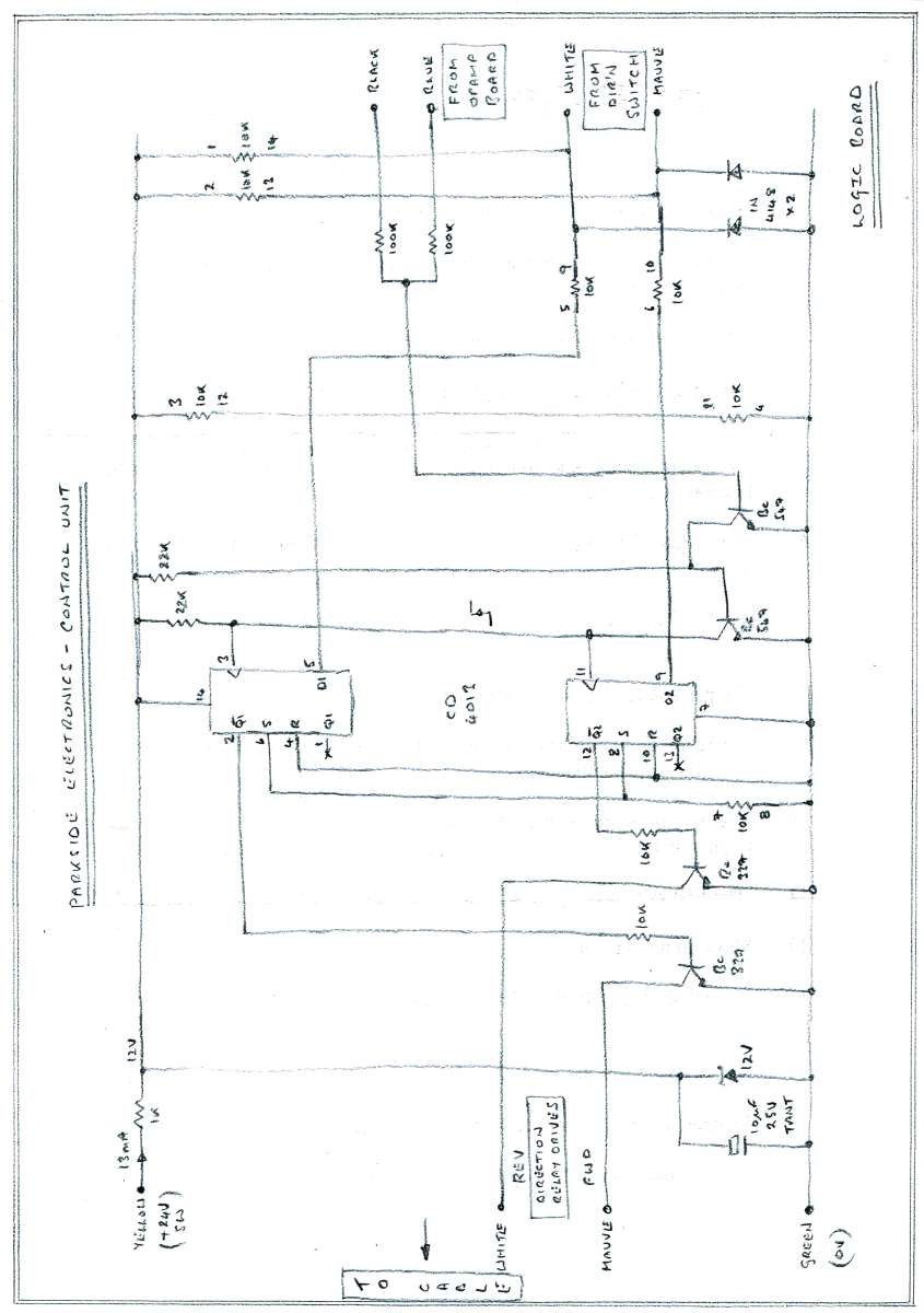

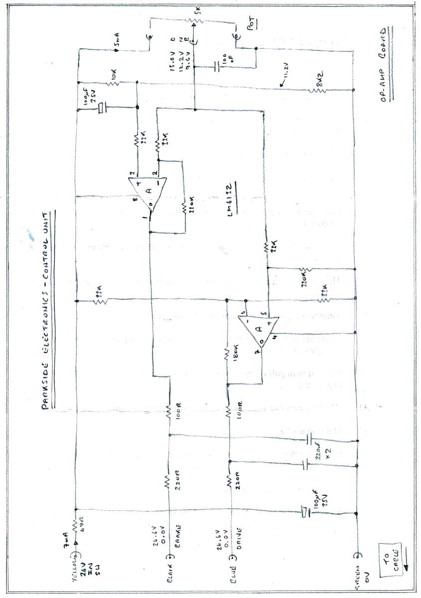

                                        #794872
                                        mjbarratt
                                          @mjbarratt

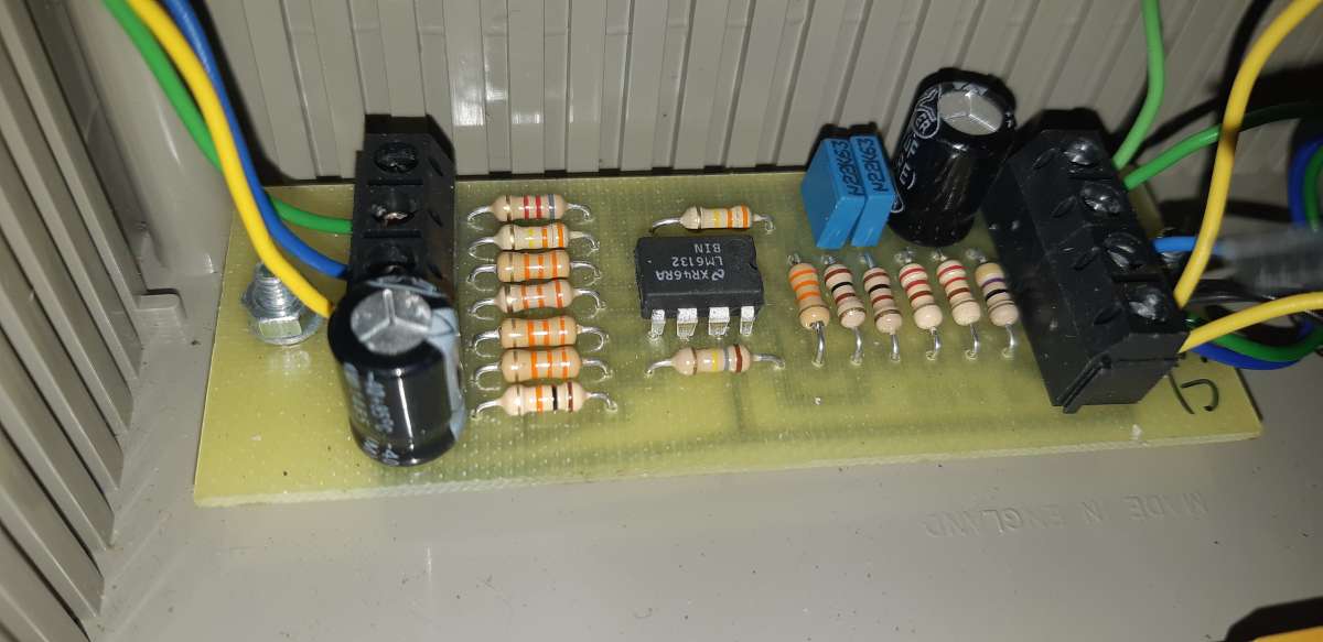

                                          I know that this is an old thread but I recently came across it and, because I have a Parkside controller like the one being discussed, I thought that the following might help.
                                          My controller system consists of a ‘Power Unit’ – like the one pictured – housed in a die-cast enclosure and a separate, remote ‘Control Unit’ that provides both Forward:Reverse and Drive:Brake control functions. This contains two PCBs and appears to be similar to the one shown in PhilBarber’s post above…mine differs in that it also provides a ‘Horn’ function controlled by an eighth wire in the DIN plug. I have traced out the circuit diagrams of the two PCBs and they are attached below.
                                          The OpAmp Board provides two mutually exclusive control voltages both of which idle at 0V when the Control Pot is centred. As the Pot (joystick) is moved in either direction – Drive or Brake – the respective control signal (Drive:Blue Wire / Brake:Black Wire) ‘lifts off’ 0V and rises toward its maximum value of about 24V. On my unit the joystick output voltage ranges from about 9.6V (full Brake) to about 15.0V (full Drive) with the Neutral position giving about 12.2V. This approximately +/-2.5V swing is amplified by about x10 by the two op-amps to provide the two separate 0-24V outputs to the Power Unit.

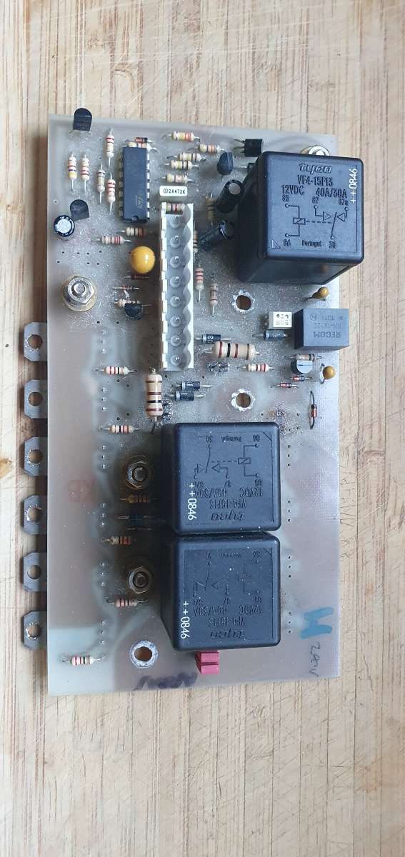

                                          The Logic Board provides the circuitry for the Direction Change Control Logic shown on Clive’s SHT3 drawing and works as follows:-
                                          The Direction Control switch and its pull-up resistors (2 x 10k) provide the ‘D’ inputs to the two halves of the CD4013 flip-flop – a logic low in the selected position, Fwd or Rev, with the level at the other gate at a logic high. With the joystick centred – and so both the Drive and Brake control voltages are at 0V – the flip-flop’s CLOCK inputs are at a logic low. Moving the joystick a fraction in either direction lifts one of the control voltages off 0V and causes a positive-going clock pulse. This latches the current state of the Direction Switch and provides a mutually exclusive drive to the direction control relays in the Power Unit. Additionally, because the positive-going edge of the clock pulse can ONLY be produced as the joystick leaves the Neutral position, motor direction changes can only be actioned under conditions of ‘zero-drive’.
                                          A couple of points on Clive’s drawings:
                                          1. I think that the ENABLE switch shown on SHT3 should be connected to BATT+ not 0V. When closed this would apply 24V to the base circuit of TR1 turning it on, closing RL1 and so applying power to the MOSFET stages.
                                          2. I think that the left-hand end of the 100R:1k resistor pair feeding RL2 and RL3 shoud be connected to the cathode of the upstream reverse polarity diode. The relays used have 12V 90ohm coils and the resistor-pairs (100R||1k = 91 ohms) are used in series with the coils to permit operation from a 24V supply. As an aside, the 100R resistors dissipate about 2W and both of them show signs of overheating in my unit – two 180R in parallel would probably have been a better choice.
                                          I hope that some of this helps.
                                          Martin.
                                          PS: I’m sorry that the images are not particularly clear but I hope that you can read them OK.
                                          PECU-OpAmpPECU-Logic

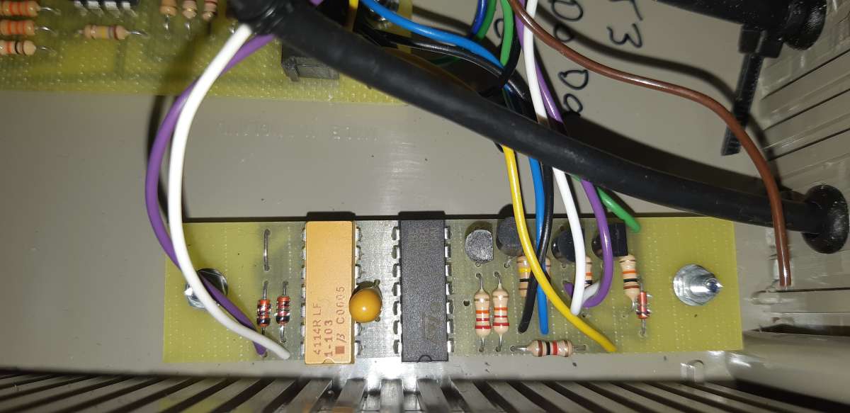

                                          #868318
                                          shayodon
                                            @shayodon
                                            First thanks everyone for your posts/diagrams on this
                                            Its the beauty of these types of forums someone like me can find this valuable info a few years later.

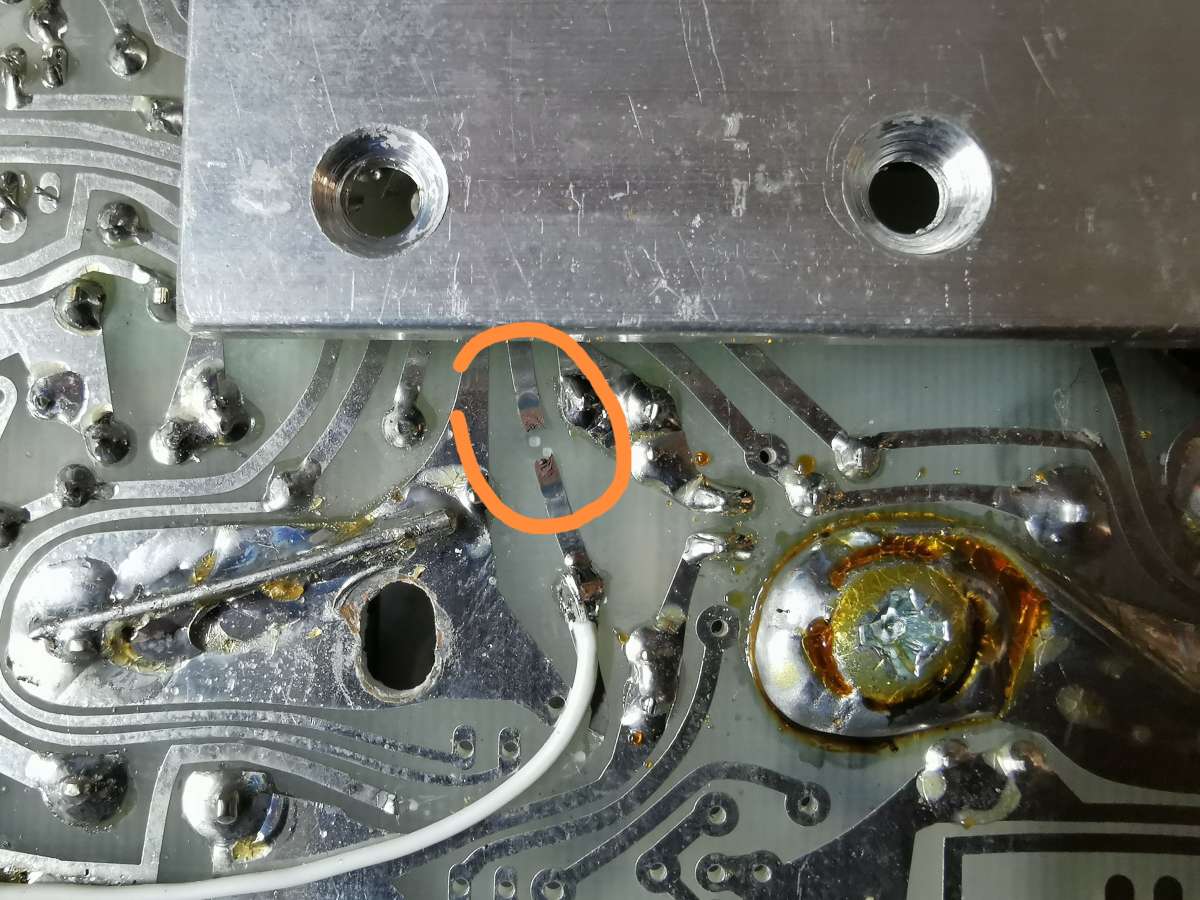

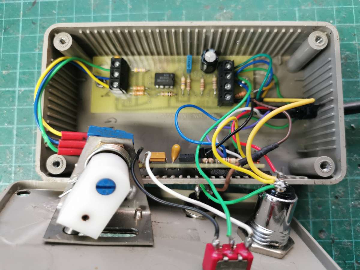

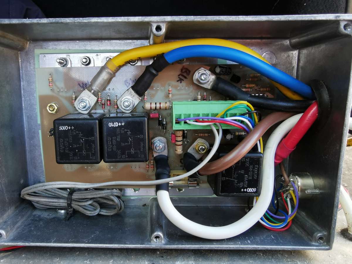

                                            this is the second time over past few years I have had to try and get this controller fixed on a loco we run at the Donegal Railway museum in NW Ireland dosnt run far just up and down streight bit of track (but we do have big plans thats a story for another day) as its staff that take the kids for a ride the hand control tends to get bit bashed now and again,
                                            The first time wires got pulled out even after repairing them it was still dead turned out to be a burnt PCB strip on the main control board (alum box), between the Battery + and the red wire on the green plug. was real pain to strip pcb out and put back toegther but bit of wire fixed it.
                                            Similar happened again last week wires pulled out plus broken resistor on the yellow wire its a 22R on ours (47R on martins drawing above) as its a 12v system not 24v, also one of the diodes on the logic board that go to the direction switch was also broke. It must have again shorted out as it burnt the same pcb strip on the main board so this time I made a mod to add a fuse here so if it happens again just matter changing fuse than stripping out the PCB.
                                            One note on the logic board diodes on martins drawing these are shown as 1n4148 diodes on mine they are 12v zener diodes BZX55C12 which I dont have so I robbed the one at the input of the board and replaced it with a 6V2 and a 5v6  in series.  Have it all back together but minute I switch it on an turn the pot it starts up full speed I can only stop it by turning off the key, direction switch makes no difference going forward all the time, you also dont hear the normal tone you get as you start to move the speed control lever/knob.  Cant imagine its anything to do with my series zener its 11.8v but would think that this one is just to keep stable voltage for the IC.
                                            Dont know if its another fault in main board or something else on logic/amp boards Ive missed.
                                            pics below showing my setup you can see burnt pcb strip and the white wire the repair from first time, re assembled main board showing fuse holder at bottom, the motor on this one is a 3 phase I think going by the 4 big cables
                                            IMG_20261007_183321
                                            IMG_20261006_205326
                                            IMG_20261007_150212
                                            #868333
                                            Robert Atkinson 2

                                              Sounds like shorted MOSFET(s). Do you have a multimeter?

                                                #869641
                                                shayodon
                                                  @shayodon
                                                  Just an update on my setup, I basically gave up as I had checked everything I could and found nothing wrong all the componets were checking out ok, so decided best bet in long run was to rip it all out and fit new motor and controller, but then few nights later had an apiphany 🙂 comment above mentioned a shorted mosfet, that made me think a short in regard to the PCB to the aluminum case which was bolted to the frame which had a horn bolted to it whos ground was negative and the mosfet heatsink is positive.
                                                  So I removed the pcb from the case without disconnecting any of the cables and tried it and it worked!  If you look at picture above there is a green insulation sheet between the heatsink and the case and the screws that mount it to the case have plastic isolators so it shouldnt be touching anywhere but obviously it was so I replaced all the screws mounting the PCB to the case with plastic ones, isolated the box from the frame and re postioned the horn.  So back running again for now will give us time to gather up the bits so next time there is an issue it can be swapped out to a more common setup.
                                                  Hope like me in the future someone else will get some use from these posts on there parkside setup.  Thanks again to all that submitted the circuit diagrams been very useful.
