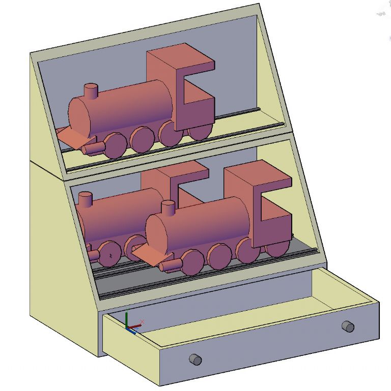

      I am coming to the completion of my 2 1/2" gauge loco. What I need now is a carry box for it and its tender.
      I wonder if their is a good place for designs for this type of box. I can work from a photo

          There was an article or two in ME a few years back, I'v tried looking in the index, but could not find it. With a bit of thought, it should not be too hard, you need to know the size of the loco, and the size of the vehicle you are going to use. The loco needs to be positively fixed in the box, and the box must be fixed in place in the vehicle, so that nothing moves if there is a sudden stop. Ian S C

            I Have the general shape and size in my mind, its just the Ironwork that I am a bit worried about.
            I don't want to pin 4sides together and the bottom falls out, but on the other hand, I want to pick it up so I don't want overkill..

                    SInce 2&1/2 is relatively light you can take a differnet approach compared to a larger scale.
                    One posibility is to make a box where it is one side that opens by sliding a panel up and out. You then slide the loco towards you and out. The point of this is that you can replace the sliding side with a sheet of clear plastic turning it into a display box.
                    Next version is a 'nice' base plate including ballasted track over which the whole top box assembly fits. When used at the track it can be placed on the trackm the top unclipped, and the loco rolled forward down a little ramp.

                        I would be tempted to make handles from nylon webbing that continue right under the box.

                                Below is a plywood carry case based on one I saw at an exhibition, There is room for two engines or carriages side by side when it is closed for transport. They sit on rails built into the case. Or if it is being used as a display case one can be shifted to the top. There is also a drawer. I guess you can make the case as long as you are able to lift it. It is probably an old idea but it worked well.
                                You would need to make restraining packers and or hold down straps to hold them in position for transport.It would need handles and catches on the sides and a piano hinge for the top. A handle on top would need to be recessed or it would get in the way when the case is open.
                                I guess you have noticed I am not a train builder!…. I do not have an accurate 3d image of a real engine so just sketched up a kids version. It was fun!
                                Regards

                                  Interesting idea. I think I have seen something similar. Your drawing gives me some ideas.
                                  I think it might be obvious, that im a reluctant woodworker and this angled approach might be one step beyond. I like the side being removable for show. I don't want to put my loco in a box and forget it, its taken ages to build and im proud of it.

                                      I would also think about ventilation. You don't want to put a warm engine into a closed box and hope that condensation doesn't spoil it.

                                        all my locos are in a standard type of carrying box known as the 'Bert Brock' standard, very popular in the SMEE. the loco is attached via threaded coupling to a wooden base over the drawhooks or dummy drawbar fixed to the base, and tender likewise on another base. a hollow box of hardboard secured together with plastic angle and pop rivets fits on top . the base has steel brackets for handles attached to the upper hard board box. if i get a chance i'll take some pics.
