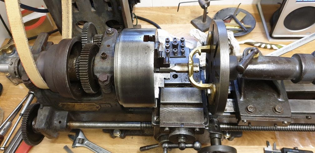

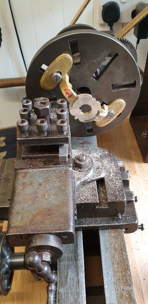

                                                Thank you for the encouragement Howard, yes my ML1 has the lower centre height and 7/8" nose thread.
                                                Having skimmed a bit of brass yesterday I took the plunge and put it to work today, faced off the cast brass bracket in the photo and then bored the centre out to the new size and correctly centred, well better than it was. Then in a case of extreme tapping I cut the 3/4" thread. Really only did it this way as the tap is too big for my 1/2" chuck, but it all went well. Took me hours of course but I had fun doing it.
                                                Last night I was reading a forum thread about gip strips, people having bought Seig mills and replacing the steel strip with brass. I wonder if it might be worth it for my lathe?
                                                Does anyone sell steel shim in narrow strips? I made a few up from brass then dropped one in between the bed ways, thought if I'd used steel a magnet would have got it out, for now its a feature! (-:
                                                Cheers
