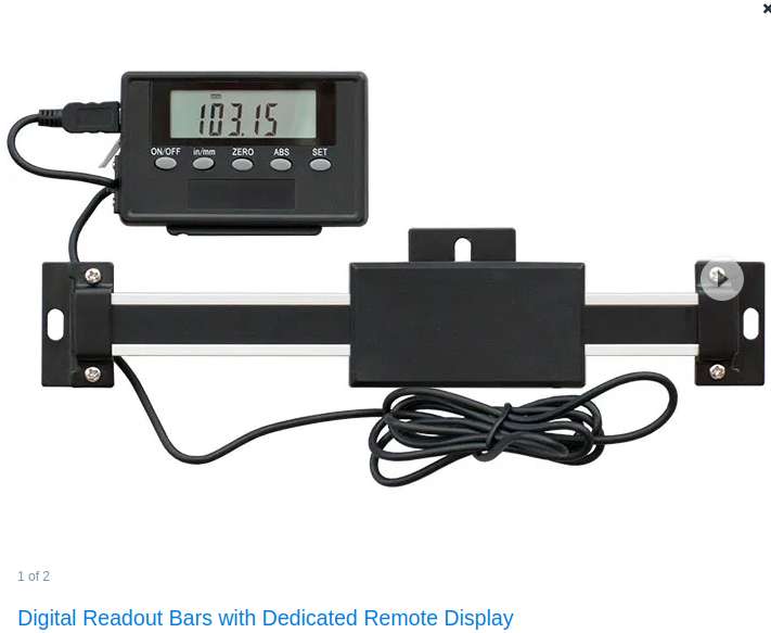

                  #783844
                    Fitting a mill with DRO is almost a no brainer – apart from the cost!   So consider adding one later, or starting cheap.
                    Mills can be driven on the dials, it just means the operator has to concentrate, and make use of marking out blue, stops, and anything else he can think of to reduce mistakes.   A DRO is a huge boon rather than essential.
                    My mill came without a DRO, which were more expensive back then.  However, dials being slow and my concentration poor, I soon upgraded to this simple type, mine came from Arc Euro, still selling them I see at knock-down prices today.
                    arcdro
                    Knowing them to be minimalist and not very robust, I only expected them to carry me over until I could afford better in a year or so.   A decade later they’re still going strong!
                    If money is short, think carefully about tooling.   It adds significantly to the bill.   Cutters, mill and drill chucks, clamps, vice, rotary table, edge finders, boring head, angle gauges,  set squares, DTI, tool lamp,  etc etc etc.   Save money by thinking about the work you intend doing, and then buy tools as needed over time.   Spreads the load rather than saving money.    The one thing that turned out to be a complete waste of my money was flood cooling.   Messy and only worth it when I hack into lots of steel, which I rarely do.   You might!
