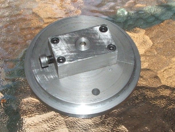

              Knock up one of these. In use the bottom block is gripped in the mill vice and an end mill lowered into the slot – the workpiece is located on the pin and rotated by hand against the mill, with light cuts. DO ensure you are not climb milling tho!
              I should be using mine tomorrow – I see if I can remember some action shots.
