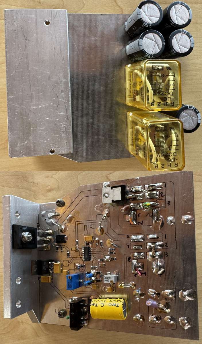

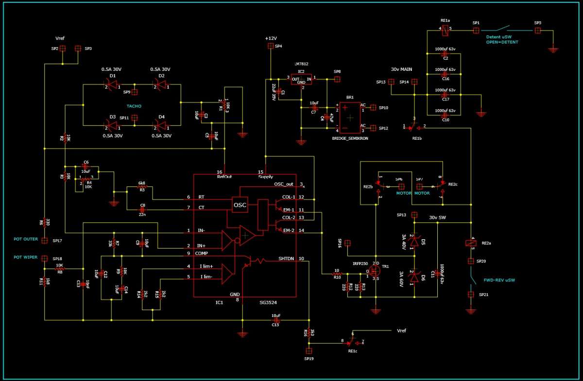

      About 8 years ago I made up a discrete, analogue based PWM controller for a DC motor I fitted to the Z axis of my Mill. Based on a LM3524 Power Supply PWM controller, its output was single ended which meant the motor wires sat between power supply +ve and the collector of the PWm switching transistor. This meant that for the motor to reverse, the wires had to be swapped. So it ended up an electromechanical solution – cams, microswitches, relays, etc…It worked well, although I did replace one microswitch in those 8 years.
      The drive uses another small DC motor as a TachoGen for clean smooth low speed control with lots of torque.
      This was the circuit:
      3524_Controller
      And the Old PCB’s with relays..

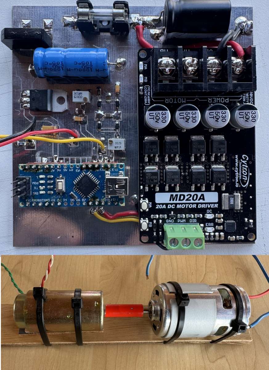

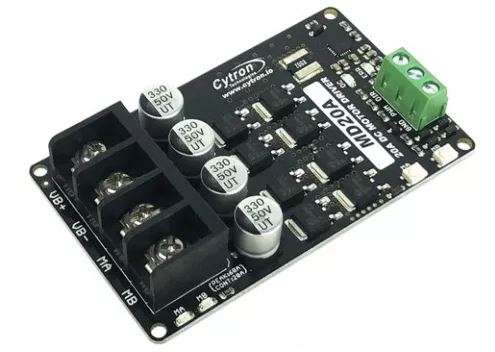

      I found a neat PWM full bridge ( no motor wire reverse relays needed..) driver – PWM and direction control inputs.
      MD20A
      Locally it cost R400.00 – about 17 pounds.

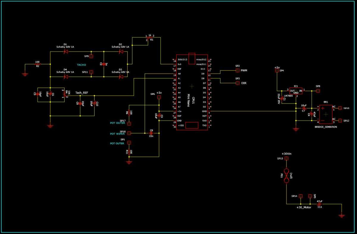

      I made up a little board carrying the MD20, and Ardunio Nano, diode bride for the TachoGen so its wires don’t have to be reversed, 5volts regulator and a few pots…
      Here’s the circuit: ( the MD20 is not shown – it gets Motor Power and drives the motor. Also PWM and DIR from the Nano.
      Arduino_PWM
      And the PCB Carrier:
      Drive_Motor
      The two motors shaft coupled above were a test motor and tachogen to get it working on the bench.

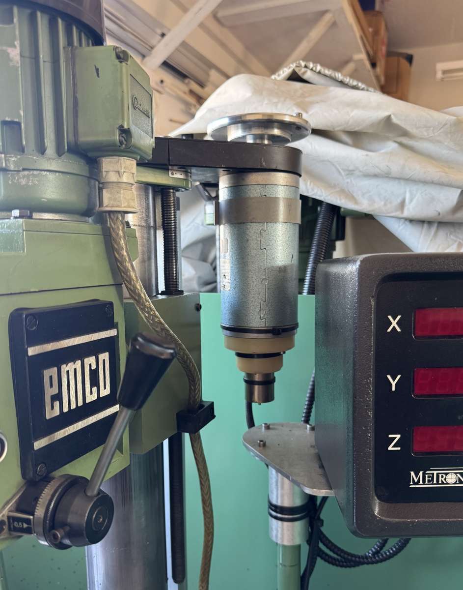

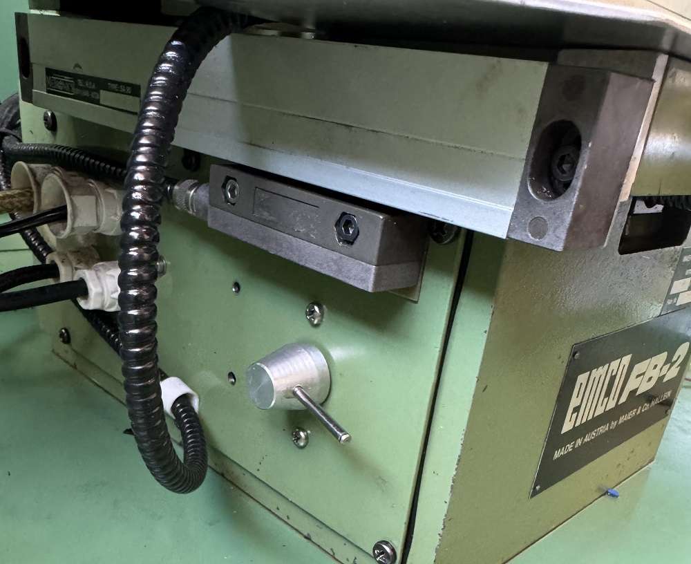

      This shows the ‘control’ lever – fitted to the centered pot, which it spring loaded with a zero detent – ball and spring..
      Up_Down lever
      The Z drive motor with the Tacho Gen slung underneath:
      Zmotor1
