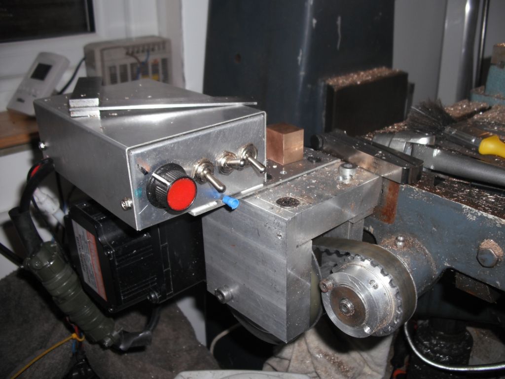

              Have a look at Myfordboys website for fitting stepper motors to your mill, not using arduino for control, but works well for feeding fast and slow feeds. Some pics on my albums of the stepper fitted to my mill, no gearing needed.

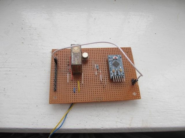

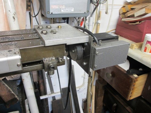

                                  You mean like the one on my Centec 2B. The motor is M60STH88-3008DF from Motion Control Products, it is driven 1:1 by tooth belt. I went 1:1 because to get fast traverse the motor is fairly whizzing round. The advantage of using Arduino is you can program in acceleration so it doesn't have to be such a big motor, and it's less brutal
                                  The Arduino is a mini, if I did it again I'd probably use a Nano, and the end of travel switches are microswitches activated by the round blobs protruding from the bottom of the hard stop blocks. On the bucket list is a plan to interface the DRO to give software end of travel independent of counting motor steps, but it is way down. If anyone wants the code send me a pm
