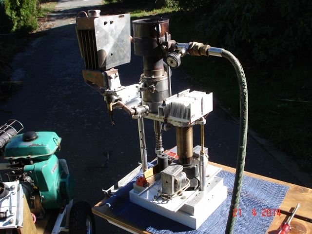

                  dsc00839 (640xjpgI,v got a half made spot welder made from a MW transformer, also a demagnetiser made from one of the coils from a MW transformer. I use the magnetron magnets in a linear alternator on a free piston Stirling Engine. The case is a good source of sheet metal. The primary, and secondary coils, either will do, run them from a reasonable size transformer at about 12 volts, the demagnetiser is the wooden box with the rectangular hole. Ian S Cdsc00683 (640x480).jpg
                  Edited By Ian S C on 29/03/2015 10:35:13
